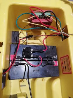

    Hello everyone,
    My first post so deep bows!
    I wanted to ask for help, because in electrical matters I am a "festivity" :) .

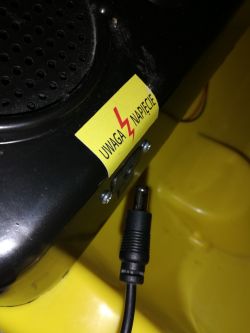

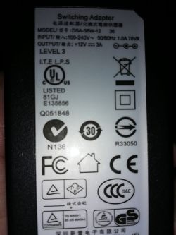

    As in the subject, I need advice on charging batteries in a 2x6V 10A powered car. The original charger is missing, so the question is, can I charge them differently? I enclose photos of a battery compartment, charging sockets and two devices that I found at home for charging (power supply and charger). The adapter plug even fits into the socket. Maybe they can be charged with them?
    I thank you in advance on behalf of my child! :)

    I recommend charging the battery with the charger below because it has several advantages, namely it can be used to charge motorcycle batteries and then charging is at a lower current and after charging the charger automatically switches to charging with a small conservation current.

    This charger should do the trick. Just check the instructions with what current he charges, and then check the batteries with the maximum current written.
    If the current is not too high, connect this charger to the batteries (disconnect the cables from the installation and connect to them, leave the jumper).
    You can also charge separately (without a jumper), this rectifier can be seen that it has a 6V control, which means that it can also be used in this way.

    I understand that I have to connect the red rectifier cable to + in one battery, the black rectifier cable to - in the other, while leaving a jumper between + and both batteries - which can be seen in the first photo?

    I connected both 1 battery and 2 with a jumper, but unfortunately the charger blinks with all LEDs, which means:
    Charging Alternatives for 2x6V 10A Batteries in a Child's Toy Car: Your Experiences?
    I think, however, that I'm going to buy new batteries ... Maybe a little bigger right away? Must be 2 or maybe one 12V?

    So they were over-discharged. To be sure, you can still check the voltage with a multimeter. If it is clearly lower than 6V (per battery) then the batteries are useless.
    You can also try to charge one at a time, there is a chance (although rather small) that one is still to be saved.
