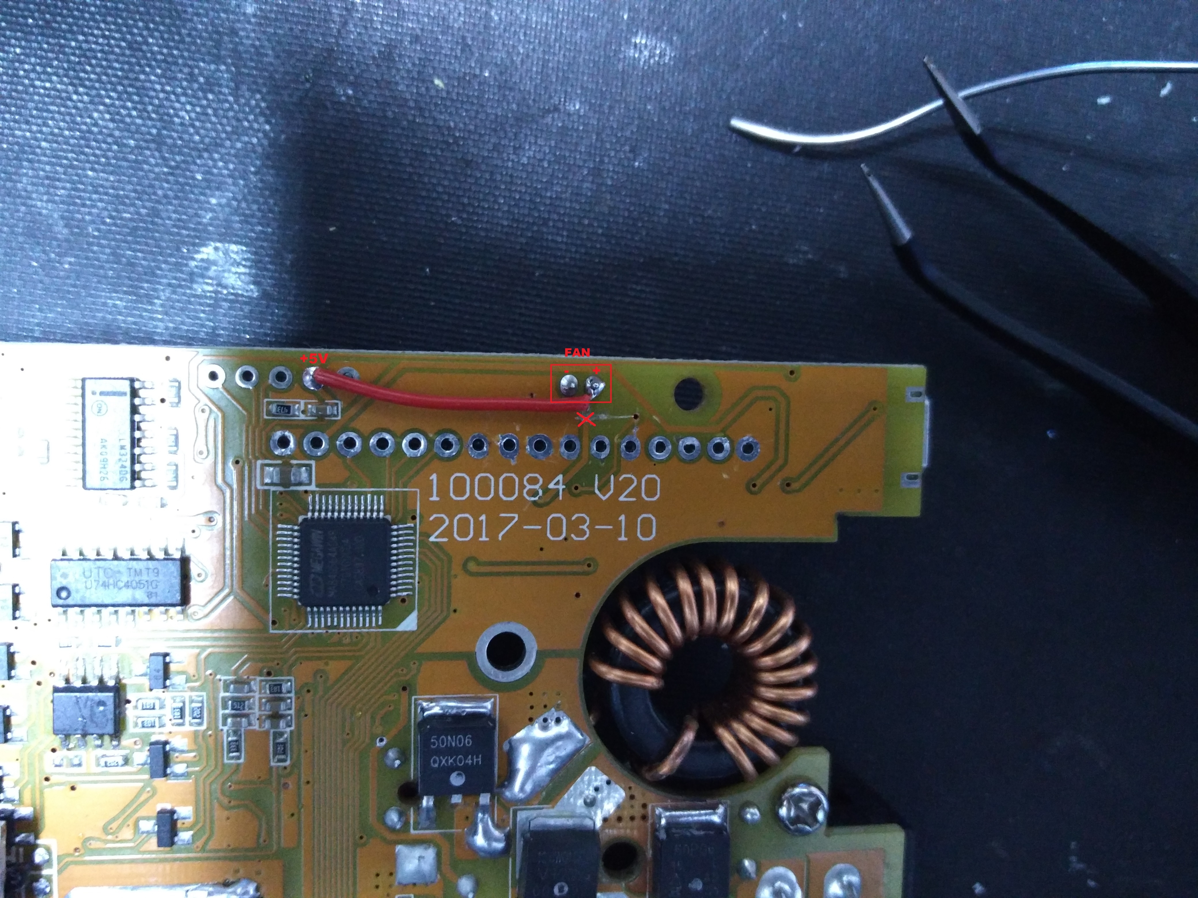

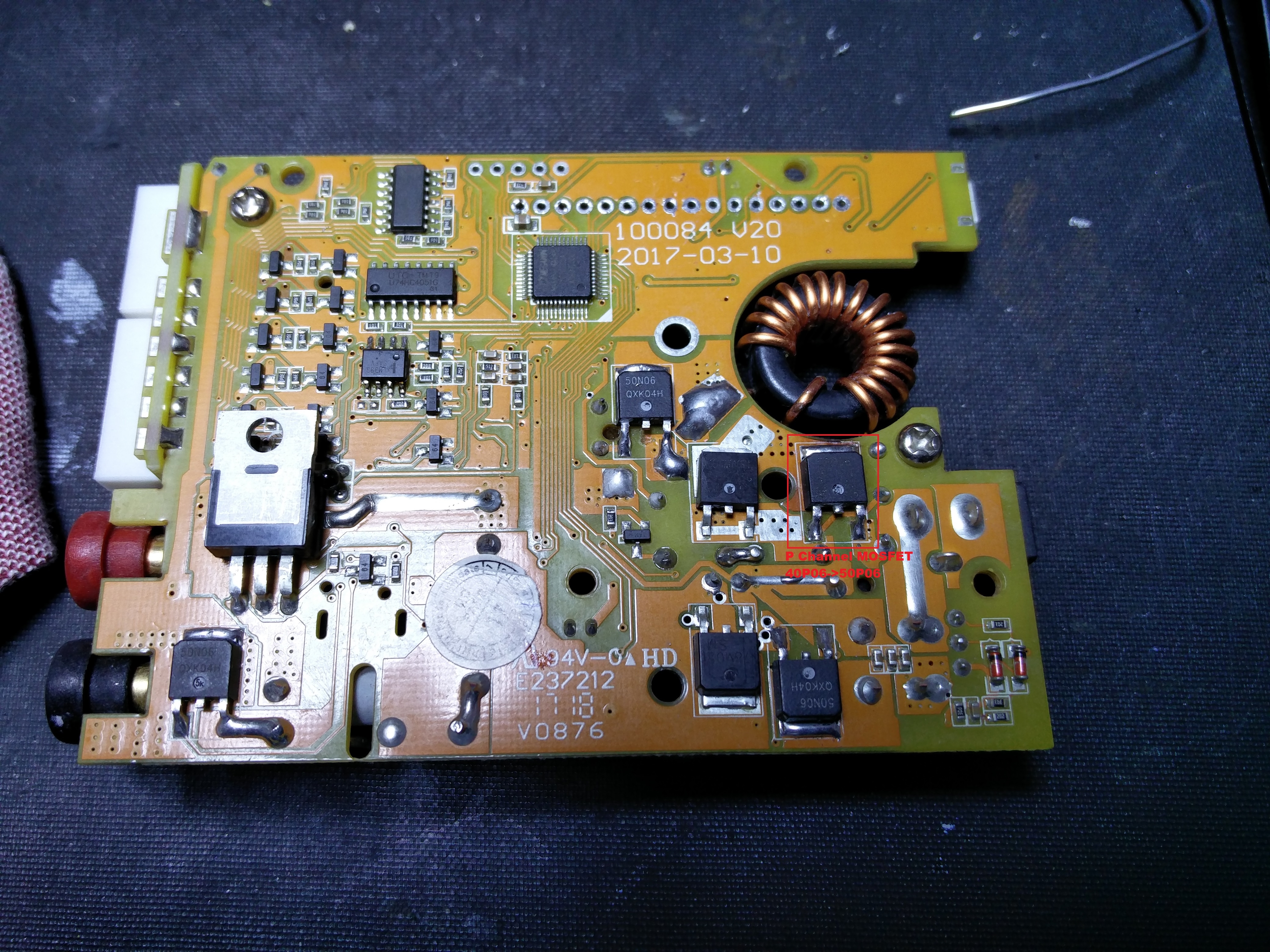

    I have a genuine Imax B6 and after some use and I don't know when, it blows 40p06 mosfet and I confirmed that after the charger blows some of my batteries because input supply voltage was always at the output pins when I start charging any mode. After that I disassembled imax and saw that mosfet is shorted. I replaced it with a 50p06 and the problem is the same. Only if I take it off, it looks like the imax is working fine. Could someone tell for what is that 40p06 mosfet and why I still have the problem after replace the bad part? regards!

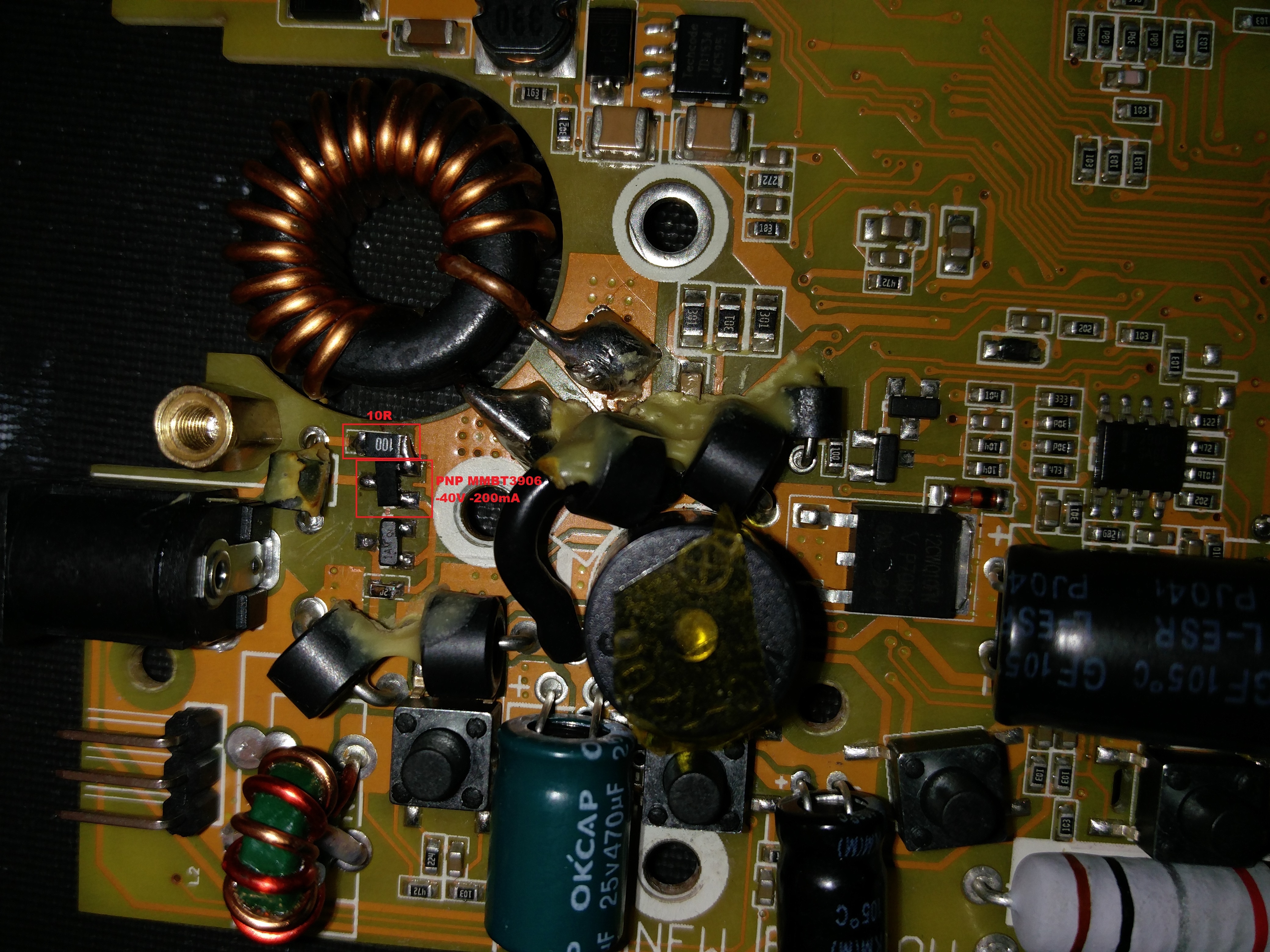

    Hi again.
    I'm here again to tell the solution for my problem that I finally found. Besides the shorted P Mosfet, it was also a 10R resistor and PNP sot32 transistor shorted and after that my IMAX B6 is working again!

    In the photos you can also see a bonus :) to change FAN voltage to 5V. Mine was bad and 15V fan I can't find anywhere. Now with 5V supply to FAN you can use many FAN'S
