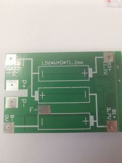

    Hello, I have a 3s2P cell package and I have a question if it can be loaded with this module. In the seller's drawing, the 3s1P package is drawn, whether it will load properly when the links are connected in parallel. Is this module enough to charge such a package and protect it against discharging and overcharging, should you connect something else?

    The system is used to protect the packet from overcharging and discharging. Additionally, it contains a balancer that balances the voltage in the packets during charging.

    No. This has two functions. Balancer - spreads the load equally on the links. And the OVP UVP OCP fuse. Nothing more. There is no charging logic, no temperature measurement, no charge time analysis, no current ramp.

    sellers call these tiles: a safety system with a balancing function.
    In my opinion, you can use your plate only as a protection system type "hardware secondary protection" but even this function is not quite sure.
    First of all - security.
    Vendors delightfully give detection voltages OVC = 4.25 - 4.35 V and OVD = 2.3 - 3.0 V. This is some mindless tracing of the first page catalog data of the voltage detection system, actually these voltages are from a certain range, but the end user has no possibility of adjusting them . The systems are manufactured in a number of versions that have different combinations of these voltages pre-set. You should read the markings of the detection systems on your board and check in the catalog data whether by accident the current combination of detection voltages does not match your links like the ox to the carriage.
    Second - balancing.
    From the available here and there descriptions of this board, "balancing" uses hardware 4.2 V detectors, which short-circuit the cells with 100 ? resistors, giving a dizzying 42 mA balancing current, i.e. "balancing" is formally but it is not there. Such a balancing current is great for "low power" systems, but the 25 A current limit suggests that this is probably not the case.
    You should therefore buy some decent charger with reliable balancing.

    Hmm ... So I could connect the BMS itself to the links as a protection of these cells against excessive discharging during the operation of the loudspeaker, and connect a charger such as imax for charging? Additional balancer's duplication is unnecessary because the charger has it in itself, and the balancer is only needed for charging? I connect the charger in parallel with the BMS in the loudspeaker?

    The balancer is only needed when charging. You can connect a BMS that will not have a balancer in it. It will simplify the layout.

    Do not Output only B + and B- with those round sockets on the left on Imax. These are the current terminals - that's how it charges the battery. This small plug only measures if everything goes well and even.

    The two plates HX-3S-01 found by you are only I'm afraid, however, that it may have a slightly too low OVD detection threshold, I think you should use a system (or systems) to signal the state in which the voltage any link is lower than (say) 3 V.
    Unfortunately, you probably are not right. From available here in the network (although slightly obscure) diagrams show that connecting to B + and B- you will connect the charger to the "bare" battery, bypassing the cut-off transistors and current resistor, ie the protection will not work, please connect to P + and P - anyway, having a physical tile you can see how connections are going.
    So from another keg, do not abuse the abbreviation BMS, it is usually a "Battery Management System" - a fairly extensive and complex system of very advanced "dominion" over the battery.

    Please tell me what this contact described as "F-" is for?
