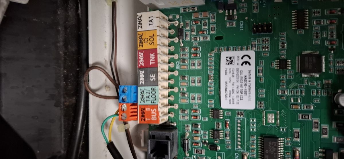

    Hello everybody.
    I have the same problem with my gas oven Ariston Genus one 24. Now I have connected non-wifi Ariston Cube RT thermostat.
    I bought some wifi-enabled thermostat, for weekly configuration, on/off thermostat.
    I had today at home an expert to connect the thermostat, but he was not successful.
    If I understand correctly, the thermostat needs to be plugged into the TA1 plug and the terminal (the wire that connects the two screws) needs to be plugged into TA2? Like in the picture in post #4, only to connect the short wire in the blue connector?
    Now is like this in my picture.
    Image of the interior of an electronic device with visible connectors and wires.
    Please help. Thank you.
  • #26 21623719
    GZ50
    Posts: 117
    Help: 6
    Rate: 35
    Sensys HD system controller and wifi
    switched on via BUS
