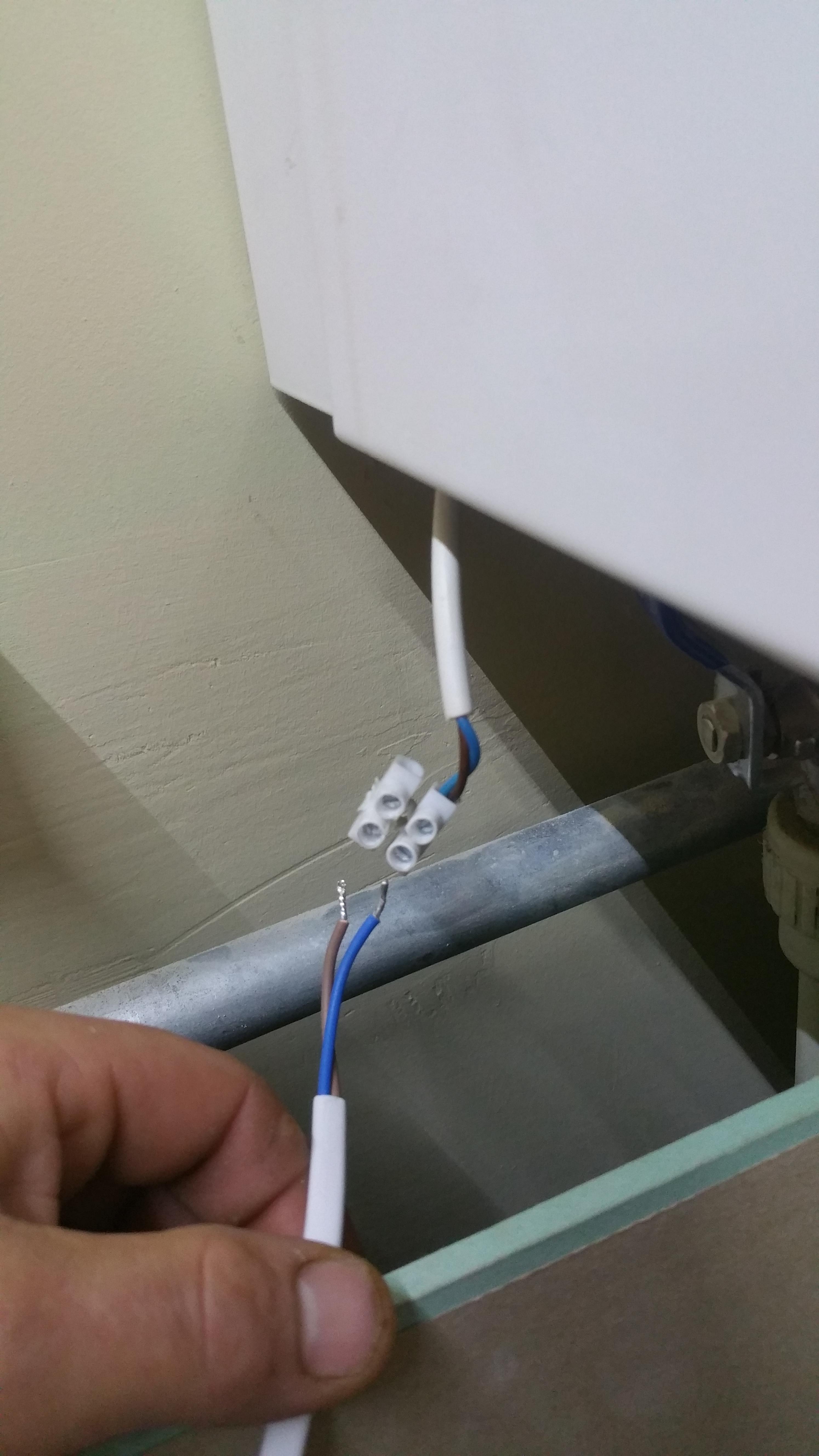

    Hello I have a question.
    I have a Termet Termaster turbo boiler. It hangs and works like that for a few years, but now you wanted the driver. So I bought a Salus controller, wireless. And so from the boiler there are two brown and blue wires, which are assembled in the cube, and the controller has a com and no. Well, I plug in without voltage, the drivers can see each other, I have a beautiful icon that heats up, turns, but the stove does not start or heat the water or CO. Can someone please help me with this. A seemingly trivial matter. I will add that the controller can be connected with voltage, but I do not know if it will not end up replacing the board in the boiler.

    Buddy, have you activated the external control functions in the oven?

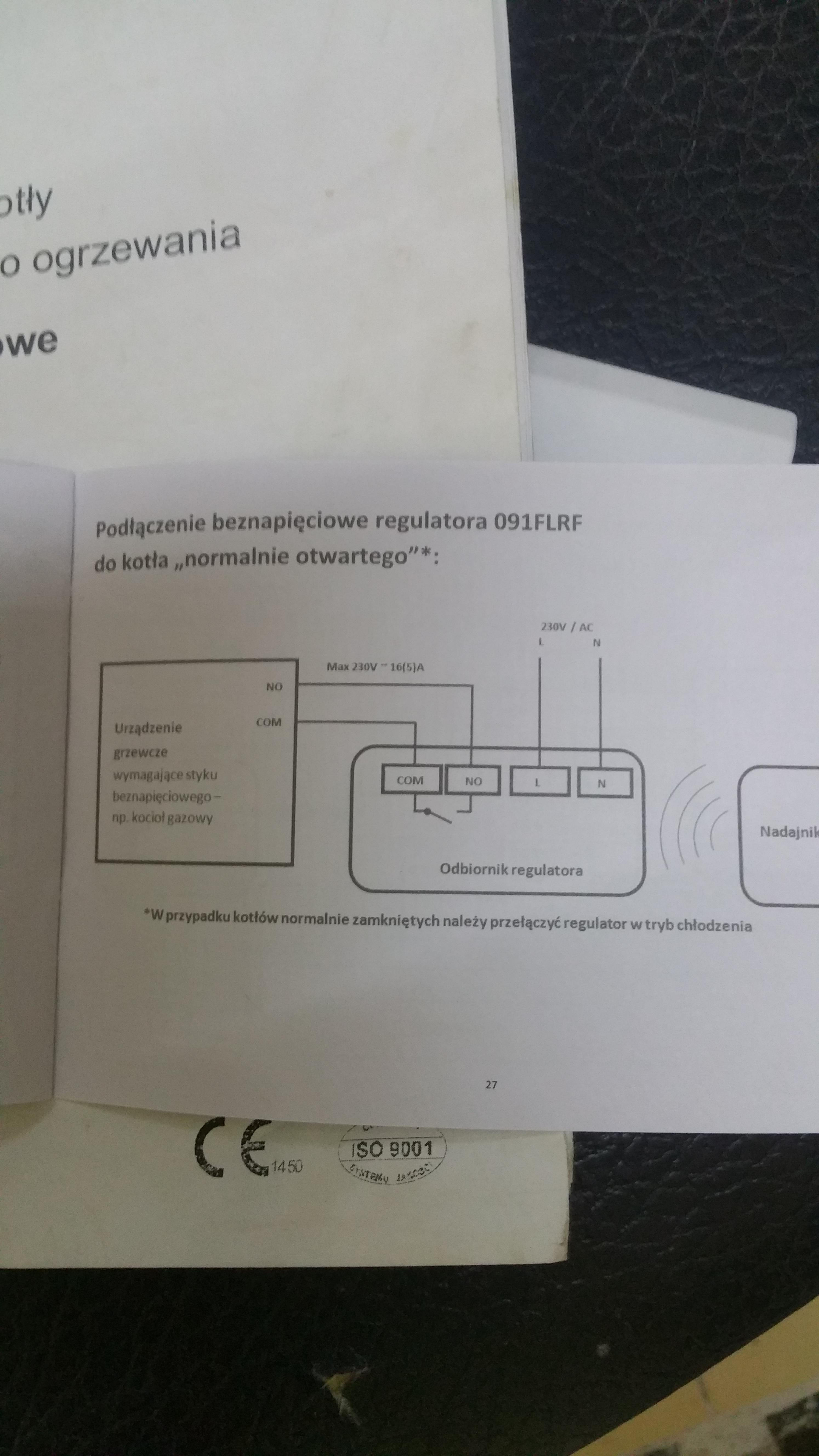

    And you connected the salus controller with 2 diodes to 230v? Because the description shows that it is not. Orange LED - connected to the network. Yellow - heating signal.
    You connect to the boiler where the bridge was.

    Yes, I connected the controller to 230. The green LED is on, indicating that there is a signal. According to the instructions, the boiler should be turned off. This is a model with knobs. I connected it as in the diagram in the attachment.

    Both knobs more clockwise. To tidy up the wires on the ankle. No voltage may be applied to the boiler control input.

    Now the regulator is disconnected because it is not working. The DHW knob is max clockwise. A piece of wire with a cube is how it came out of the factory. Two wires assembled. When I connect the regulator, it is blue with blue, brown with brown. And the knobs on off. The transmitter and the receiver can see each other, the diode lights up as if it is working and the boiler does not give any reaction. Adds pics as it is connected.

    Left knob in the center of the heater scale. Now you have CO off. You do not read and do not do what your friend wrote earlier ... call someone because I see it will end badly ...

    Change the communication code and don't float. We try to help as much as we got the information ... Before connecting the regulator, there should be a so-called Bridge. If it wasn't, it means that you connected to the wrong cables :D

    I'm not floating, I'm just looking for a hint. There was a bridge, i.e. two wires connected in an ankle. As in the first photos. It is possible that something else needs to be changed in the boiler.

    I know this boiler. Nothing sets. Change the communication port in the salus driver - both.
    Ev. Take a multimeter and check if a short-circuit signal comes out to the boiler contacts as the circle on the controller with the display turns.
