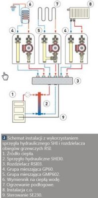

    Now it has occurred to me that a well-done mixed system must rather have a hydraulic clutch. The figure below shows such an arrangement. In addition, the usual on / off thermostat for radiators, including the stove and pump, and some smarter thermostat for the floor, doing the same (both rather in a northern room). The systems can heat together and separately. My system only heats up together, so I have to harmonize it well so that I can heat up the radiator top and the floor bottom at the same time.
    Control / setting of underfloor heating and radiators (mixed).
    source
