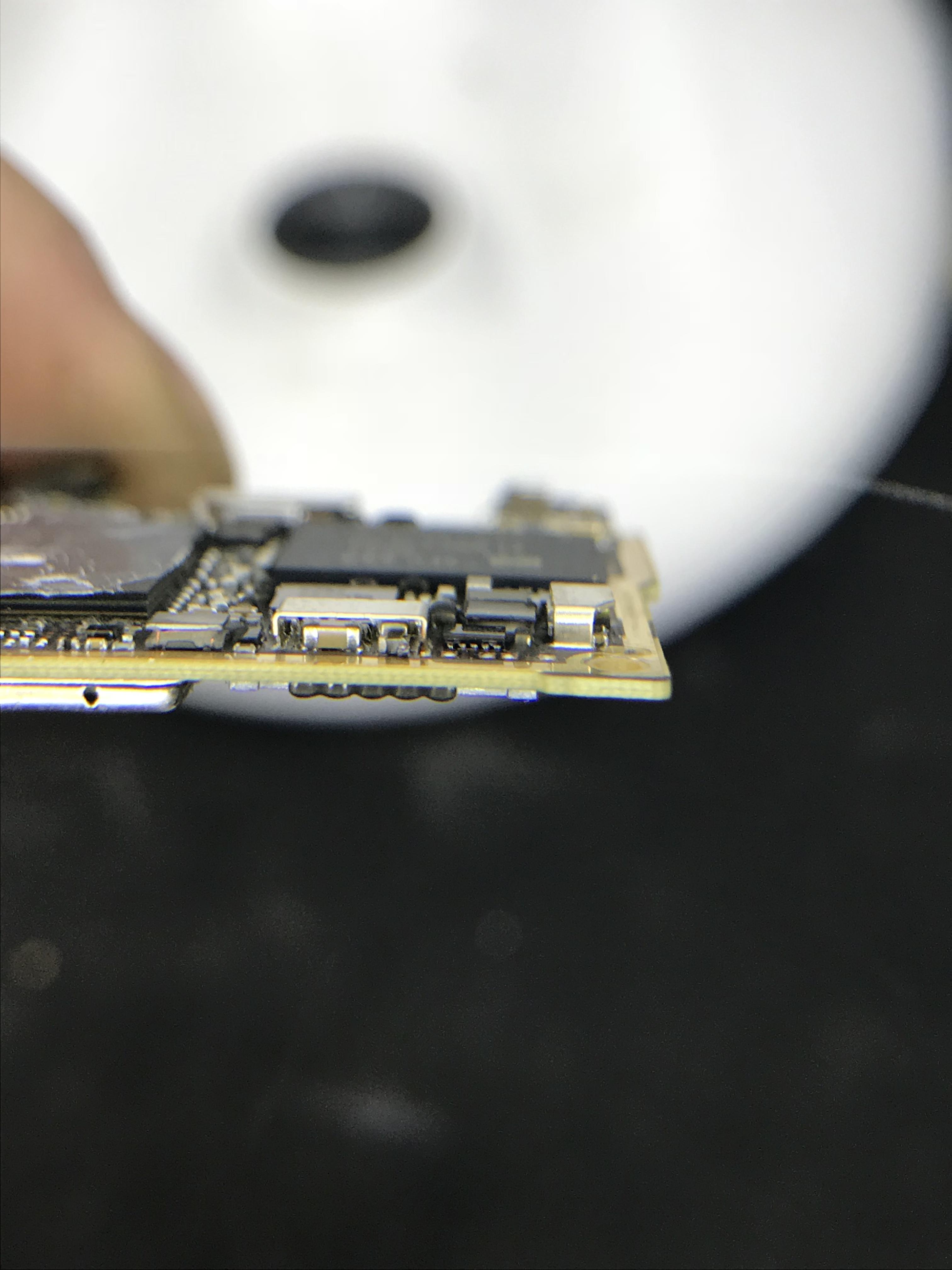

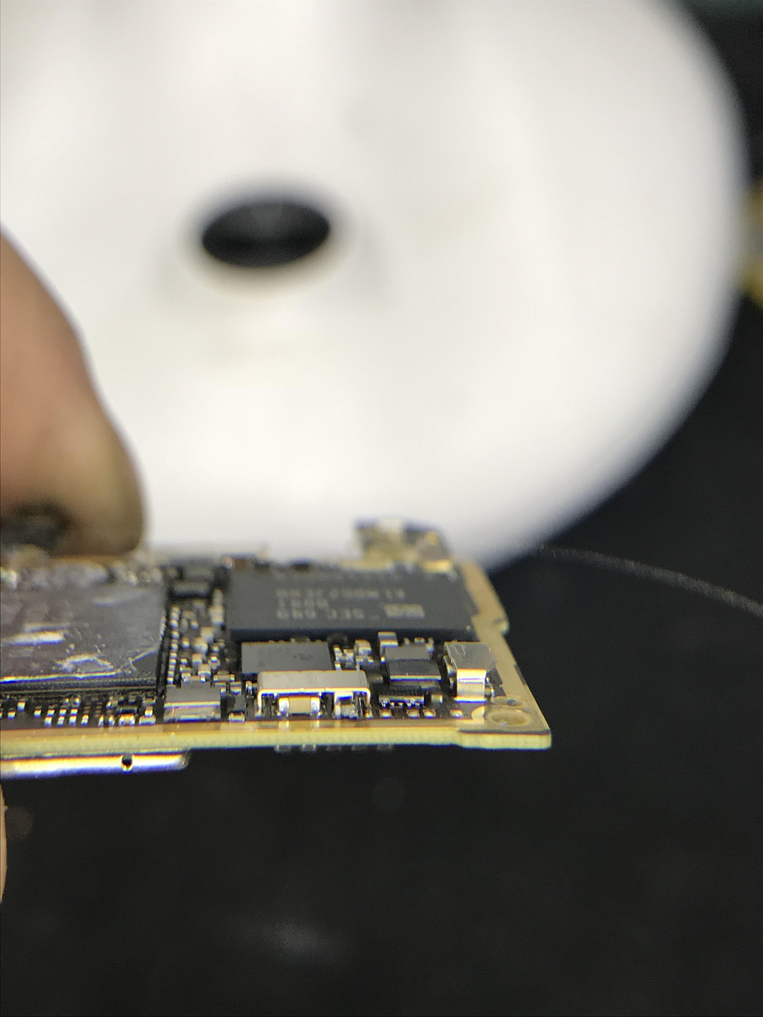

  • #8 17000312
    szabranit
    Posts: 52
    Rate: 9
    Hello, please check if you also have a burned out contestant, as it seems to me, under this badge on the right

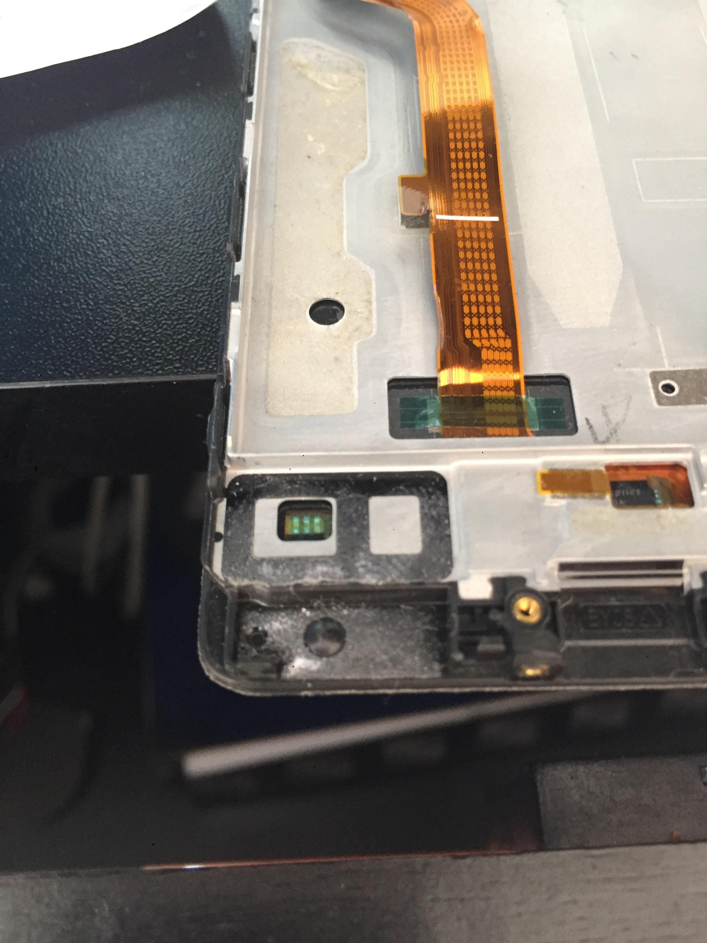

  • #11 17192512
    bydlak
    Level 21  
    Posts: 375
    Help: 52
    Rate: 36
    The problem lies in the lack of tape on the soldered joint on the left in the photo from the LCD backlight. You need to stick a piece of ribbon that is not included in the substitutes.
    Usually, after firing with no tape, the coil under the screen on the board burns due to a short circuit. After replacement it is OK
