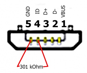

  • #14 16469517
    FIsiu_
    Level 28  
    Posts: 1139
    Help: 128
    Rate: 295
    You can enter the tablet in Download Mode, you just need to make cables:
    Samsung Galaxy TAB 3 GT P5200: Unable to Access BIOS for System Reset or Installation
    Turn off the tablet, connect the microusb plug with the resistor and the Download mode should automatically appear.

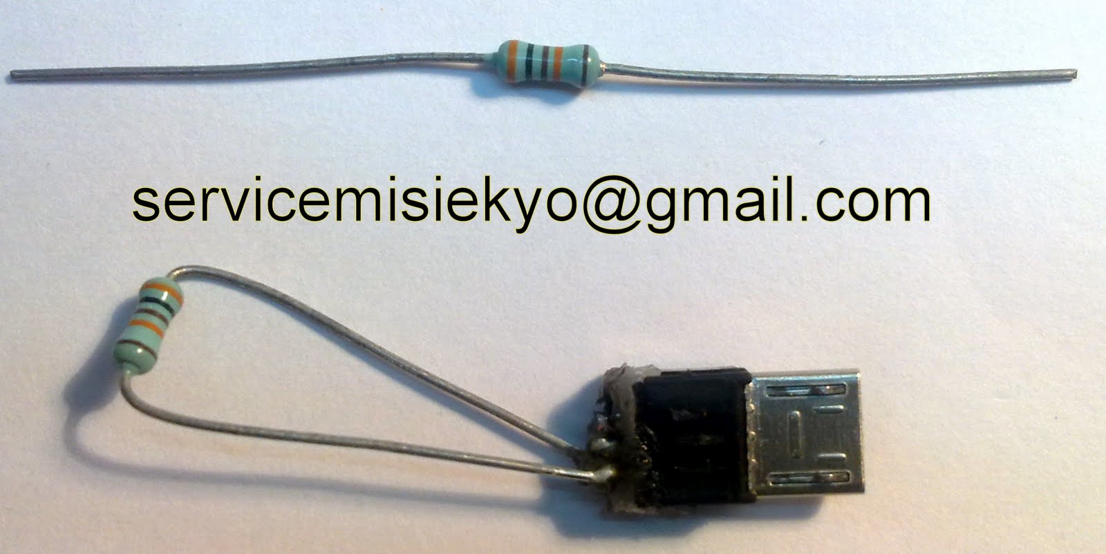

  • #15 16469816
    gwozdek19
    Level 4  
    Posts: 111
    Rate: 20
    And what would the microusb plug with the resistor look like?
  • #16 16469832
    lukasrsv
    Level 20  
    Posts: 591
    Help: 41
    Rate: 165
    It is the most common micro USB plug (eg from an old USB cable or bought in an electronics store) with a soldered resistor to the appropriate pins.
  • #17 16469867
    gwozdek19
    Level 4  
    Posts: 111
    Rate: 20
    And how should such a resistor look like?
  • #18 16470020
    lukasrsv
    Level 20  
    Posts: 591
    Help: 41
    Rate: 165
    Exactly.
