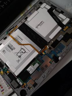

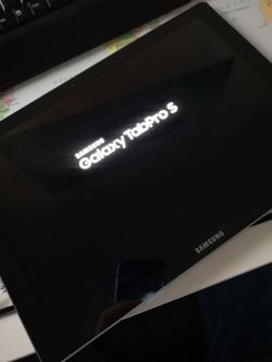

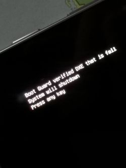

    After turning on the Samsung Galaxy TabPro S, the logo appears and immediately the message:
    "Boot Guard verified DXE that is fail. System will shutdown. Press any key."
    Pressing the button turns it off and back on again. Yes, over and over again. I opened it from the back because I thought it would be possible to do something like "reset", but unfortunately I can't see anything.
    Does anyone have an idea what I can do?
    Regards and thank you in advance for any answer.

    If you survive the loss of all data, restore it to factory settings: https://www.youtube.com/watch?v=sQZ9b3JCLNg
    Unfortunately this doesn't work for me. The above message appears immediately after the logo. Pressing "F4" does nothing.

    hold f2 and press power it will show you bios restore settings and you should be fine

    Also not working. No response to the button. Not that the keyboard doesn't work, because everything is fine.
    I kind of read somewhere that it could be the motherboard, but I've had this message before. Then all it took was to turn it back on and everything worked. Now I can turn it on 100 times and it's always the same.

    Does it happen "by itself" or did you do any Update (e.g. Bios/or clear Bios )?
    * and power cut off
    :idea: this kind of message .. rather ended up replacing the board.?!
    * Bios recovery (on Dual-Bios boards it's easy)

    I didn't do anything. Unless there were some system updates, but I don't remember anymore. However, it still does it automatically.
    So will it be replaceable?

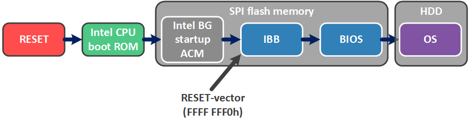

    Problem dotyczy tzw. Intel BIOS Guard (PFAT). czy zabezpieczenia UEFI Bios prze "ingerencją " w nieodpowiedni zapis w rejestry.
    Od 2012. w SoC-ach na bazie Bay Trail zrealizowano pierwszą wer. Secure Boot (Verified Boot), .. pożniej (2013 ulepszono i pod nazwą Intel Boot Guard wypuszczono dla płyt desktopowych pod cpu Haswell.
    Samsung Galaxy TabPro S Boot Guard DXE Failure - Unable to Boot, System Shutdown Loop
    Intel Boot Guard (BG) is a hardware-supported UEFI BIOS authentication verification technology. Judging by its small description in the book [Platform Embedded Security Technology Revealed, Chapter Boot with Integrity, or Not Boot], it works as a trusted boot chain. And the first link in it — boot code (microcode) inside the CPU, which runs on the event RESET (not to be confused with the RESET-vector in the BIOS!). The CPU finds on the SPI flash memory a code module developed and signed by Intel (Intel BG startup ACM), loads it into the cache, verifies (it was already noted above that the CPU has a public key hash, which verifies the ACM signature) and starts...

    Colleagues are talking about reprogramming the bios and I say starting with the power + volumeUp buttons on the tablet, those at the top not on the keyboard there you will have several options, perhaps also updating the bios

    In my case, after replacing the bios from another board, the computer works
