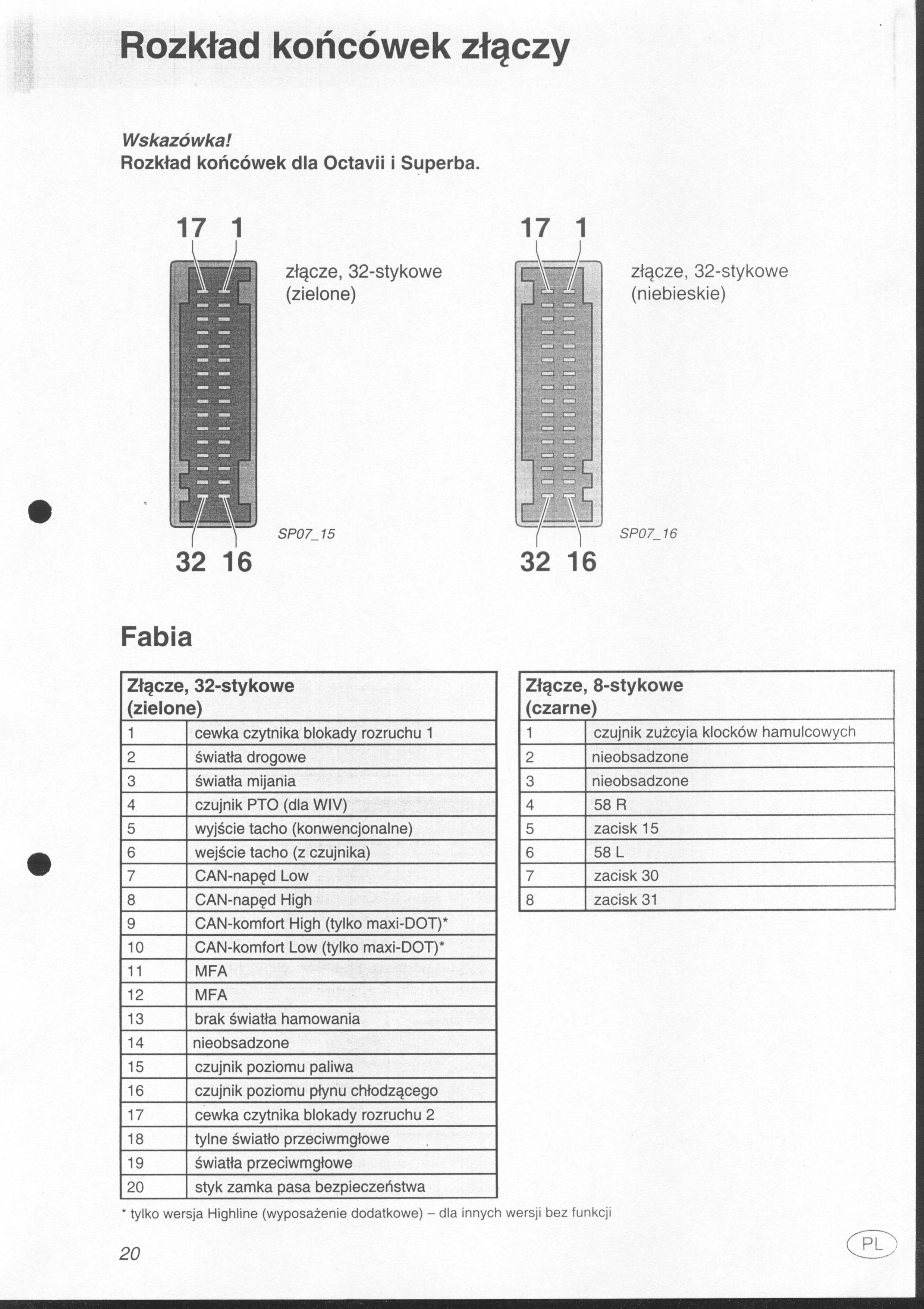

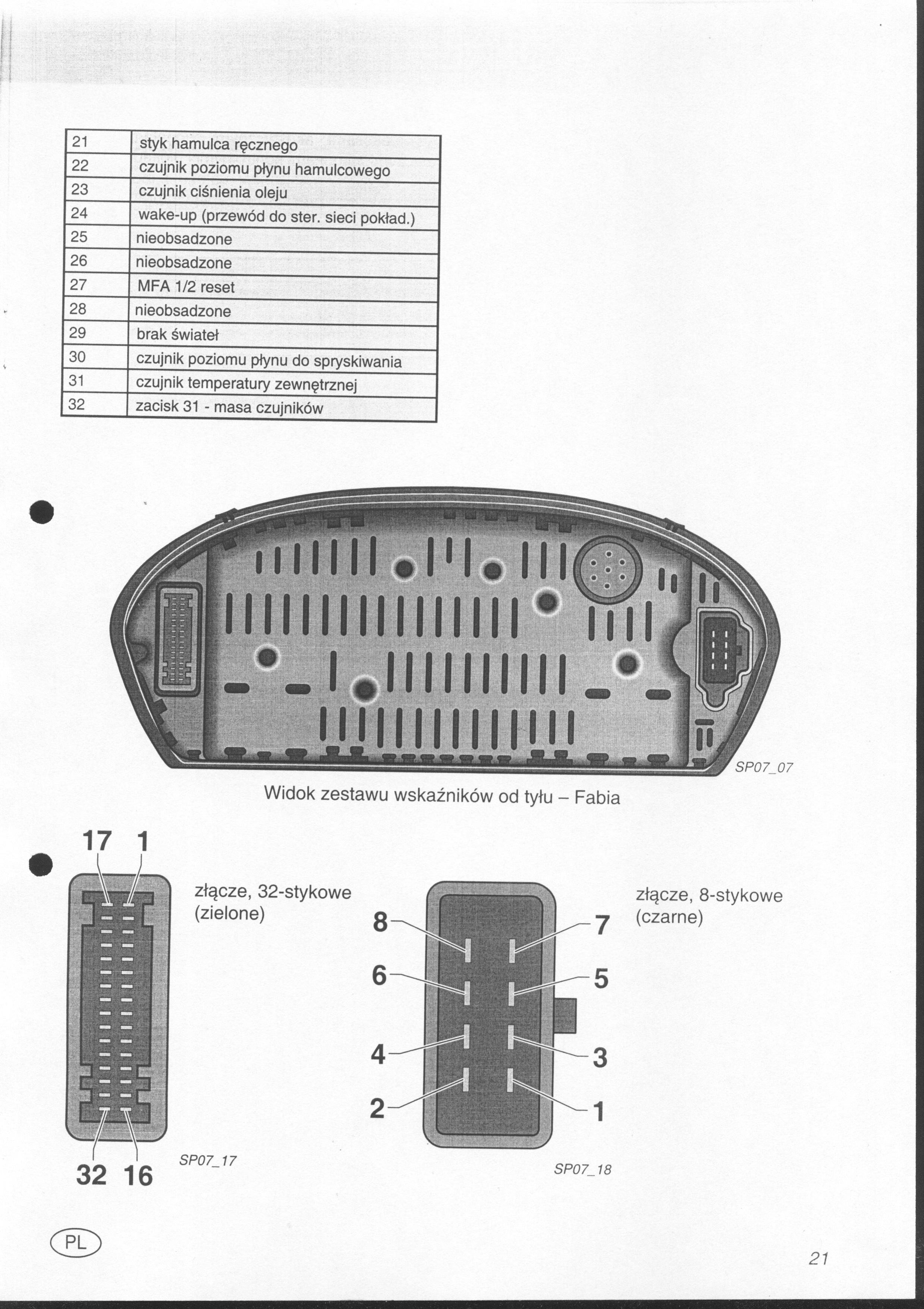

  • #1 16468451
    driwer88
    Hello, I have a problem with the backlight of the Fabi meter from the Skoda Fabi I have the meter on the table connected according to the pinout but there is no pin on the list that would be responsible for the counter starts, that is, you can see the watch and mileage after connecting to contacts 30 and 31 and after connecting the contact 15 or plus the ignition lights up and the pipes start reacting, also the MFA switching and the lights from the long and fog light add that I do not have a car under this counter I do it only for scientific purposes if someone overwhelmed would hit because maybe he could tell me how to hook up a VAG for this counter I have a VAG KKL interface in advance thanks for your help. in the attachment I will add a list of pins that I use
    • Skoda Fabia Meter Backlight Queries: Connecting VAG KKL for Scientific Purposes Wskazniki_012G.jpg (772.93 KB) You must be logged in to download this attachment.
    • Skoda Fabia Meter Backlight Queries: Connecting VAG KKL for Scientific Purposes Wskazniki_013G.jpg (832.35 KB) You must be logged in to download this attachment.

  • #4 16469574
    grala1
    VAG group specialist
    Posts: 9823
    Help: 1495
    Rate: 5052
    Try the black connectors pin 4 and 6, enter the plus there.
    Communication with the meter is via the central electronics module.
    You connect to it through the OBD socket using the K line and this module connects to the meter via CAN.

    grala1
    Posts: 9823
    Help: 1495
    Rate: 5052
    These markings are left and right parking lights.
    From what I remember, it is enough to turn off the car on the indicator and the meter will be illuminated and then on these pins there is power. This is not an output but an input or information for the meter.
