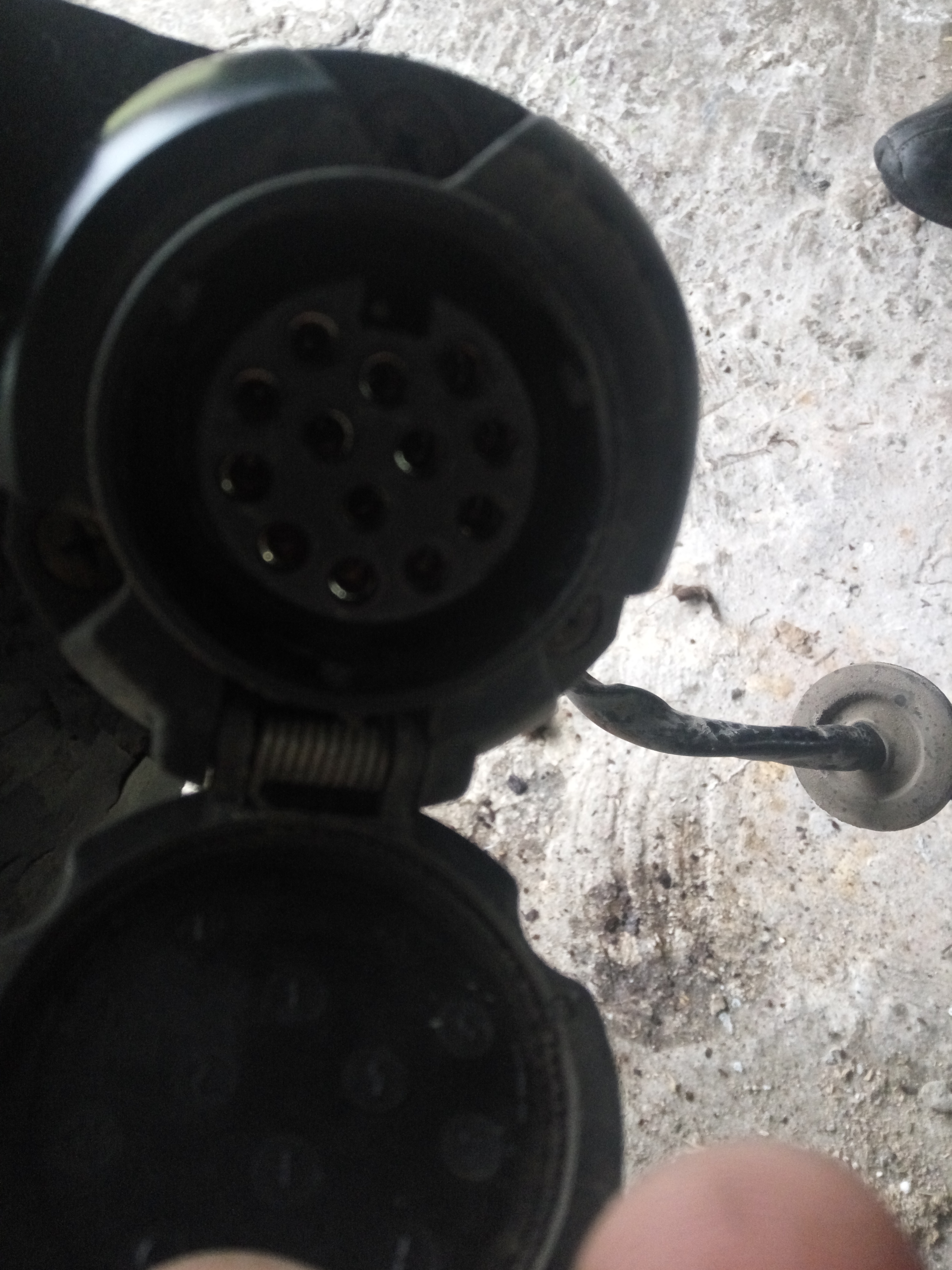

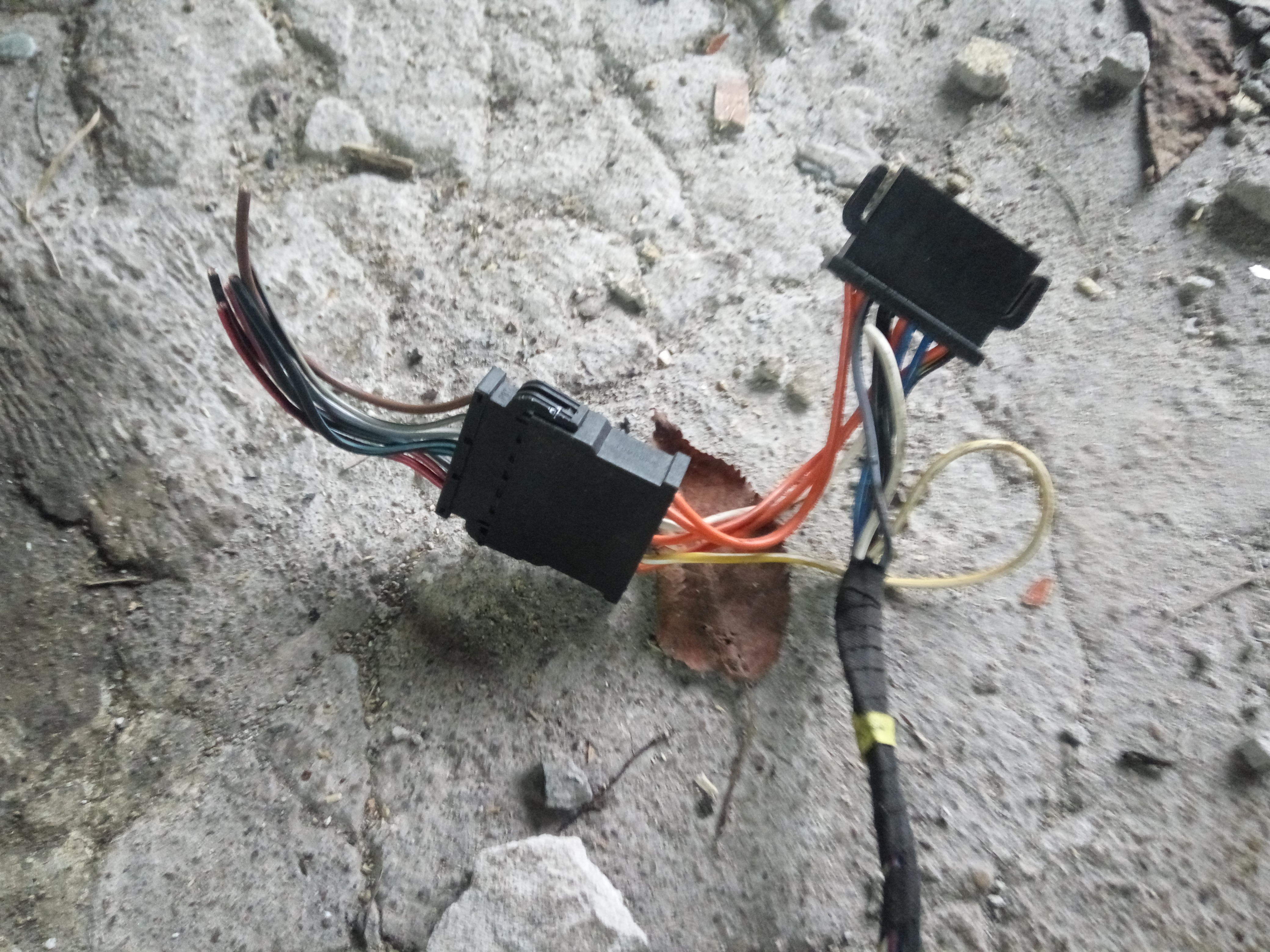

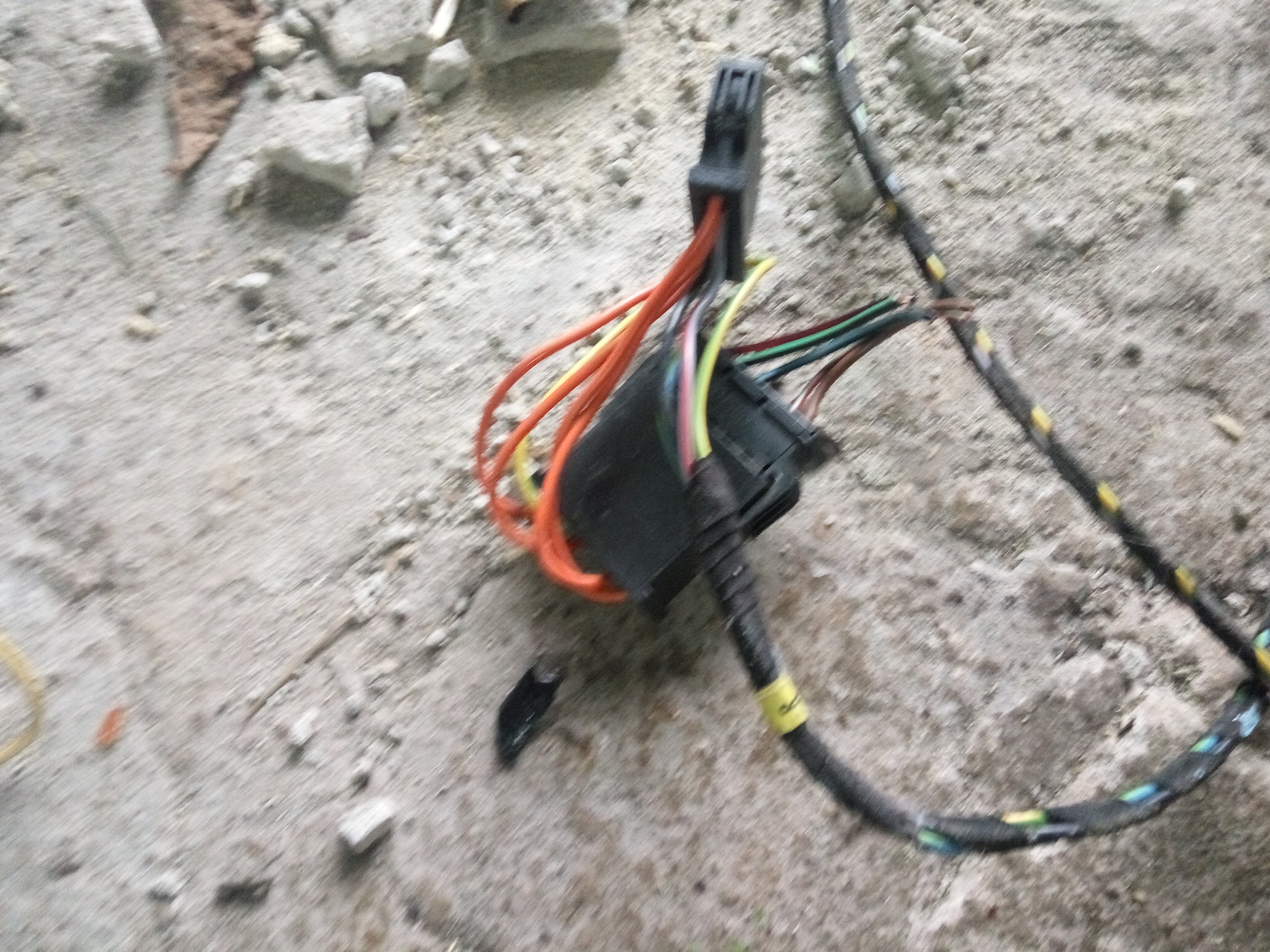

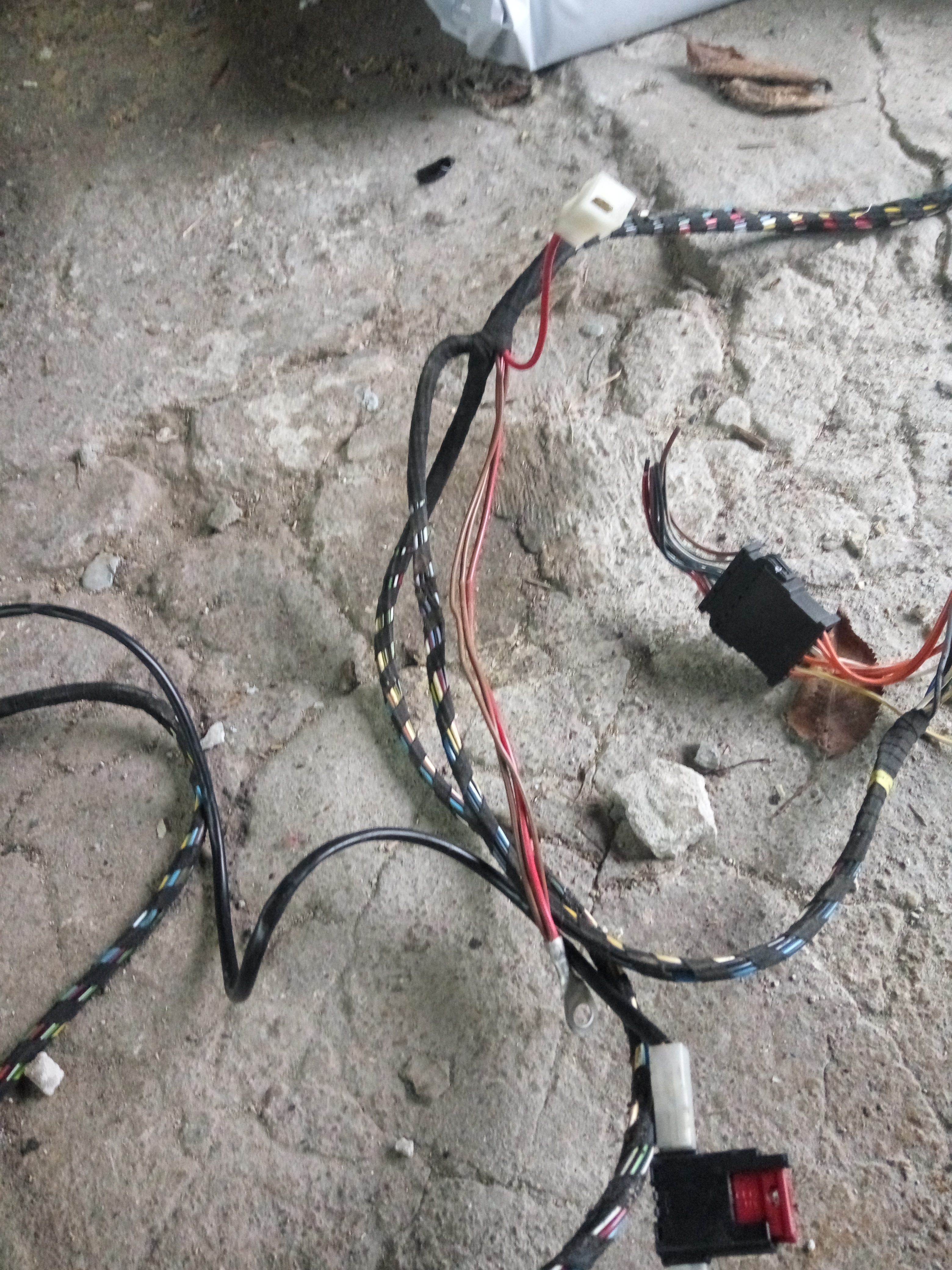

    Hello, I bought org. hook with octavia 1 estate 2003 and I will also put on this car, there is an original bundle, but I do not know how to plug it in, I marked the wires and plugs that do not know where to go, because the cubes go into the lamp, but there is a module and it creates problem in connecting because I have never seen such sockets on the back

    Hello. Skoda octavia hook 1 With the JAGER AFC module how to connect And this is the AFC module for monitoring trailer lights on vehicles with a CAN / BUS electrical system.
    Responsible, among others for trailer turn signals.
    Mounting the module is responsible, among others, for signaling damaged indicator bulbs in the trailer.

    Take apart the sides in the trunk you will find it.

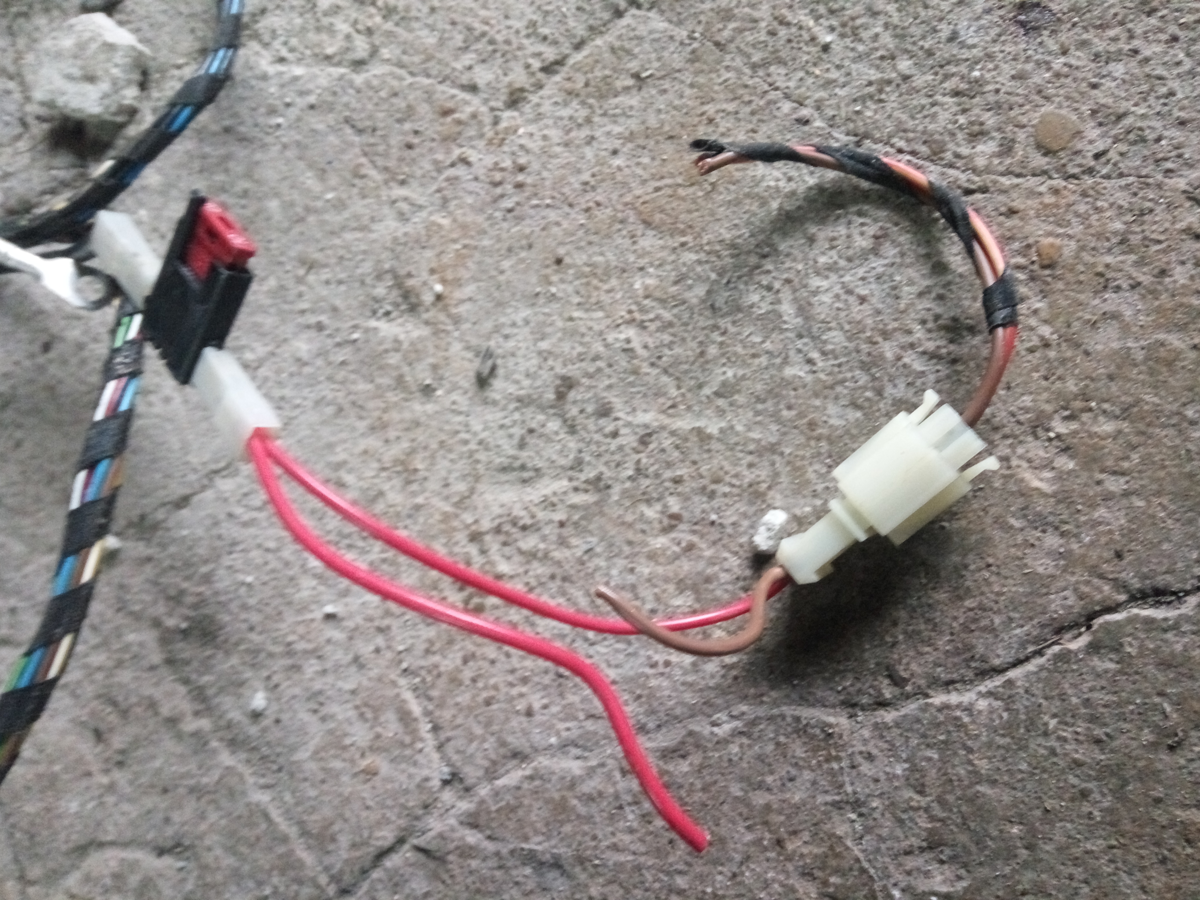

    And the cut wires in my hook? I mean D and E marked on the photo.

    D = 12V + a E = the same mass as B. Remove the upholstery. Will you find the plugs if it is a Octavi installation?

    Plug in according to the scheme what I gave you. Description is on JAGER AFC.

    is D = 12V is a constant 12v can it be from a lamp e.g. position?

    maciekchn wrote:
    then D = 12V is constant
    Of course it's permanent why is the fuse so from the parade?
