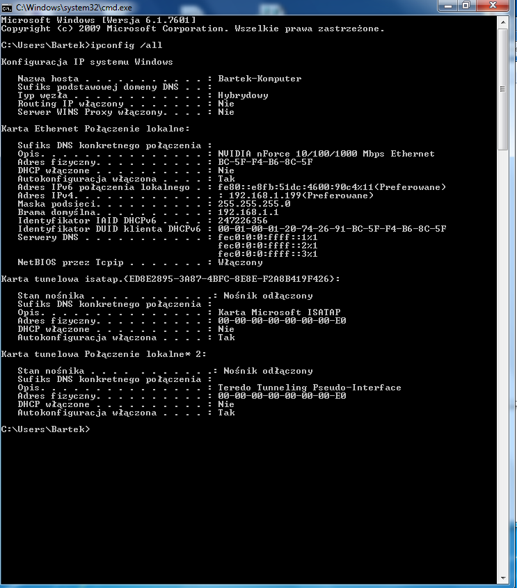

    Hello, as in the topic. I have rewritten the following topics and guides:
    Link
    Link
    Link
    Link
    Link
    And still nothing. Same message / error. I attach screenshots. One screen is before manually typing ip etc and the other is after. Windows 7 Unidentified Network Issues: Solutions for No Internet Access Errors with Screenshots Windows 7 Unidentified Network Issues: Solutions for No Internet Access Errors with Screenshots Windows 7 Unidentified Network Issues: Solutions for No Internet Access Errors with Screenshots
    EDIT. Other wired and wireless devices are also connected to the same router, each of them without any problems, the router itself does not block the allocation of ip in any way.

    Remove the network adapter driver (from under Device Manager) and restart the computer.

    Still the same. I deleted, after rebooting, they installed again, same. I forgot to add that the problem occurred "overnight". Yesterday evening I was watching a movie and I installed a Time Switch 4.0 so that after finishing the movie I would not have to get up and turn off the computer :P . Today I came after school, I started my computer and here's a surprise. I immediately checked the router, network card settings, cable connection and the internet on other devices.

    Is there internet access on some Linux Live CD?
    If so, remove these two tunnel connections.
    I'm just making a bootable flash drive and it will write what came out. I created tunnel connections because when the internet didn't work for me anymore and I started to play in the Network and Sharing Center, they also have no effect (otherwise they are disabled).

    Okay gentlemen, I ran the linux live cd puppy and the same situation there. Takes some screwed up ip, gate, etc. (same as on windows) and has no internet access. So I can suspect that the network card has fallen?
    I still had a suspicion of a broken cable, but I ruled it out by plugging the laptop into it and everything flashes here.
    Yes you can.

    After a few months of not using this computer, I replaced the network card out of boredom. It was her fault, now everything works :)
