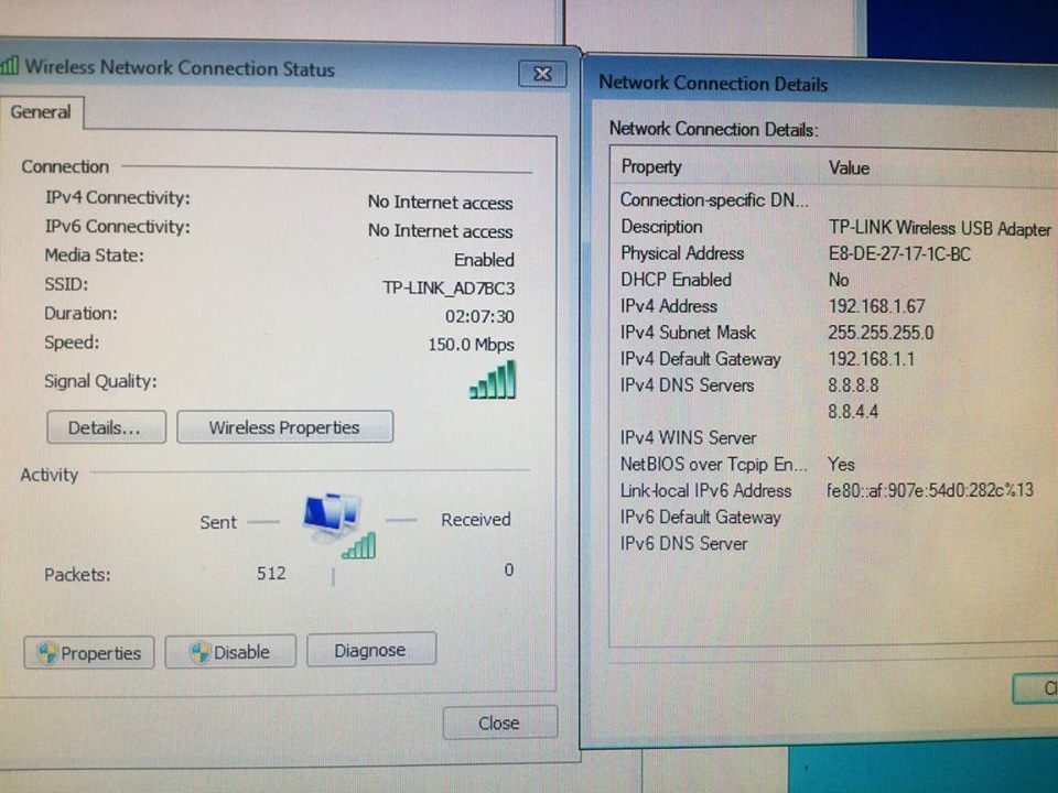

    The cable I checked when connected to another device works correctly. I will add that I tried to ping Google with the ping command www.google.com -ti I received feedback:
    ping request could not find host www.google.com. Please check the name over try again. Maybe it's a clue though it will be

    Try pinging 8.8.8.8 -t. If the answer is the DNS fault.
  • #5 16575293
    RIVo1337
    Posts: 13
    Reply form 192.168.1.67 destination host unreachable
    and so the sequence of this, I have no idea what it means, so I would ask for further instructions.

  • #11 16575468
    RIVo1337
    Posts: 13
    No internet despite the connection. (Yellow exclamation mark) No internet despite the connection. (Yellow exclamation mark)
    I'm sorry but I do not know where to look for what you ask for. As if you could tell me where to look for it willingly and in the meantime 2 screenshots may also be useful
  • #12 16575497
    hermes-80
    Posts: 12014
    Help: 1177
    Rate: 743
    The first screen tab Driver and Details (hardware ID you need to create a list and select the appropriate entry).

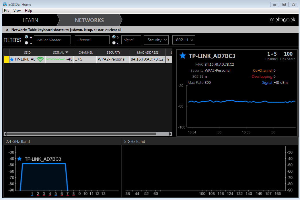

    Have you changed the channel on the router?
    Install Innsider v2 and show the scanning result of the environment.

    #13 16575559
    RIVo1337
    Posts: 13
    I hope that it was if I'm not sorry, but I really got angry. Namely, I can not run the inssider program because I do not have a net framework and when I download the net framework I do not want to install it because during installation an Internet connection is required. I wanted to install and move on the laptop but it does not support windows 10 ... in fact I can not run the inssider. Is NET FRAMEWORK missing if it can cause the whole problem? Immediately I will try to somehow embrace it

    #16 16575584
    hermes-80
    Posts: 12014
    Help: 1177
    Rate: 743
    Of course - set the broadcast channel stiffly best on some middle channel 6.
  • #17 16575587
    RIVo1337
    Posts: 13
    Okay, he's already installing the software and he'll come up with this router and talk to you! Thank you very much for your help and the time you have already devoted to me!
    Added after 12 [minutes]:
    Added after 21 [minutes]:
    Changing the channel did not give anything unfortunately. Any other ideas because I can not think of anything anymore.
