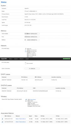

    But now something strange happened - I connected everything with a cable and the Internet in the computer started working (normally the cable from the router to the computer) - while the problem with WiFi remained the same as before - "Connected, No Internet". It is strange for me why it suddenly started working on the cable, and even weirder that WiFi did not work.
    In the photo, I put a screen from the Status tab.

    Send the configuration of this router. It is best to log in to the TPLINK modem via ssh and follow the instructions:
    cat / etc / config / wireless
    cat / etc / config / network

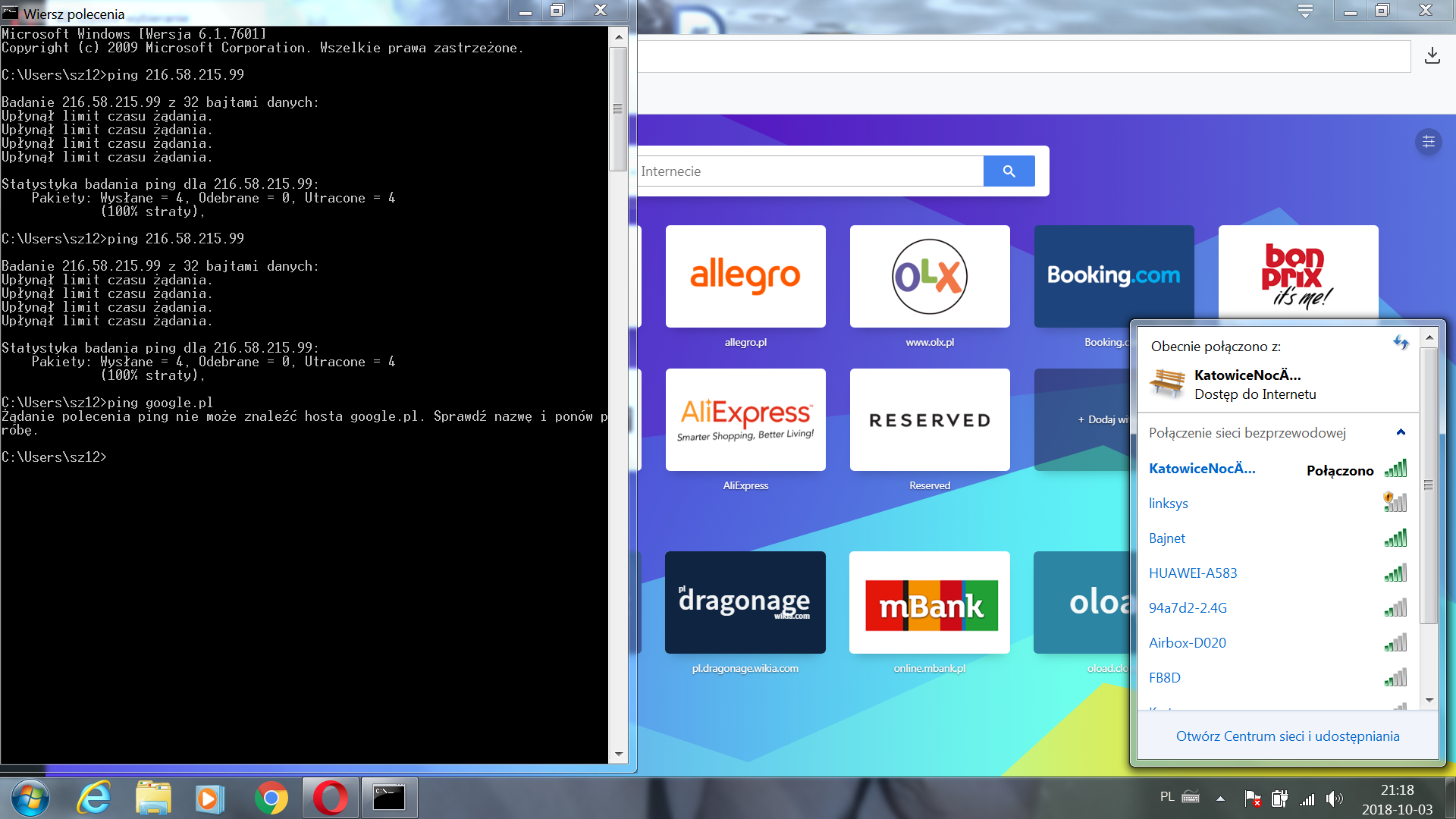

    Unfortunately, I don't know how to do this. This bash command doesn't work for me on Windows.
    Here I put the executed ping commands (I did them on a laptop connected via WiFi - now it seems to show that there is internet access but you can not load anything):
    No access to the network even though the Internet is detected (connection to the

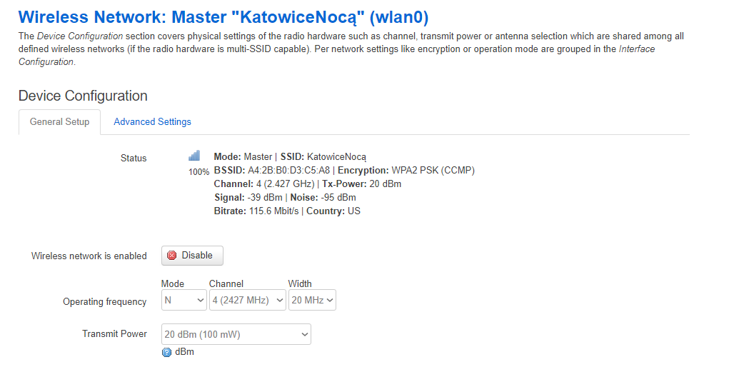

    You do not have a properly configured TPLink modem and therefore the internet over WiFi does not work for you. You probably don't have a WAN-to-LAN nat. Can you send screenshots with modem configuration - it is about Network-> Interfaces and Network-> WiFi tabs?

    Here are photos from the Interfaces and WiFi tabs - if you need anything else, I will send it. Hope you can set it up.
    No access to the network even though the Internet is detected (connection to the No access to the network even though the Internet is detected (connection to the No access to the network even though the Internet is detected (connection to the No access to the network even though the Internet is detected (connection to the

    Wifi network should only be connected to LAN (br-lan). On WAN it should be set as the 'Dhcp Client' protocol, on LAN you should set a fixed IP address of the router and enable DHCP on this interface for clients. There should be a bridge between Wifi and LAN.
    Take a screen of LAN settings (edit).

    Gentlemen :D Unchecking "Wan" in the Wi-Fi settings helped and the wireless internet works great. Thanks a lot for your help, especially for calixto :) I consider the topic to be resolved
    Thanks to the advice of users, I set WiFi only on LAN and not LAN \ WAN, it was necessary to enter the MAC address provided in the settings.
