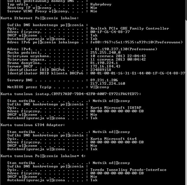

    Disable tunnel adapters in device manager. Restart the computer, check if the tunnel cards are still disabled and give IPconfig /all again (full screen - because you can't see the whole thing).
    what router?
  • #12 12404149
    scidrov
    Posts: 79
    Rate: 10
    cisco ep2425 router, this is full screen
    Added after 3 [minutes]:
    the tunnel card is like I have this realtek pci something?

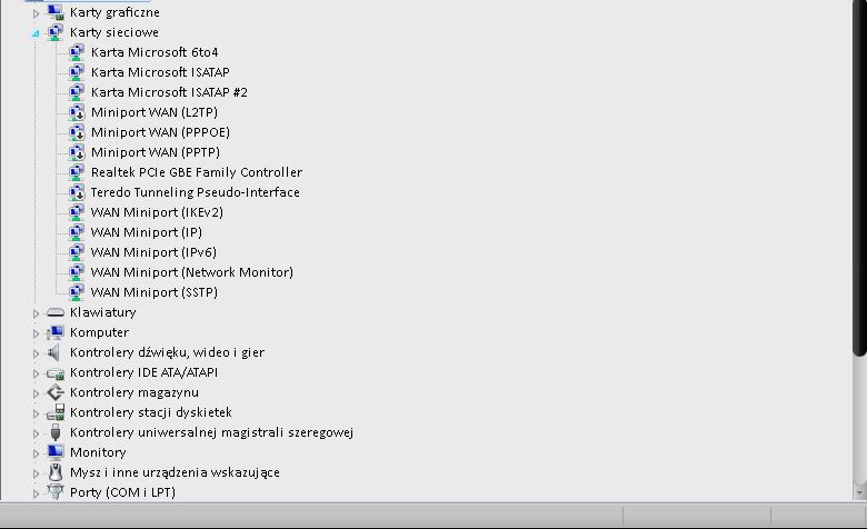

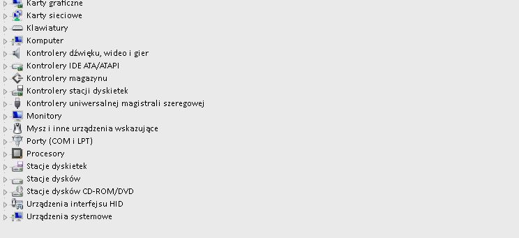

    voitek1 wrote:
    ...give me a screenshot of device manager with extended network cards
  • #18 12404424
    scidrov
    Posts: 79
    Rate: 10
    can't :c
    there is no program that would fix it or some logs I will show you to see if something is wrong
  • #19 12404439
    voitek1
    Posts: 4876
    Help: 330
    Rate: 287
    click on the triangle in front of [network cards]
  • #20 12404503
    scidrov
    Posts: 79
    Rate: 10
    you can't, like in 99% of other forums, check the logs and deduce something from them, it probably doesn't work anyway what do you want to do
    and there is only realtek family something

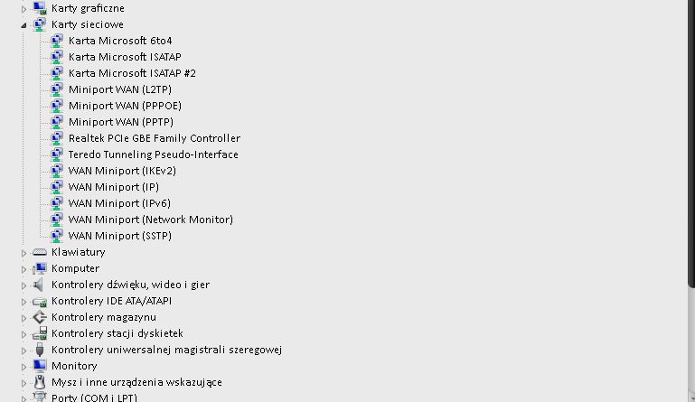

  • #23 12406196
    voitek1
    Posts: 4876
    Help: 330
    Rate: 287
    scidrov wrote:
    ...sometimes after a certain session on the computer, something like the internet goes out. It is still at the bottom of the corner and, for example, when I play online, it does not disconnect me from the server, but then I cannot, for example, log in again, nor does any browser load any page ...
    You need to disable virtual cards (L2TP, PPPoE PPTP and Torredo Tunneling). I don't know which one connects during the game, but after switching it on, unfortunately, it does not disconnect and you have a tunnel connection to the game server. Hence the lack of net/ Probably after reboot there are no problems as long as you don't start playing on the server...
  • #24 12406234
    scidrov
    Posts: 79
    Rate: 10
    how to disable these cards in the manager? and then it will fix the problem? the game is e.g. world of warcraft
    Added after 10 [minutes]:
    Should I turn it off and then it won't turn on again or should I uninstall it?
