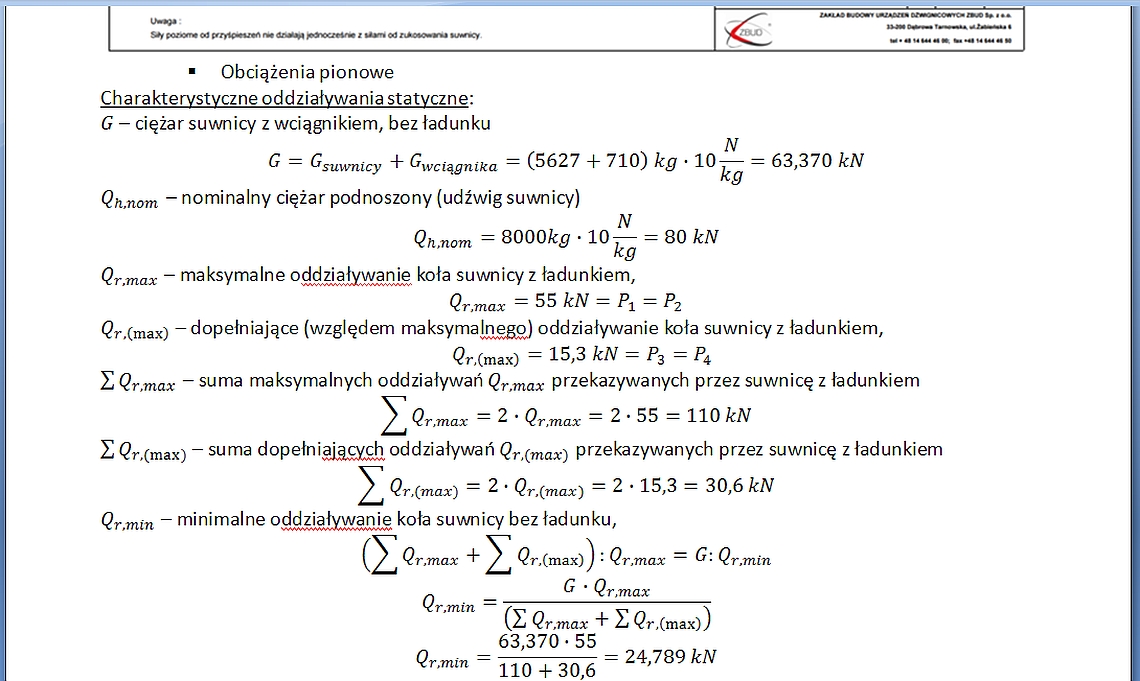

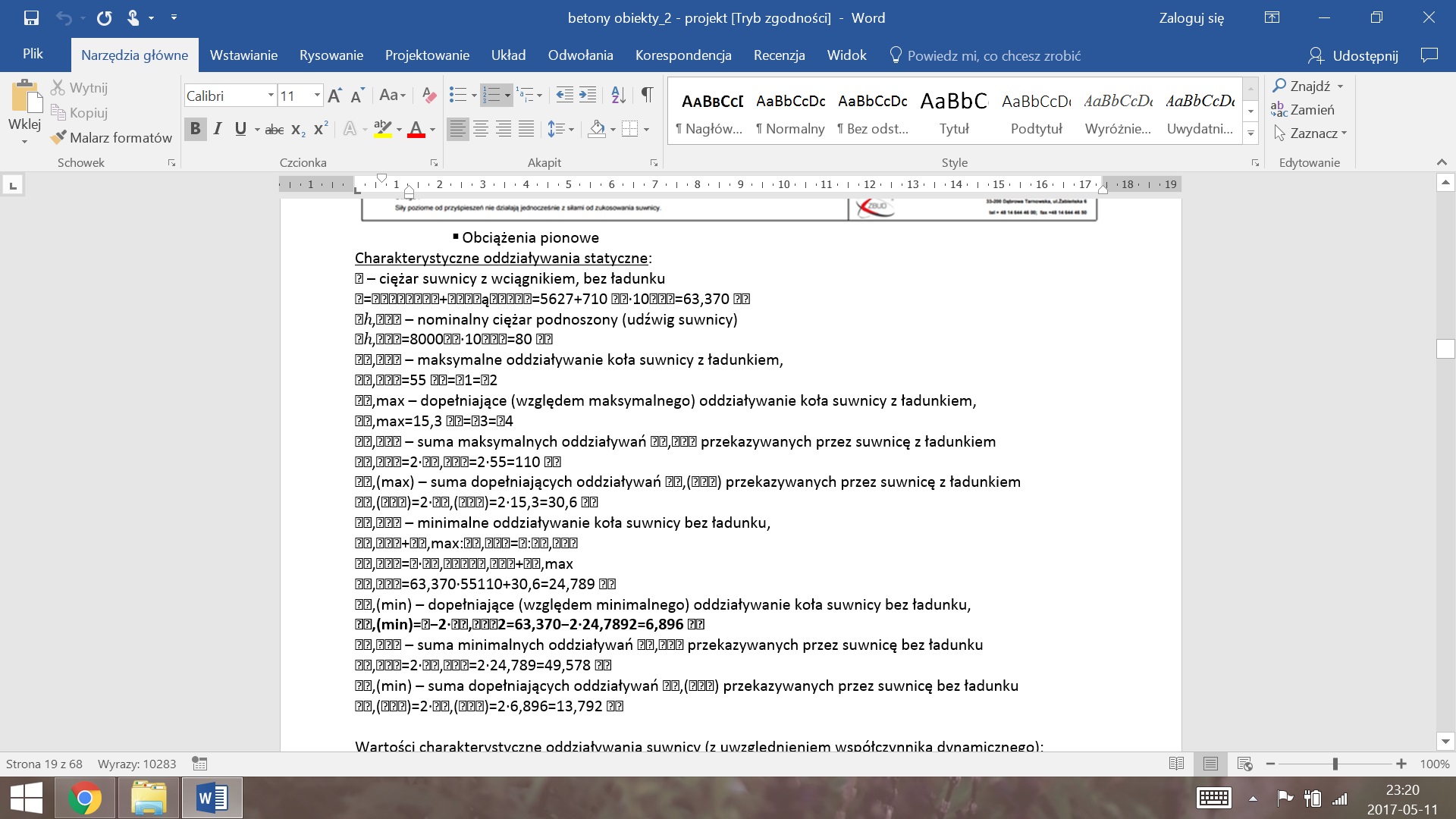

    When he wants to open a Word file, an error pops up: "The Office Open XML file concrete objects - the project cannot be opened because there are problems with the contents. After clicking on details in Word 2016, an" unspecified error appears, Location: Part: / word / ducument. xml, Line: 0, Column0 ", and after firing in Word 2007 another computer pops up" unspecified error, Location: Part: /word/ducument.xml, Line: 2, Column721983 ". Below I attach the wordowski file and 2 files find me from the appdata / roaming / microsoft / word folder.

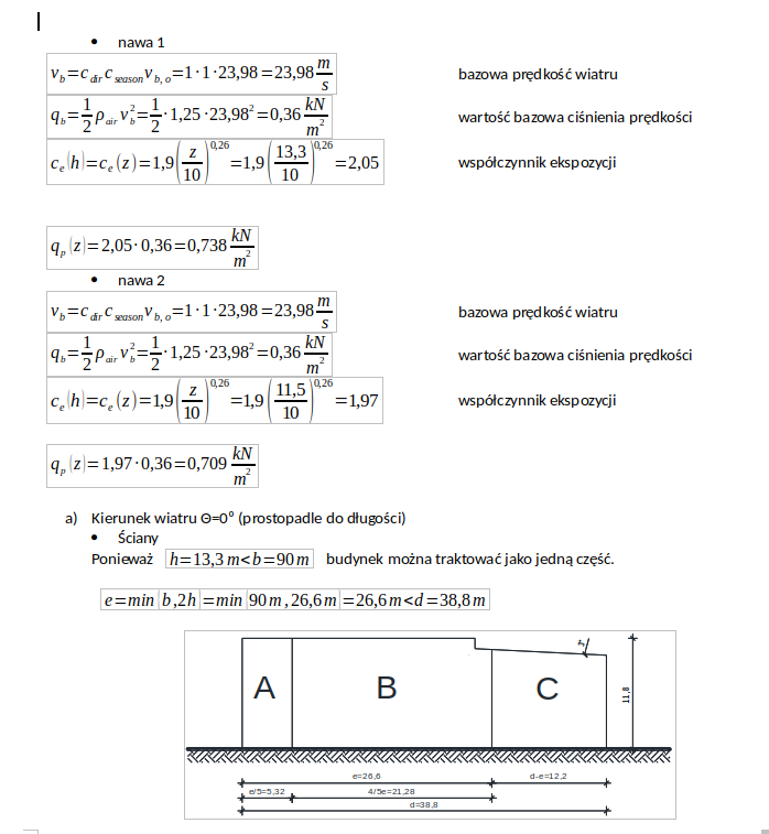

    I still opened the file in LibreOffice, but no "equations" objects are displayed - there is an empty space in their place.
    Thank you in advance for your help, below I attach files.
    • betony.rar (7.04 MB) You must be logged in to download this attachment.

    Let a friend see if the text file now opens correctly. :D

    Some equations open, but most of them are "?"

    This file was opened using OpenOffice, then saved in .doc format. Unfortunately, Word's equations are not compatible with OpenOffice, so not much can be done with this program. Let a friend try to open the file with another text program, although I doubt that the Word equations would be compatible with other programs.

    • Obliczenia statyczno.docx (4.35 MB) You must be logged in to download this attachment.
  • #10 16491252
    Robert B
    Posts: 22594
    Help: 2027
    Rate: 1412
    In Word 2007, this file opens normally, saves and converts.
    Unable to Open .docx File in Word 2016 Due to Office Open XML Error - Details on Location & Column
    • Obliczenia.doc (56.86 MB) You must be logged in to download this attachment.
    • Obliczenia.pdf (4.81 MB) You must be logged in to download this attachment.
    • Obliczenia.docx (4.33 MB) You must be logged in to download this attachment.

    The peak opens without problems in libreoffice. I wrote as doc.
    • Obliczenia statyczno-word.doc (8.65 MB) You must be logged in to download this attachment.

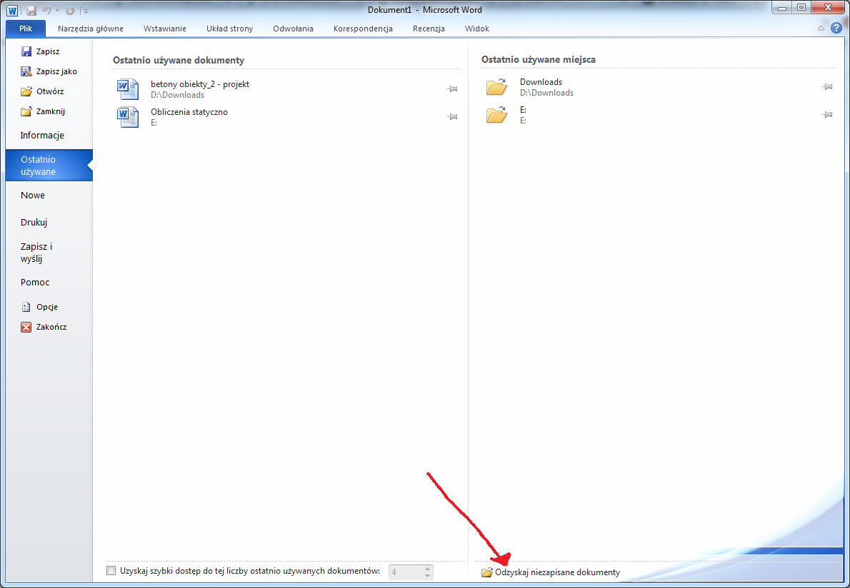

  • #16 16492573
    jarrod
    Posts: 540
    Help: 59
    Rate: 131
    Qadias wrote:
    @jarrod yes, thank you for fixing it - how did you do it? :P
    The archive you have attached is the * .asd file
    Just copy to:
    C: \ Users \ użyszkodnik \ AppData \ Local \ Microsoft \ Office \ UnsavedFiles
    Then in Word select 'open recently used files', at the bottom of the window is the 'recover unsaved documents' button. And that's it ;)
