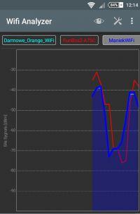

    adasito wrote:
    This situation happened overnight
    Installation on InSSIDera v2 / Home computer and insert measurement result here - we will see how many wifi networks there are and on which channels they work.
  • #6 16471571
    adasito
    Posts: 36
    I did it well on a laptop and on a computer. I do not know if this was the case but I insert, if not for more detailed instructions. First, in a room with a modem, then go to the living room and return. Orange Funbox 2.0 WiFi Signal Loss: HP Laptop Connection Issues in Different Rooms Orange Funbox 2.0 WiFi Signal Loss: HP Laptop Connection Issues in Different Rooms

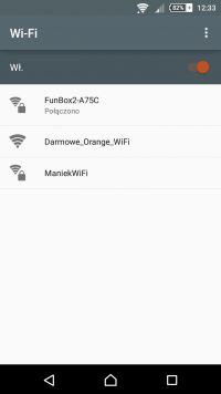

  • Inconsistent SSID visibility after FunBox WiFi rename
    #8 16471609
    adasito
    Posts: 36
    Free orange WiFi is not just an orange advertisement. In general, there is also a thing that I do not like and do not understand. Trying to change something, the brother-in-law changed the old name of the "FunBoxx2-A75C" network to the new "ManiekWiFi". And now the laptop only sees the ManiekWiFi network and the phone sees both and connects to FunBoxx2-A75C.
    Change the channel number of your network because you are broadcasting the same one.
    Do what I wrote above.

    KOCUREK1970 wrote:
    Start your computer in safe mode with networking and test.
    What about this?

    adasito wrote:
    This is not mine
    It's yours - you were on channel 11 and that too, you changed it to 1 and it changed it too.
    It's such free wifi for the clients of this operator - it is provided by every their client.
    adasito wrote:
    I checked the security type is WPA / WPA2 Mixed.
    What network key did you enter? - your own or indicated by the operator.
    adasito wrote:
    what channel is best changed, indifferent?
    Choose it yourself - the signal should be around -50 and less best.
    It is also worth considering whether the built-in wifi card has failed.
