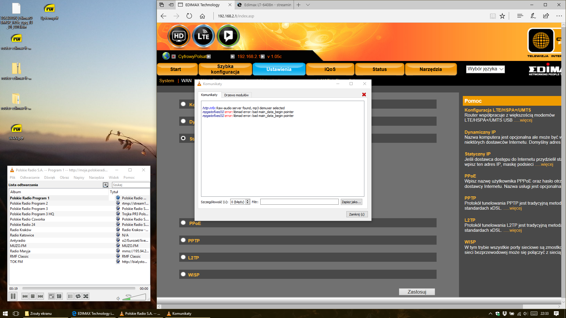

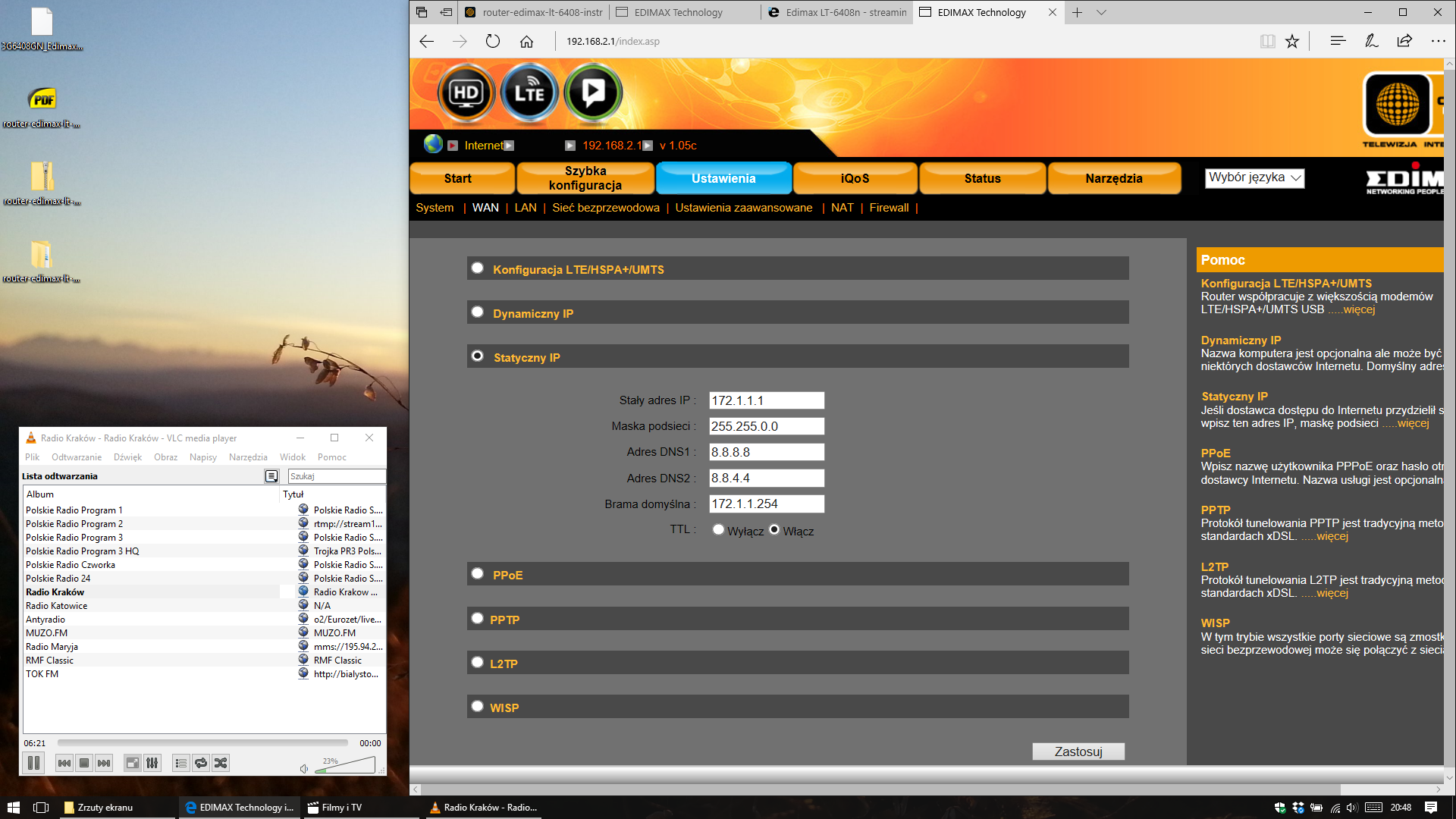

    I have the EDIMAX LT-6408n router + LTE ZTE MF823 modem and LTE Play internet. The problem is that after a few minutes it stops streaming internet radio on three computers - 2x Win10 and Win XP. It doesn't matter if it's via a website or foobar, vlc, RadioSure, Screamer. Playback stops and the player himself will not start again. You have to manually resume playback, you can do it right after the playback has stopped and it stops again after a few minutes. Downloading large files does not stop, watching YouTube, cda etc. also does not stop. I installed older firmware on the Edimax router and nothing changed. With the modem connected directly to the computer, it is approx.
    Has anyone encountered such a problem, what can you still try to do? What router settings can I try?
    Alternatively, someone can recommend another router that he is satisfied with for the ZTE MF823 modem.

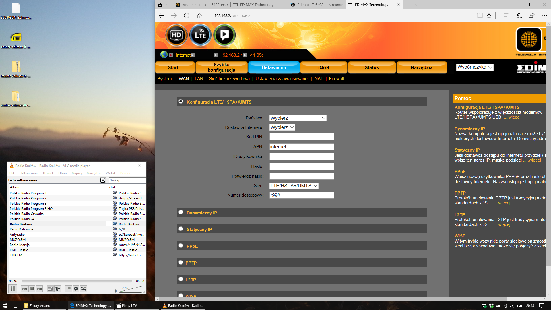

    1. Did you perform a factory reset and reconfigure the router after the upgrade?
    2. Paste screenshots of the WAN connection configuration. And status tabs
    3. What do you mean by reconnecting? Reconnecting the internet on the router,
    do you reconnect to the router?
    4. How do you connect to the router? wirelessly or wired
  • Firmware 1.05c still drops streams after 7–20 minutes

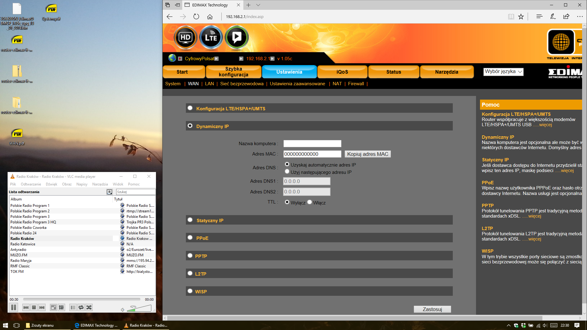

    #7 16474246
    grzesiek0401
    Posts: 243
    Rate: 31
    I installed 1.05c for the second time, but not via GUI, but with a script according to the instructions on the CP website and once after about 20 minutes, then after 7 minutes, the stream stopped again.
    1. Yes, the configuration is just setting the WIFI password, I didn't change anything else
    3. It is about resuming playback, that is clicking again on the song (stream) in the playlist / reloading the TuneIn page. You do not need to reset the connection. Interestingly, vlc doesn't resume playing itself.
    4. I connect wirelessly on 2 laptops and via cable on the PC it is the same on all.

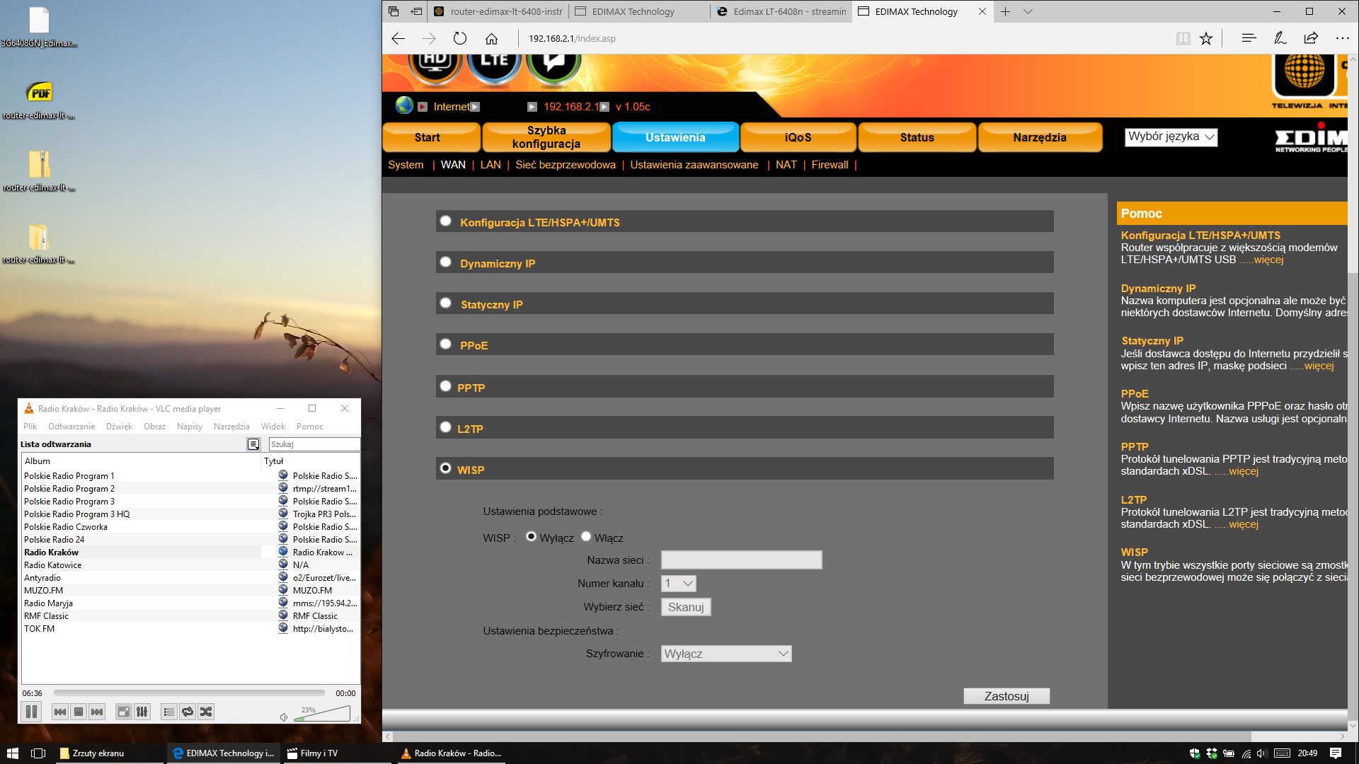

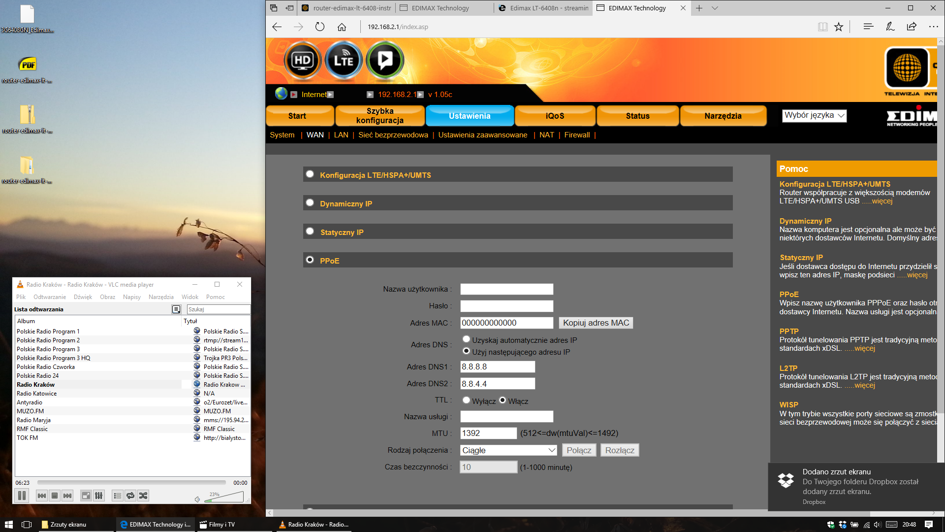

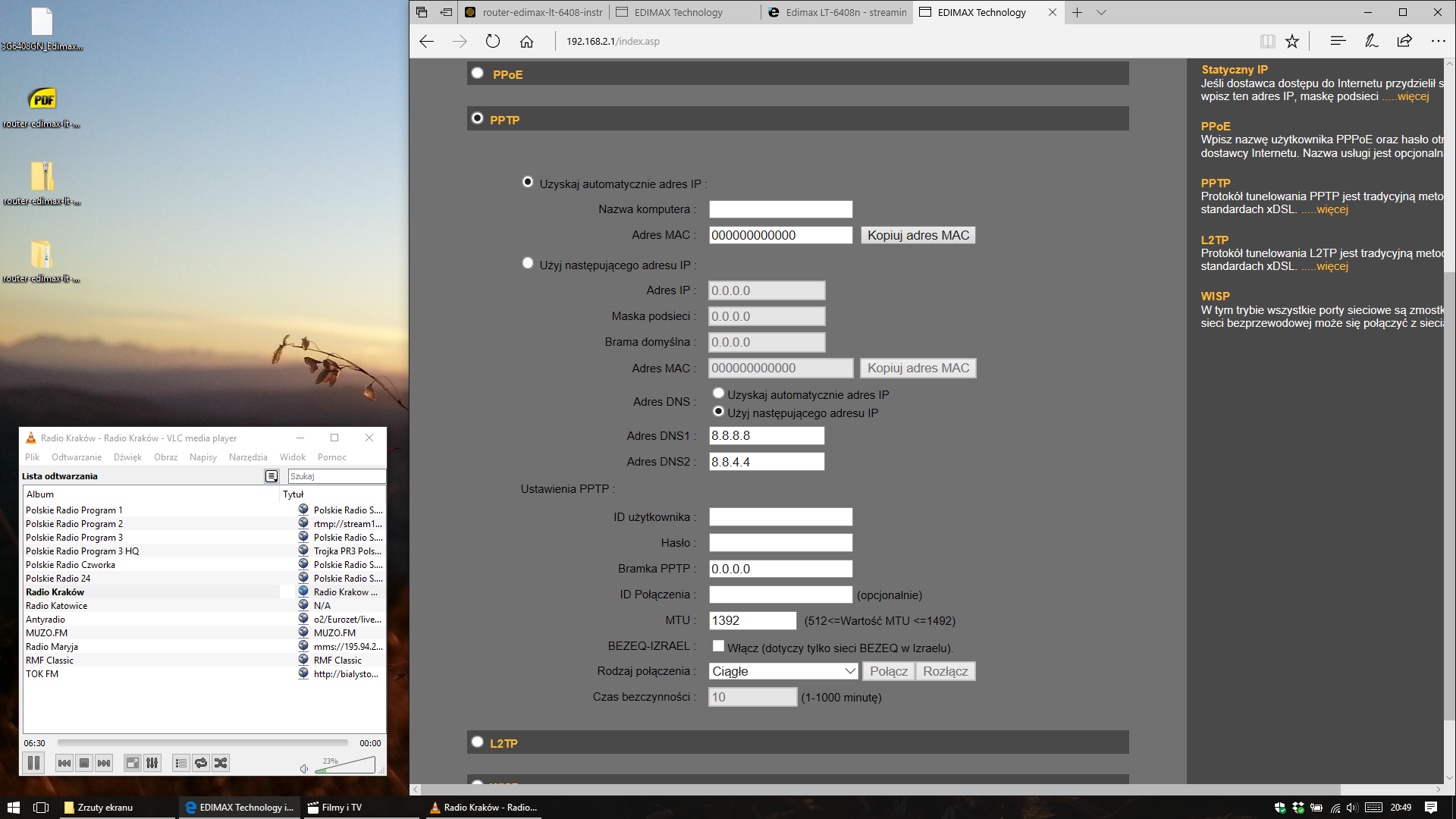

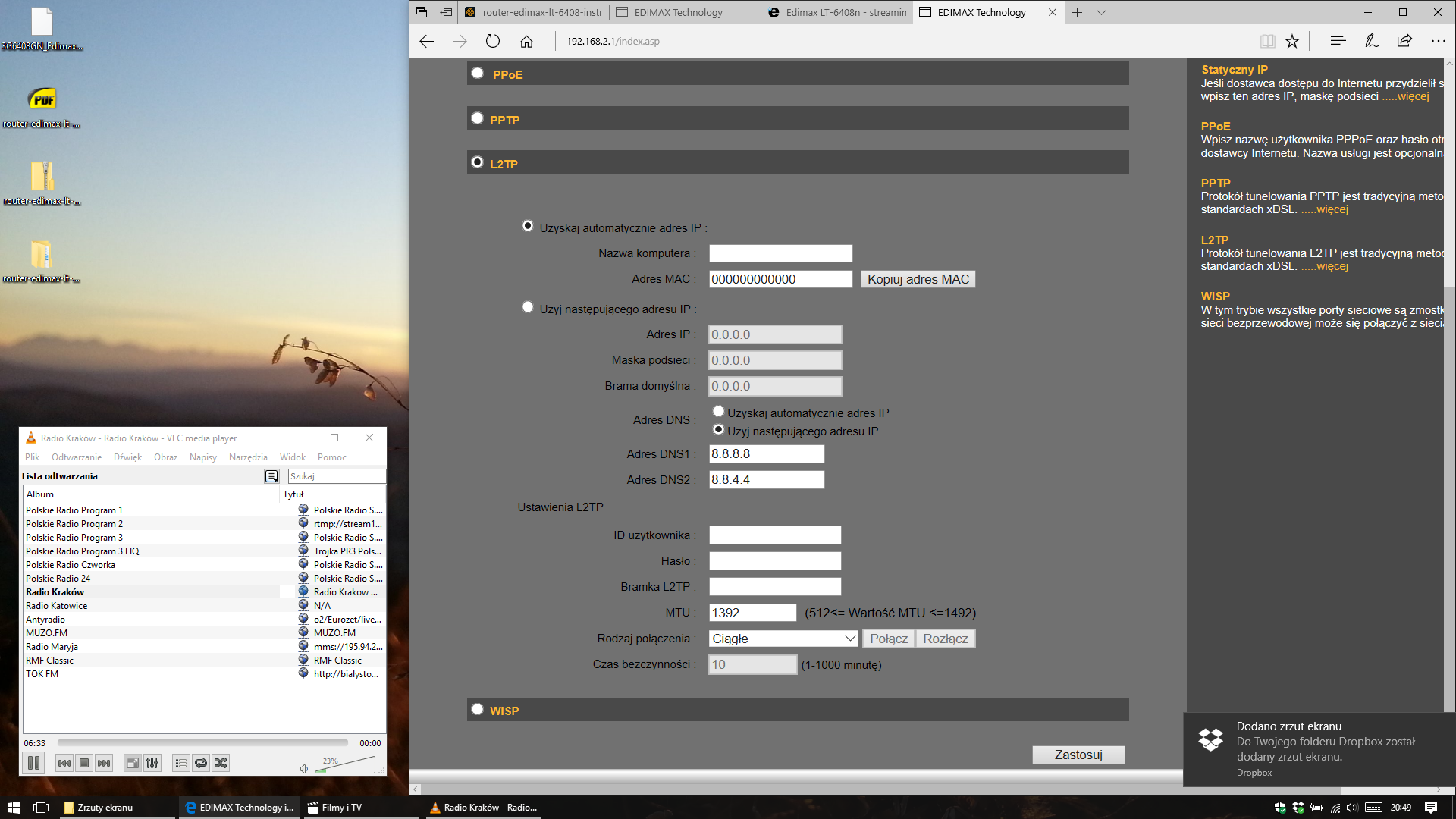

    Remove the extra configuration in the "Static IP" and "Dynamic IP" sections as well as in the rest if you changed something. Remove static DNS configurations.

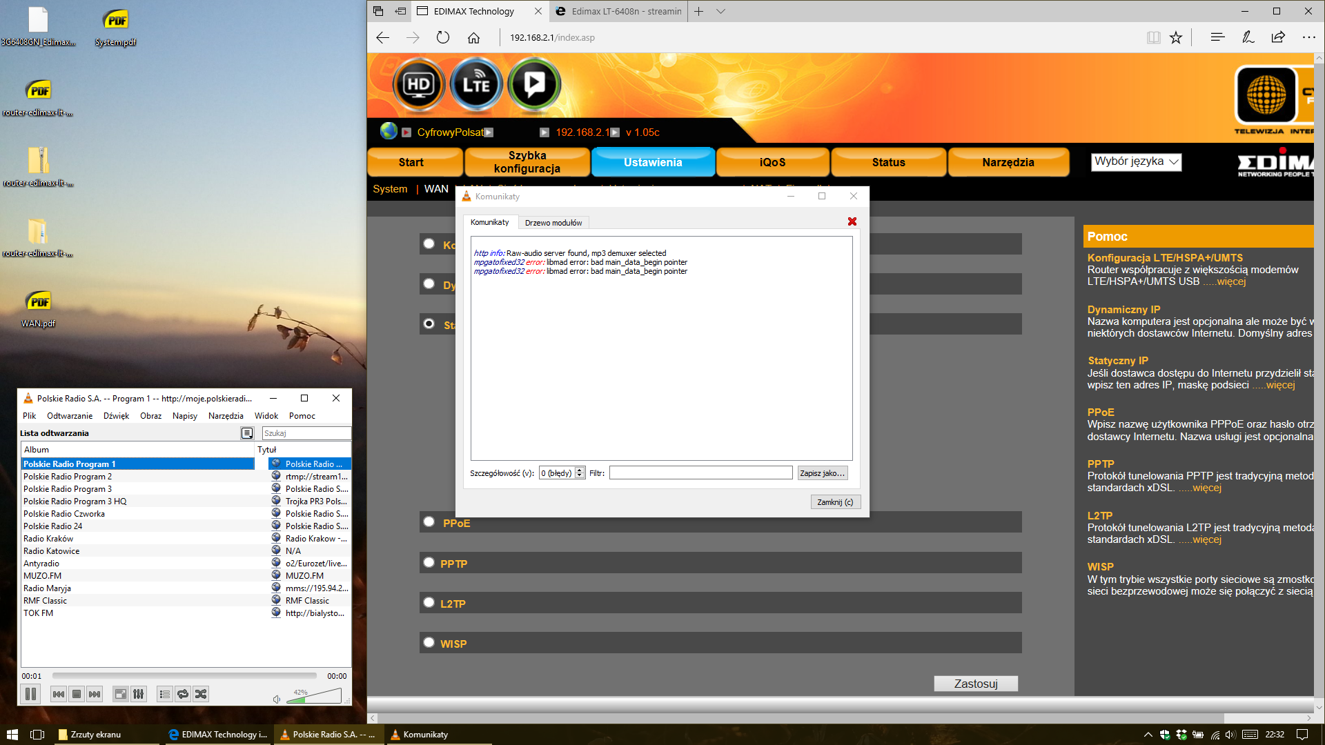

    Paste the contents of the VLC logs with the disconnection point, if it occurs after the above.
  • #9 16474525
    grzesiek0401
    Posts: 243
    Rate: 31
    I have restored the factory settings, "Fixed IP address", "Default gateway", they are completed automatically, they cannot be deleted. Now it is actually worse because after about 20 to 30 seconds the playback has already stopped several times in a row. At the moment of suspension, nothing appears in the log.

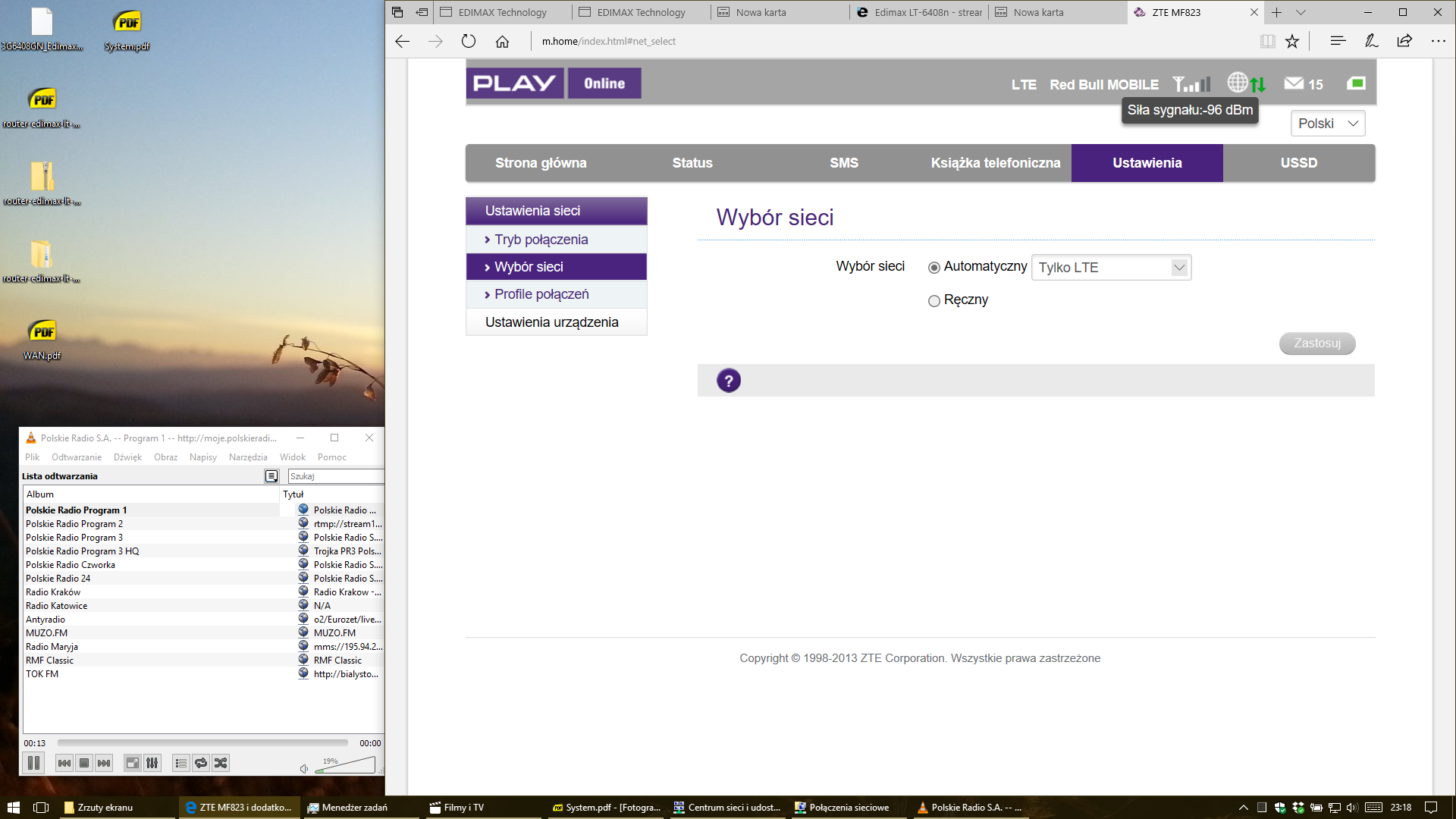

    Does the router configuration allow to enforce only one type of connection, eg LTE?
    If not, try to do this in the modem itself by connecting it to the computer.
    What is the issue with the LTE signal?
  • #11 16474607
    grzesiek0401
    Posts: 243
    Rate: 31

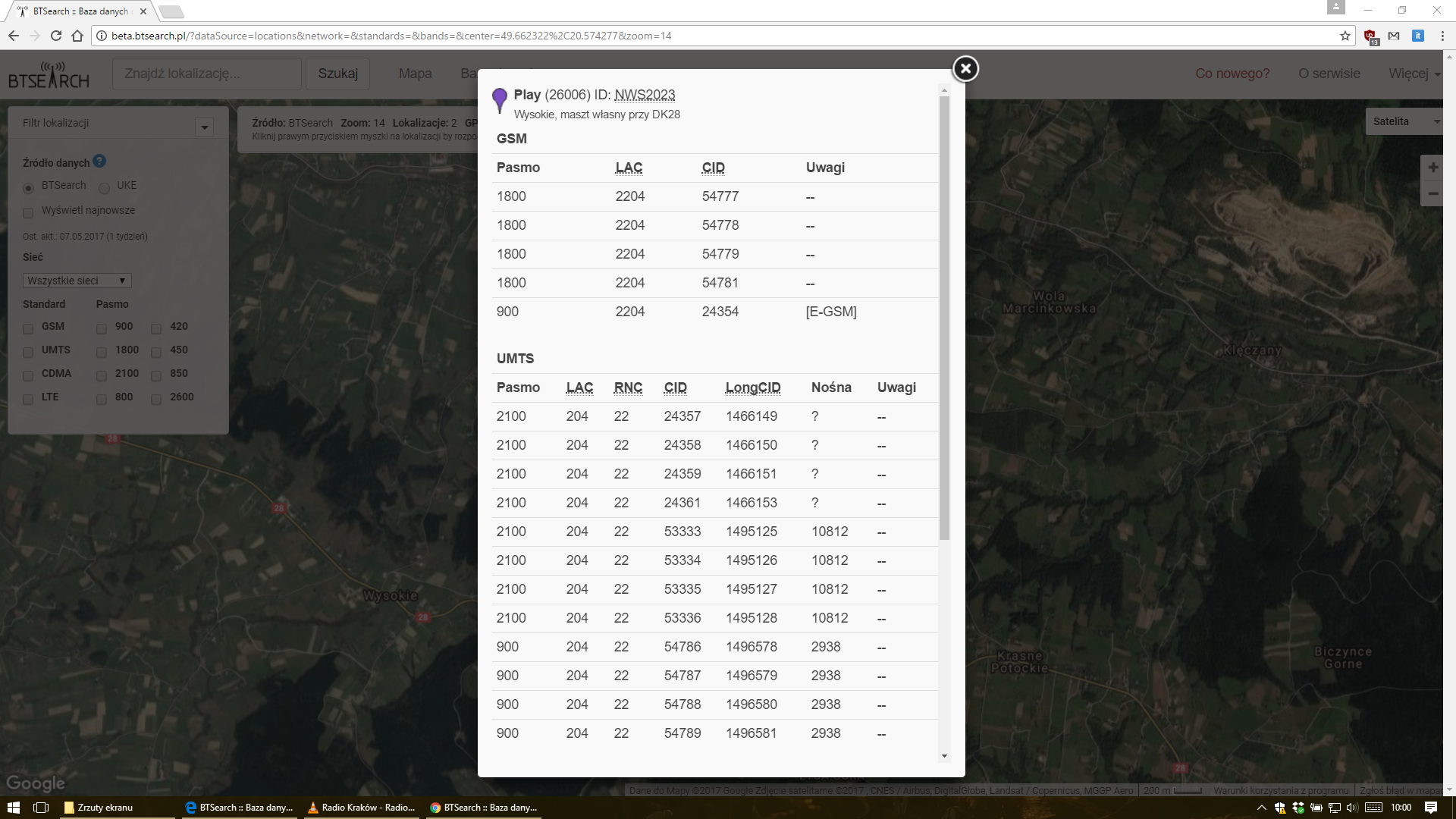

    I have already forced the Lte in the modem by connecting to the computer immediately after purchase, as you can see in the screenshots, the range is 93%, I do not have an external antenna, but the modem is on the window sill with the optical visibility of the transmitter. The distance to the transmitter is 3.4 km and full visibility (the transmitter on the top of the mountain) does not cover it. I live in the countryside, so the transmitter is not heavily loaded, the speed does not drop below 15Mb / s and the average is 30-40 Mb / s. Edimax LT-6408n Router and LTE ZTE MF823 Modem: Internet Radio Streaming Issues on Win10 and Win XP
    Now I have a modem connected directly to my computer and the radio has been working for over 20 minutes, so it's evidently the fault of the router, and now, after the factory settings, I do not know what has changed, it pauses playback for 1 minute and even works for several minutes early.

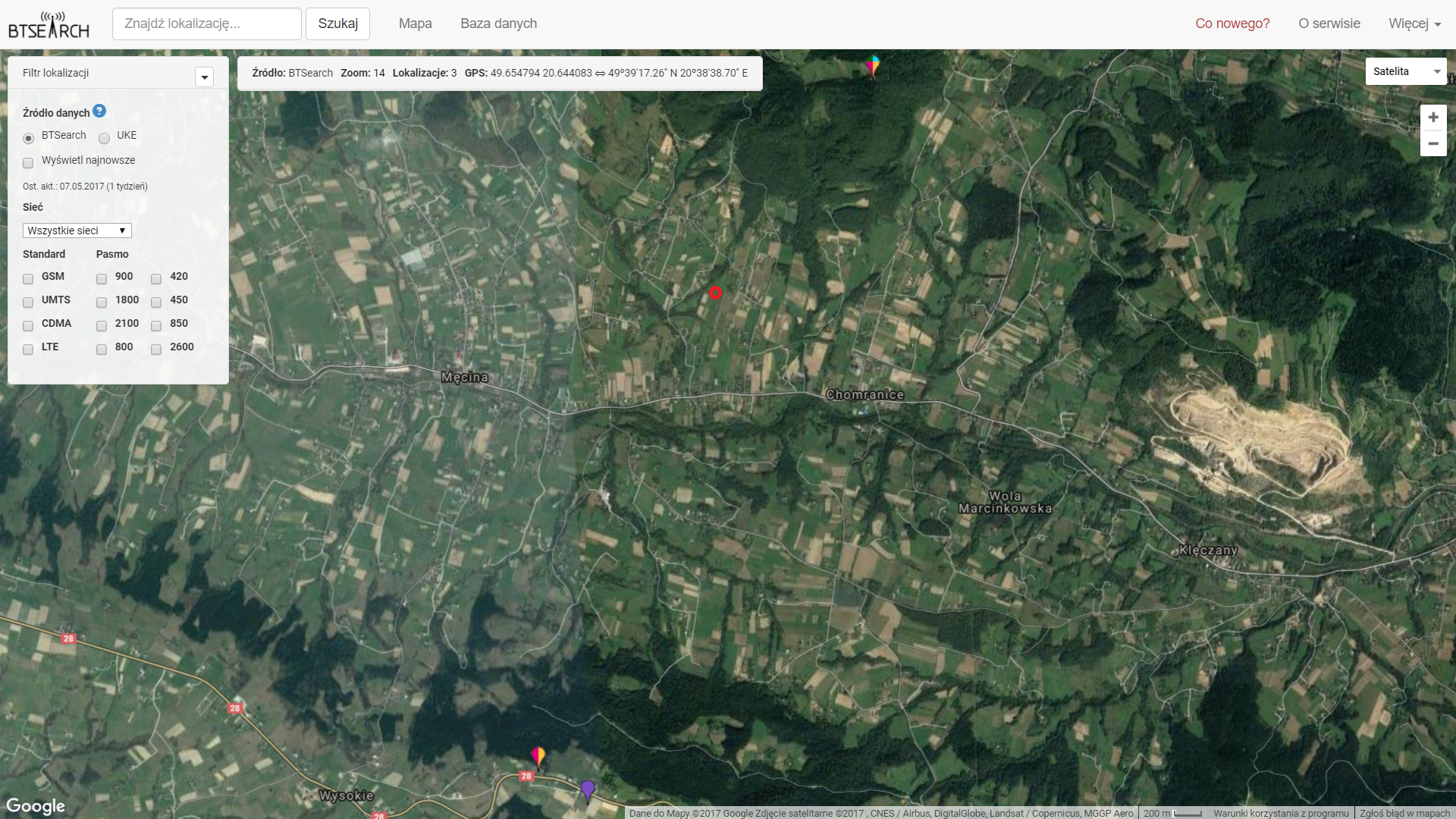

    The equipment was bought complete, as I wrote earlier, the only criterion was the price (and it was a mistake, as you can see) the equipment was used. The previous RSSI -96dBm screenshot was taken away from the window. Normally the modem in the router is in the window overlooking the transmitter (3.4 km). In addition, with the modem turned on directly to the computer, everything is fine, nothing interrupts the average speed of 30-40Mb / s. So if nothing can be done with this router, it is worth buying http://www.tp-link.com.pl/products/details/cat-14_TL-MR3420.html?
    I'll do this diagnosis right away.
    And if you buy a router over the Internet, would it be possible to test it, does this problem occur, and if so, return it? 14 days.
    Edimax LT-6408n Router and LTE ZTE MF823 Modem: Internet Radio Streaming Issues on Win10 and Win XP Edimax LT-6408n Router and LTE ZTE MF823 Modem: Internet Radio Streaming Issues on Win10 and Win XP Edimax LT-6408n Router and LTE ZTE MF823 Modem: Internet Radio Streaming Issues on Win10 and Win XP
    Added after 3 [hours] 25 [minutes]:
    The phone is in a vertical position with its back towards the transmitter, at home the test is made in the place where the modem with the router is, outside on the balcony (outside the outline of the house), which can be seen in one of the previous photos.
    matek451, what do you think about changing the firmware from a different Edimax router model, what Epic wrote about?
    • W domu.pdf (681.45 KB) You must be logged in to download this attachment.
