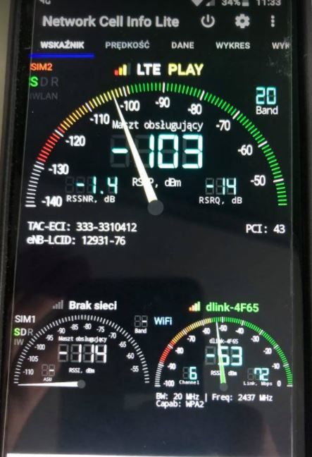

    Where you have a band lock, force each band one at a time (ie check one band at a time without aggregation).
    Make screenshots - bands 1,3,7,20 (8th in Play is not in LTE).
    After that, it will be possible to assess the aggregation of which pair of bands can be forced (WFG830 aggregates max 2 bands so it makes no sense to mark 3 as in the screenshot).
    Sometimes it works better if you only force a single strand, but first the dumps and then the deliberations.

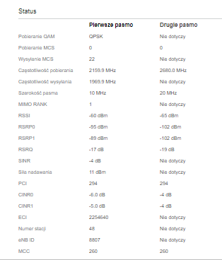

    is the current state of the router:
    it's enough?
    ZTE LTE wf830 Router Troubleshooting: Internet Hangs, Band Settings, & Antenna Placement Tips
    if not, write what should I do.
    Regards and Thanks again

    This is not enough information.
    More is here:
    - on the Settings bar,
    - and then on the left side Network \ LTE Settings
  • #7 18983418

    Read about the parameters here - https://jackiewiczowie.blogspot.com/2014/10/parametry-sygnau-lte.html
    Show this view as I wrote earlier, they will also be the parameters of the second signal, the question is whether it is aggregated at all.
    If you want to get the most out of your equipment and location, it takes a bit of work.
    In the first post you gave 3 transmitters, so tests with the antenna turned to each of them (in each of them forcing one band).
    Maybe it will not be three tests, because e.g. one is on the other side of the house, or one setting ensures that two BTSs are directed at once, etc.

    The parameters are still weak (compare with the ranges from the link I sent).
    You will have net (you probably have :) ) but you can forget about comfortable use.
    I do not know such a program. I wasn't looking for it, but I've read a lot about the WF830 in forums and it has never been recommended, so 99% of it isn't.
    If you want the best possible parameters for you, unfortunately there are no shortcuts:
    1. Chimney antenna.
    2. Aim at BTS and take 4 screenshots of LTE Settings tab (for each singly forced bandwidth).
    3. Repeat point 2. as many times as you turned the antenna.
    4. Upload screenshots here.
    Remember / mark the antenna settings in a given test, in order to return to the selected one later.
    Are these BTSs physically visible and unobstructed from the chimney?

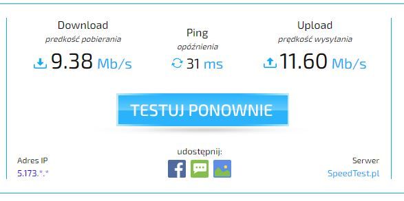

    And what does speedtest look like in aggregation LTE2100 + 2600, BTS from Galeria Grunwaldzka - enough signal at 2100MHz and weaker at 2600MHz. The antenna on the WF830 has a wide beam angle. The kit requires assembly from Play, if you want to have 30 days for testing. And why this set?

    This set worked best from the four borrowed from the Play store. I have a good layout there
    A remake of the Huawei 310, Huawei 535, Huawei b618 and even the MikroTik LHG LTE6 kit.
    The Zte 830 worked best.
    Maybe one of Huawei with an antenna will be better?
    How do you think?
    Before the Pandemia, I was working on the huawei 310 and it was ok, i.e. the internet was nothing to break the netflix youtube on tv worked. Then the problems started. So I tried other devices.
    Earlier, I thought that I would connect the device to the socket, connect the mains and it should be. Now I know it is that simple.
    In order to get as much lte as possible, you need to put in a lot of effort and, above all, have knowledge of what you are doing.
  • #14 18984895

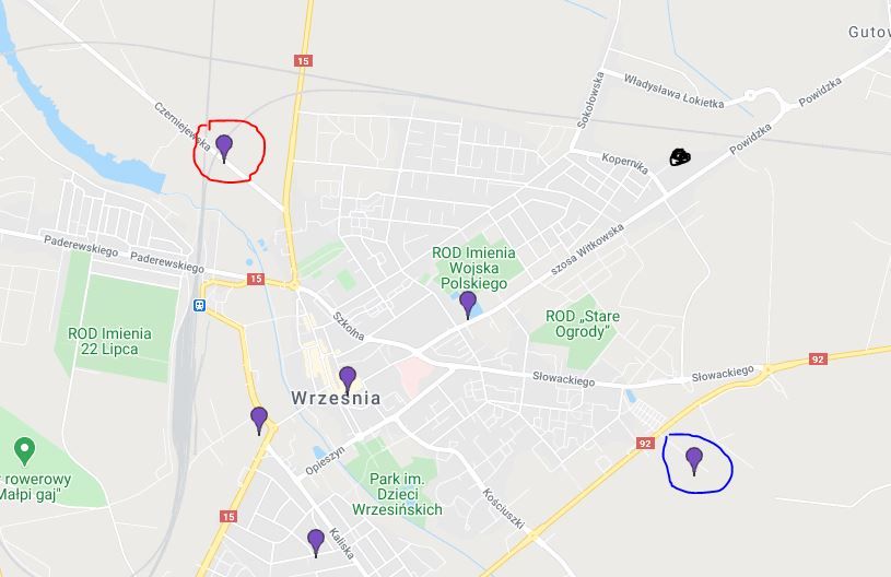

    I have bands 1 3 7 set - I checked one at a time about 10 meters and if seven is dead.
    My situation is shown on the map "
    - black - living
    - red - router login location
    - blue phone login location
    Is it possible to block also the transmitter - e.g. the closest one? can you squeeze anything out of it to improve the parameters? The antenna is on the roof and the buildings in each direction are single-family houses
    I am asking for a hint or advice what I could do

    Show tests of individual bands 7,3 and 1 and the LTE settings and speed tests tab, the WF830 has an antenna with a wide angle of radiation in the horizontal plane. For Play in this location, the B818 and the Dual LTE1800-2600MHz external antenna are selected.
