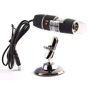

How can I find the driver/software for a USB 500x 2MPX microscope when the original disc is damaged?
Use the Micro-Measurement Tool software rather than trying to install the disc driver: connect the microscope to the computer without installing drivers from the disc, install Micro-Measurement Tool, then right-click it and choose "Run as administrator" [#16474614] [#16474672] If it still does not start correctly, disconnect the device and uninstall it with USBDeview before reconnecting [#16474672] The microscope is detected as a camera/Lenovo camera, and the bundled software is needed for calibration and measurements [#16474612]

    I don't have a driver for this type of microscope.
    I have a disc but it's damaged.
    USB 500x 2MPX MICROSCOPE

    pidar wrote:
    How is it detected in USB Device Tree Viewer :?:
    as a camera.
    but it doesn't work. there should be a program for calibrating, dimensioning etc.

    Micro-Measurement Tool was on this record :?:

    I do not know.
    The CD says "Driver" and that's it heh ... and the white box without any inscriptions.
    This system detects as a Lenovo camera.

    "I shoot" here. :lol:
    Spoiler:
    "ATTENTION!
    In case of problems with starting the software under MS Windows 7, Win8 / 8.1, please follow the instructions below:
    1. Connect the microscope to the computer *, without installing drivers from the disc.
    2. Install the Micro-Measurement Tool software.
    3. Right-click the icon of the installed software.
    4. Click "Run as administrator". "
    * Before that, do the following: Disconnect and Uninstall in USBDeview .
