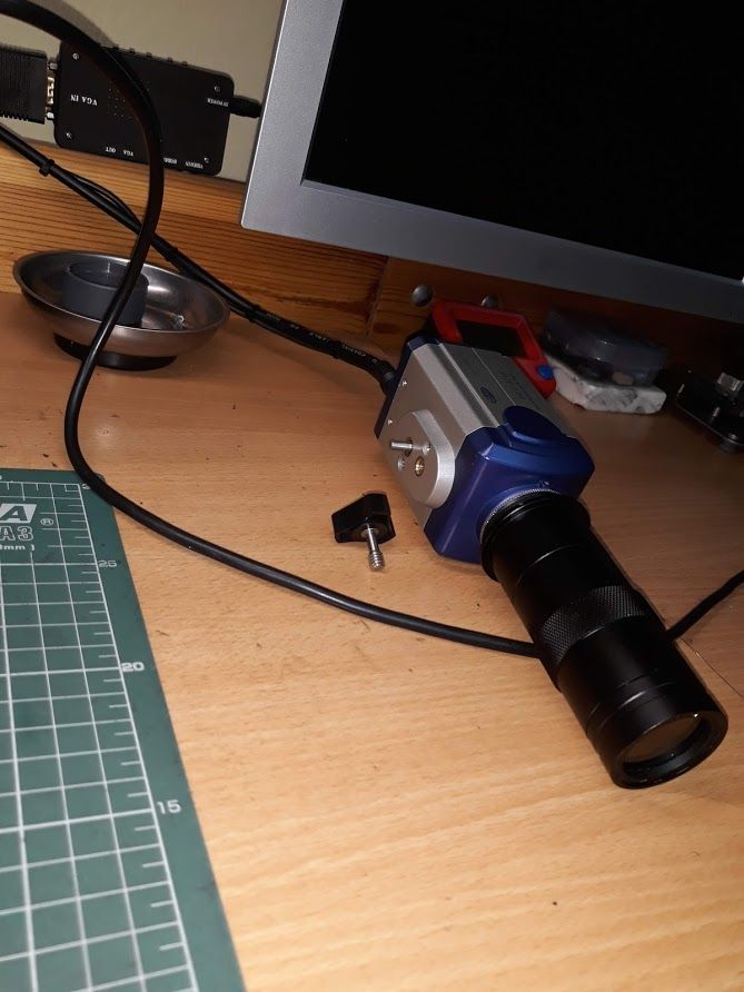

    The design is not extraordinary and innovative, it is based on an industrial camera that I recovered from electro-waste, the webcam gives a video signal in color (I was even surprised that we throw away such things here).

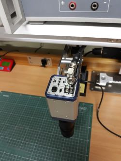

    The camera output is typical for industrial cameras, the AV output is terminated with a BNC socket to display the video signal on a computer monitor due to the fact that CCTV monitors are for some reason much, much more expensive, I used a signal converter purchased on a Chinese portal. It has several inputs on board, including VGA, SVIDEO and industrial AV input and one VGA output, of course.
    Inspection microscope stand (made to measure) Inspection microscope stand (made to measure) Inspection microscope stand (made to measure)
    For me, it turned out to be practical enough, because I additionally connected the video signal from the computer to it with a standard VGA-VGA cable, but quite long, about 5m, and in case of the need, for example, to view the diagram that I currently have displayed on my computer monitor, the arrangement of components without detaching from the soldering iron, I switch the image signal source that interests me.
    I won't elaborate on the functions that the converter has, I've had it for a long time and I don't really remember what parameters it has.
    In the webcam itself, a C-Mount lens was replaced (of course also purchased on the Chinese portal), which allows me to enlarge the image 30 times, a better lens could be installed, but the price was about PLN 80, on the portal it was stated that a magnification of 100x.

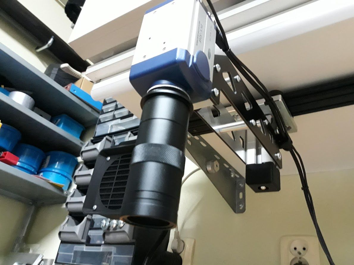

    For the whole thing, I needed a tripod, on which I planned to mount the camera steadily, especially since it gained some weight with the new lens, but at first I had no idea for a good solution. In the place where the microscope was to be mounted, there was little space, because for the sake of convenience, I installed a shelf above the worktop for the instruments. I came up with the idea that I would install the articulated arm of the camera's boom on the underside of this shelf. It served me for a while, but it had a tendency to drop to its maximum reach, and that was how it was set up for work. Additionally, in the horizontal axis, the microscope was able to loosen, so that before each unfolding, all the locks had to be tightened very tightly, sometimes I had the impression that the threads would not withstand it.

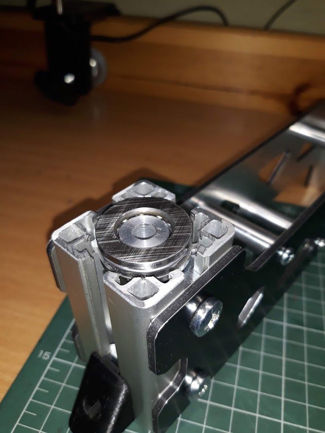

    And recently I decided to solve this problem, I designed a new tripod in Fusion360, also screwed to the shelf.
    The structure is based on one 20x40 mm V-slot profile, which serves as a horizontal guide, and one 40x40 profile, which is the rotary axis on which the microscope frame is mounted. The rotary axis has a bearing, in addition, I used a simple magnetic lock when setting the microscope to work, so that the system did not have a tendency to self-fold. The elements of the tripod, apart from the profiles and some small elements, were cut on a CNC plotter. The rest of the details are shown in the photos, on the GrabCAD portal where I have placed the CAD file of the structure, you can download it or watch it in 3D => https: // grabcad.com/library/inspection-microscope-stand-1

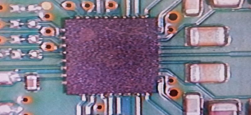

    How about image lag? Is it noticeable?
    Will you insert a photo with an image at the maximum magnification?

  • Image lag is imperceptible at maximum magnification
    1. In fact, for me it is imperceptible, to illustrate this effect I recorded a video, I leave the evaluation to those interested:
    20210120_1..116.mp4 (1.62 MB)You must be logged in to download this attachment.
    2. I am attaching photos: the first is a 10 mm x 10 mm grid, and the second is the JM20329 chip in the LQFP 48 housing, monitor - 17 inch diagonal.
    Monitor displaying an image of a 10 mm x 10 mm grid on a workshop desk. Image of a display with a magnified view of the JM20329 chip in LQFP 48 package. JM20329 integrated circuit in LQFP 48 package on LG Flatron monitor.

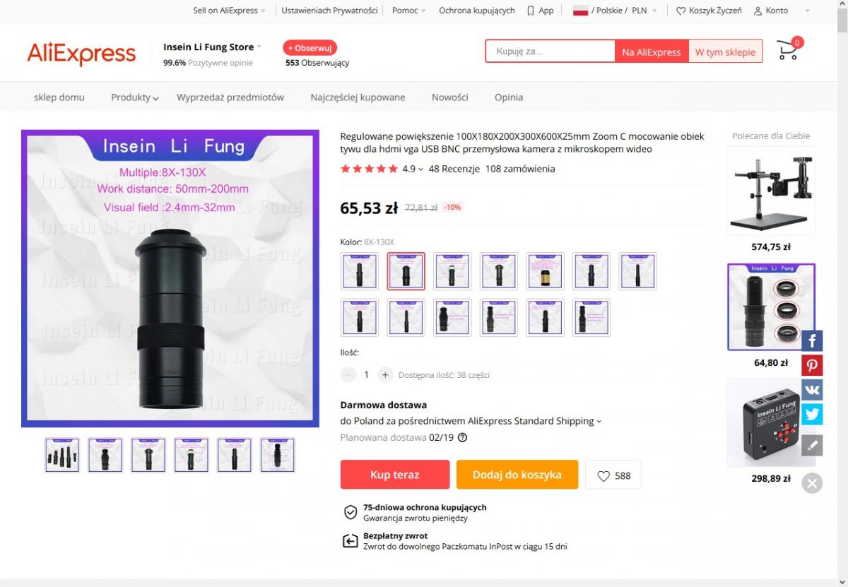

    CMS wrote:
    Scary gibberish at this auction.
    And these 80P LN probably are no longer valid.
    It's a fact, more than once I wondered what would come, but fortunately for me it was always what I expected. I have already ordered devices for even a thousand and a few zlotys, but the price is even lower. In one offer you have a choice of different lenses and yes - the one I have is 8x-130x and costs PLN 65.53, there is also a better 10x-200x for PLN 144.85 - all offers with shipping in the above-mentioned prices.
    And those PLN 80 are probably not valid anymore.
    Up-to-date, click on the lenses thumbnail.
    I will also be tempted and do the same as my colleague, the cameras are not as expensive as I thought and the lens is already floating / flying.

    Hello, can you have a link to the store with the 10x - 200x model?
  • #23 19204815
    Darek05
    Posts: 53
    Rate: 49
    Here you are, but this is an example offer that I gave a few threads above, my intention is to indicate what to look for and not to promote the seller and the forum administrator may throw this thread to the trash, Link
    in the following item, select the appropriate one:
    Screenshot of a microscope offer on the AliExpress online store.

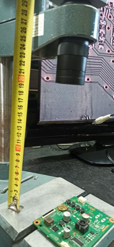

    Mine is mounted 11 cm above the table, recently I built an additional LED ring light for it and noticed that the color of the light has a very large influence on the image quality. Above the desk I have LED lighting similar to the color of natural light and the image on the monitor is clear with natural colors, while with the ring illuminator turned on, which gives a bright white light, the image becomes blue, not clear, adjusting the intensity does not help much here.
    I will try to write about the built illuminator soon, I will add that it is built on the basis of a ring with 16 WS2812B LEDs, in addition to adjusting the intensity, it has the function of regulating the lighting zone, I am thinking of adding the function of changing the light color.
    Measuring tape showing the height of LED lighting above a workbench.

    11 cm is a bit small, I aim at a minimum of 25 cm.
