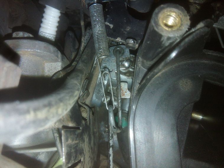

    The engine of the MTD SPRINTO tractor - B&S 190cc 6HP OHV after removing and reinstalling the carburetor works only at maximum speed. My observations show that the centrifugal regulator does not move the throttle. Does bypassing this element by, for example, mounting the tendon instead of the speed regulator spring, make any sense? How to approach the problem?

  • #12 16480961
  • Governor arm needs correct repositioning
    #13 16482509
    audiofil9090
    Posts: 40
    Rycho T wrote:
    It did not have to be removed at all, when carelessly detaching the rod from the carburetor, it turned on the axis of the regulator. You just need to set it correctly.
    I can see that I finally got the answer from a professional and I am very happy about it. What exactly should I photograph?

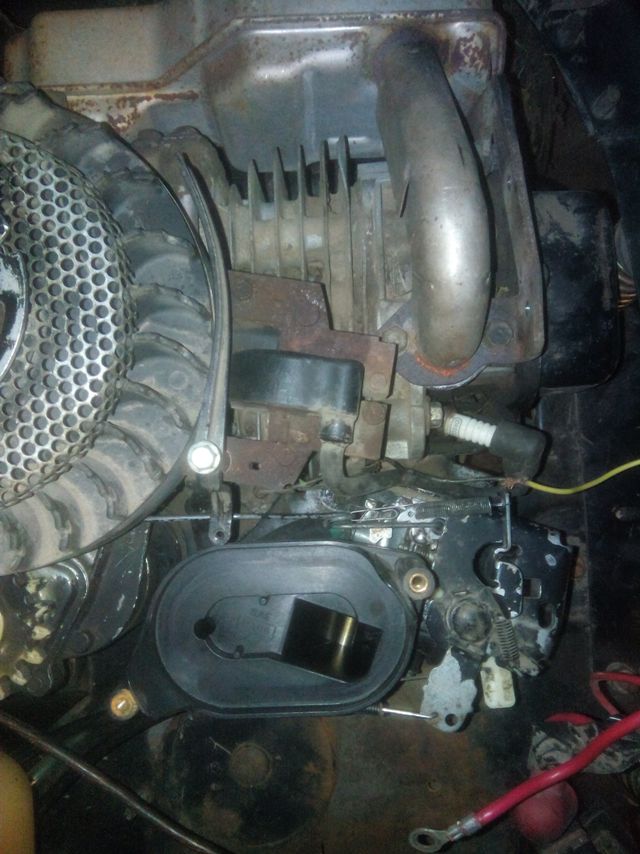

    From the outside, it looks like this:
    Briggs & Stratton 190cc 6HP OHV Engine - MTD SPRINTO Tractor: Centrifugal Regulator & Throttle Briggs & Stratton 190cc 6HP OHV Engine - MTD SPRINTO Tractor: Centrifugal Regulator & Throttle
    As you can see in one of the pictures I did a small experiment and put on a plastic "fan" to attach the coil from an old mower, and after making a temporary connection, strangely started to regulate the speed so if I can't connect as it was, I have an alternative.

    Rycho T wrote:
    Release the regulator screw, hold the lever so that the throttle is fully open, turn the regulator axis counterclockwise until it stops and tighten the screw.
    It did not help, when the throttle was open the regulator axis was rotated maximally counter-clockwise, I still can't feel it because I can feel a clear resistance.
