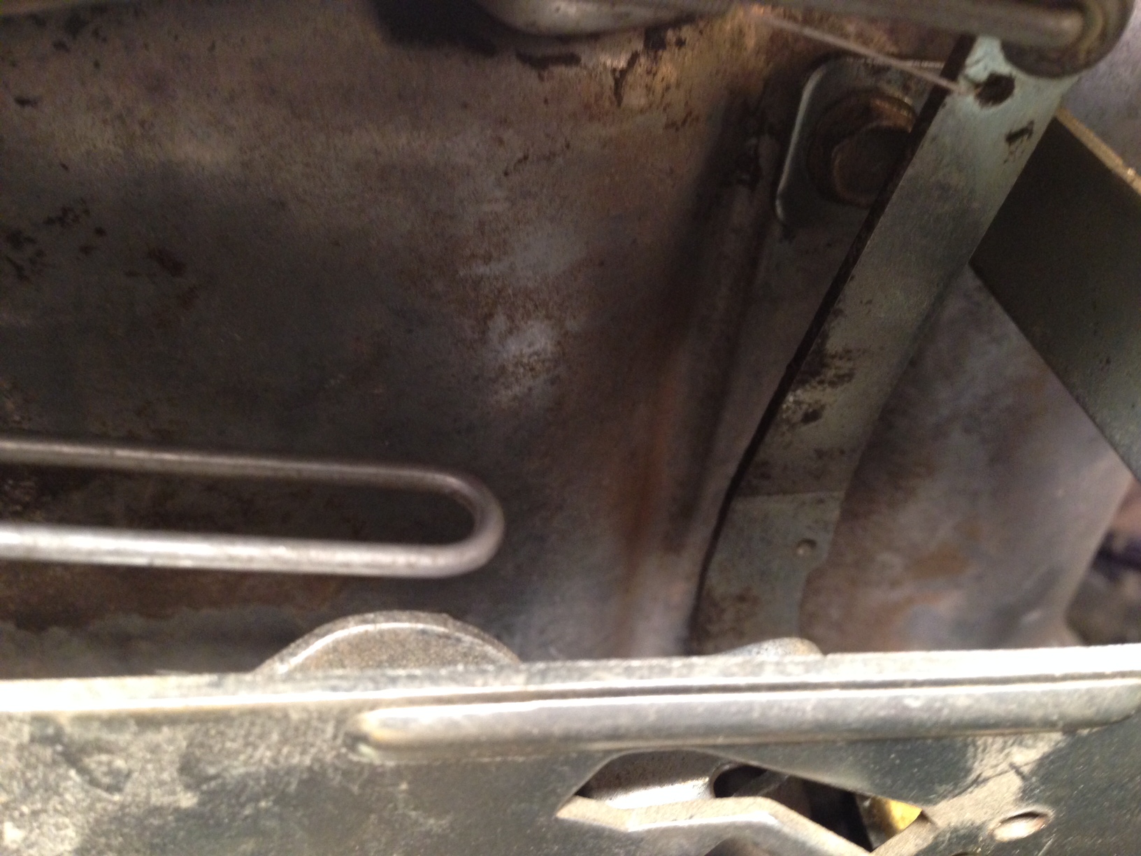

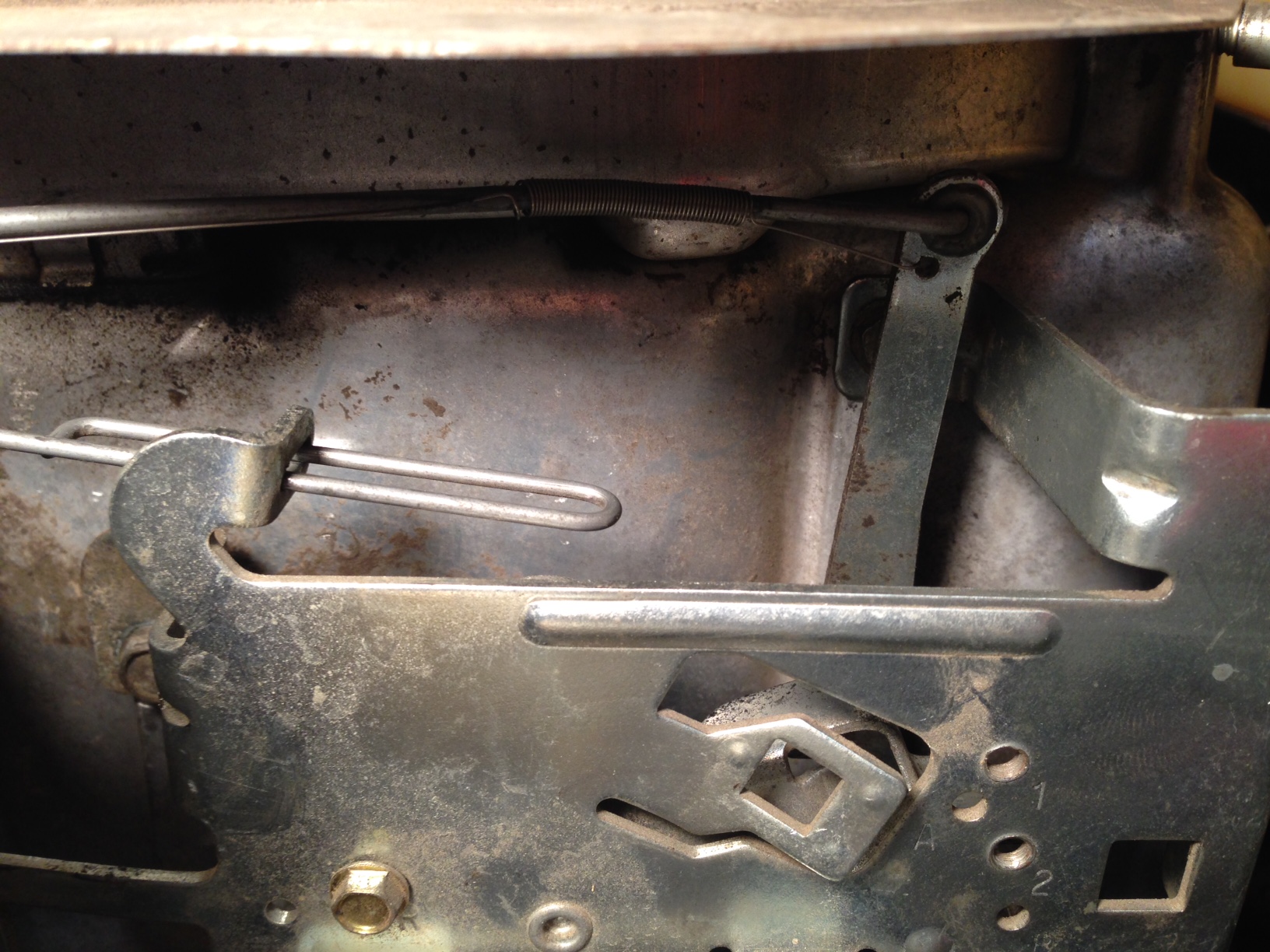

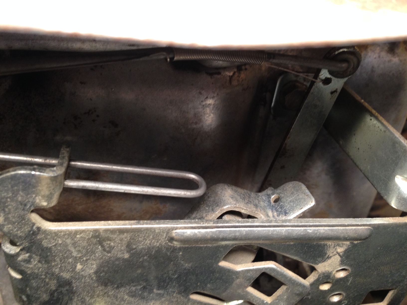

    There was a problem today on my husqvarna cth135 tractor, engine
    B&S 31G777, type 0192 E1, code 120601 ZA, 17.5HP.
    After firing, it immediately goes into high speed, I mark very high, it seems the crank will come out sideways. completely does not respond to throttle levers.
    I took apart the housing to check organoleptically. I think there is a spring missing, can you suggest photos or where should it be? The equipment has not worked normally so far. Maybe someone will see after the photos that something is missing, the equipment is old, maybe something has already flown away. please help me before I have to briggs & stratton 17.5Hp - high speed, does not react to the throttle briggs & stratton 17.5Hp - high speed, does not react to the throttle briggs & stratton 17.5Hp - high speed, does not react to the throttle briggs & stratton 17.5Hp - high speed, does not react to the throttle briggs & stratton 17.5Hp - high speed, does not react to the throttle lug the beasts to the site. Thanks

    If you already have an exposed carburetor engine, check that the throttle linkage is securely in place in a typical location. Remove the air filter and the elbow from the carburetor air inlet side and check in the throat that the intake diaphragm responds to lever movement, i.e. closes / unclogs the air inlet. With the choke flap open, look (down into the carburetor) to see if the "gas" throttle is visible and if it responds to throttle movement. It can be detached from the throttle axis and not respond to the throttle / accelerator pedal, thus revealing the carburetor throat full and causing max. turnover. After all, the engine is already lukewarm and such a fault could occur.

    The damper is functional.
    I manually close the engine, it automatically turns off until it is turned off.
    Yesterday I was on the site after seeing similar engines, and the gas system, links and cables .. I have nothing missing, everything is in place as it should be. The guy said maybe that plastic regulator piece in the engine has broken, and you have to kick the whole engine.

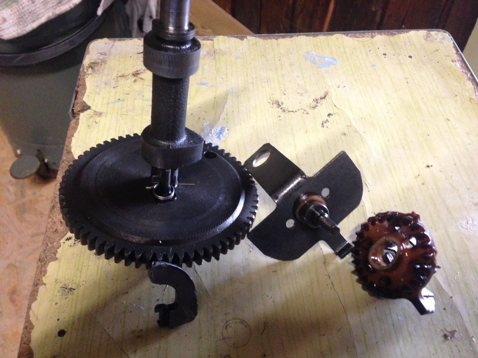

  • #8 16415451
    wolo82
    Posts: 13
    Rate: 13
    So it turned out to be the worst case scenario. The speed controller fell apart and damaged the camshaft.
