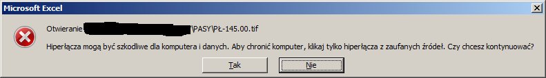

    I have a spreadsheet with a list of drawings in column A, e.g.
    A1: AW-17.00.00
    A2: AW-17.01.00
    A3: AW-17.02.00 etc. ...
    In the place where the EXCEL file is located I have a folder with scans of drawings. The drawing scans are named the same as in the spreadsheet, so
    C: \\ Nowy_folder \ scans \ AW-17.00.00.jpg
    C: \\ Nowy_folder \ scans \ AW-17.01.00.jpg
    C: \\ Nowy_folder \ Scans \ AW-17.02.00.jpg etc. ...
    In the spreadsheet in column B, he would like to create hyperlinks to drawings from the folder C: \\. Yes, I can do it by clicking each time: right mouse - insert hyperlink - and search for a file - ok. But I have these names and files about 5000, there is no tape insertion of hyperlinks?

  • Hyperlinks fail because the file path is built wrong
    #7 16483584
    lanzul
    Level 30  
    Posts: 1023
    Help: 199
    Rate: 123
    kato007 wrote:
    ... Thanks for the reply in favor, but it doesn't work.
    The point is that in column B, I enter the magic reference to the drawing from the folder ... then I grab the cell in column B and drag down, and the hyperlinks are added by themselves taking into account the names from column A and the folder with * .jpg files ...
    'Something' a friend got entangled in a column ' B 'there are unique generic names assigned to a given scan - if the cells start to be dragged here, each subsequent one will have the content of the one from which it was started to' drag '.
    From what I see here it follows that something does not work because the hyperlink gives the wrong path to the file. When it gets organized, it works as a colleague wrote Maciej Gonet
    So let's sort the topic:
    1. The whole 'project' is in some directory - let's assume it's a directory called ' SKANPROJEKT '
    2. Let the catalog above be placed temporarily (for these considerations) in C: \ temp
    3. So the path to it will be - C: \ temp \ Skanprojekt
    4. In the catalog Skanprojekt there is an excel base file called ' SKANY_PASY.xlsx '
    5. In the same catalog Skanprojekt except file SKANY_PASY.xlsx there is also a subdirectory called SCANS for individual scans of documents
    6. Base file SKANY_PASY.xlsx on the tab PASY_1JK in the fourth column, i.e. D 'is to have hyperlinks to document scans for file names placed in individual cells of the column' AND '
    7. Thus, the path for the hyperlink (in column D) to the given scan will be:
    C: \ temp \ Skanprojekt \ scans \ Nazwa_pobrana_z_komórki_kolumny_A & rozszerzenie_pliku_z_katalogu_SKANY
    8. Existingin the base file the hyperlinks don't work, " perhaps "because first they are made for files with extensions' .tif ', not ' .jpg ', and secondly, there is a reference to the directory " BELTS ', not ' SCANS '
     Create Hyperlinks in Excel for 5000+ .jpg Files in Column B Based on Drawing Names in Column Atif.jpg (16.45 kB)You must be logged in to download this attachment.
    9. If all is sorted out, then the hyperlink works
    10. However, from what you can see here, with such a large number of scans (5,000 or more), the formulas in the cells can, although they don't have to, slow down the Excel sheet quite significantly
    11. Maybe time to make a friend kato007 he thought about two simple macro commands: one for creating hyperlinks and the other for removing them?
    12. You only need to make a certain assumption that there is one only directory for the Excel base file and for a subdirectory (eg: Scans), where there are scans of documents with specifically one extension for all files (just for order) - or it finds there are some thematic subdirectories for scan files ... :)

    In a colleague's solution Maciej Gonet there is no "tedious clicking" .... :| ... enter a specific formula into a single cell, and then copy that formula using the gripper located in the lower right corner of that cell, by double clicking. The formula will copy itself to the next break in the column entries.
    Below is the formula that creates the hyperlink he used Maciej Gonet - in a slight modification regarding the content of the hyperlink displayed in the cell:
    Code: text
    " Scans\ "=> Subdirectory with document scans
    Attention here : This entry means that the formula refers to a directory that is located in ' same place 'what the base file in which the "Hyperlink" formula was entered, if it is otherwise, you must provide the entire path to the directory with document scans, e.g. " M: \ archiwum_konstr \! _ ARCHIW_SCANY \ " or " M: \ archiwum_konstr \! _ ARCHIW_SCANY \ POWER \ Szafa_A "
    A2 => The name of the given scan is the same as the file name in the "Scans" directory, but without the file extension (".jpg", ".tif", etc.) - here it is " TUL-145.00 "
    " .jpg "=> File extension of scanned documents
    Above for cell " A2 "gives such a record =>" Scans \ TUL-145.00.jpg "
    Second part of the pattern " A2 & "-" & B2 "gives such a record =>" PŁ-145.00 - Bevel cutter "
