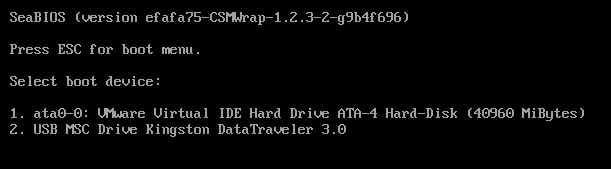

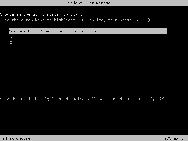

  • UEFI boot test procedure for legacy bootmgr 5472
    #40 21592168
    Gelip
    Level 36  
    Posts: 5249
    Help: 324
    Rate: 612
    You can test under pure UEFI 32-bit or UEFI 64-bit whether Legacy Windows Boot Manager 5472 (bootmgr) will boot:
    • under Windows 7 or later, prepare a flash drive like this (pen no larger than 32GB so that it can be formatted in FAT32):
      diskpart
      list disk
      sel disk x (x to numer pendrive'a - upewnij się iż wybierasz na pewno pendrive'a aby nie skasować dysku twardego!)
      clean
      create par pri
      active
      format fs=fat32 quick label="test"
      exit
    • extract the files from the appropriate archive to the flash drive - if you have UEFI64 then test_x64.zip and if UEFI32 e.g. some tablet with BayTrail then test_ia32.zip .
    • if there is a CSM mode in the bios then disable it - set it to Disabled and disable Secure Boot.
    • boot from this flash drive
    • when SeaBIOS appears and the message Press ESC for boot menu. then press ESC and select the same USB flash drive from the list:
      Windows XP 64-bit & 32-bit: EFI Compatibility, GPT Partitions, Booting & Dual Boot Guide .
    • write if you see such a message:
    • test_ia32.zip (553.98 KB) You must be logged in to download this attachment.
    • test_x64.zip (574.76 KB) You must be logged in to download this attachment.

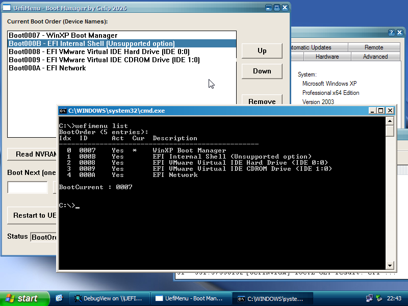

  • UEFI NVRAM boot menu editor for WinXP 64-bit
    #41 21882772
    Gelip
    Level 36  
    Posts: 5249
    Help: 324
    Rate: 612

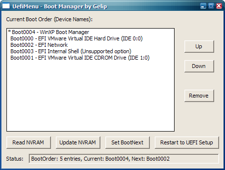

    I am working on a CMD and GUI application for basic UEFI NVRAM BootMenu editing from my modern WinXP 64-bit - it works :-)
    Windows XP screenshot showing UefiMenu boot order editor and a DebugView window with UEFI NVRAM log output Windows XP screenshot: UefiMenu Boot Manager window and cmd.exe showing UEFI BootOrder entries
    You can change the order in the list, remove from the list, set the device from which it will boot once after a reboot and reboot directly into the UEFI BIOS
  • #42 21882866
    sq3evp
    Posts: 6729
    Help: 226
    Rate: 901
    Such soft instances already exist, I can't remember the name, because XP is history.

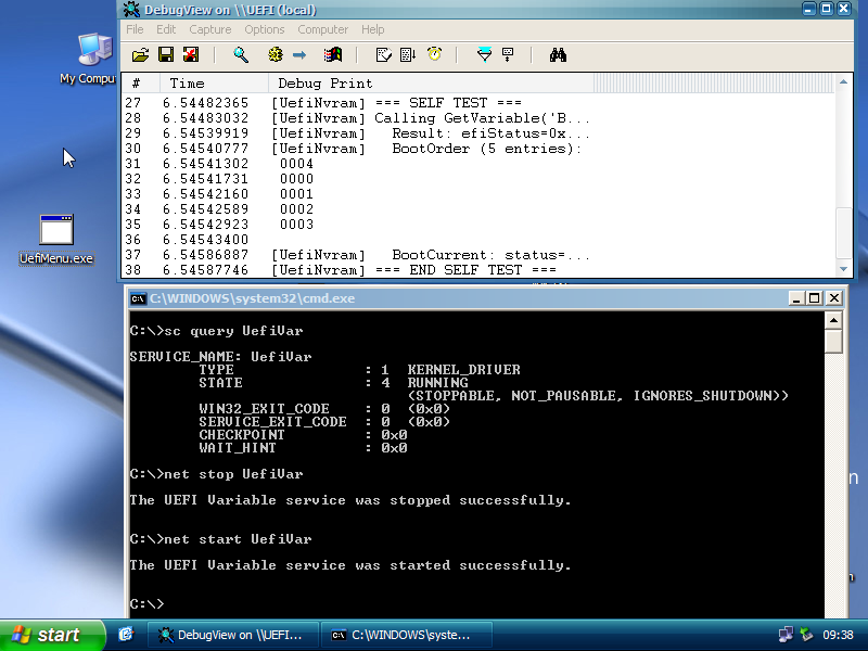

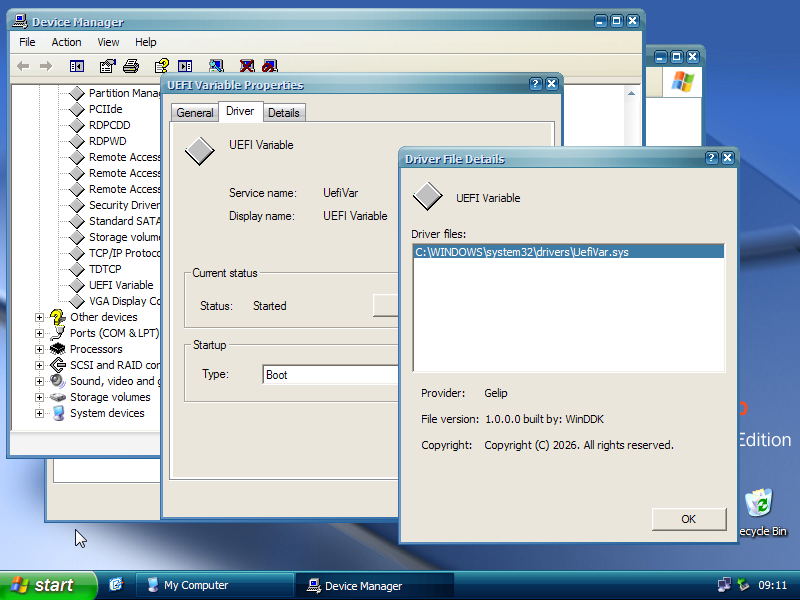

  • UefiVarPoC.sys cannot find ACPI SAVT table in memory
    #43 21882891
    Gelip
    Level 36  
    Posts: 5249
    Help: 324
    Rate: 612
    Cha, cha, cha - good luck with your search. I wonder how such a soft is supposed to work as WinXP 64-bit (amd64) does not officially support UEFI :-)
    These softwares e.g. BootICE (I use to edit the BCD) can only edit the UEFI BootMenu on newer Windows that have official UEFI support. I thought to rewrite BootICE to be able to use also my UefiVar.sys driver but I decided to build a special UefiMenu.exe CMD and GUI application
    My application is working closely with special driver UefiVar.sys and this with special loader SaveRt.efi which publishes the table UEFI RunTime Services - I compiled everything myself and tested it with the help of AI - I am just testing and fine-tuning it on different computers and in a virtual machine and it works elegantly :-) :
    Windows XP 64-bit & 32-bit: EFI Compatibility, GPT Partitions, Booting & Dual Boot Guide Windows XP 64-bit & 32-bit: EFI Compatibility, GPT Partitions, Booting & Dual Boot Guide
    Here as something you have the source code for the SaveRt.efi application and the UefiVar.sys driver - I asked AI about the application but the electrode blocks 5 calls per month so I coped in a different way :-)
    UefiVarPoC.sys does not see the ACPI SAVT table in the registry, how to find it in memory?

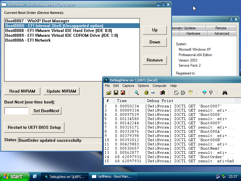

  • SaveRt UI refinements and clickable boot selection
    #45 21888041
    Gelip
    Level 36  
    Posts: 5249
    Help: 324
    Rate: 612
    Work in progress :-)
    - i have shortened to a minimum the information displayed when starting SaveRt
    - changed the Next Boot setting to clickable from the list - previously you had to enter the item number
    - cosmetic changes, smaller window and rearranged buttons
    - added About... in the system menu
    - tahoma 8 font

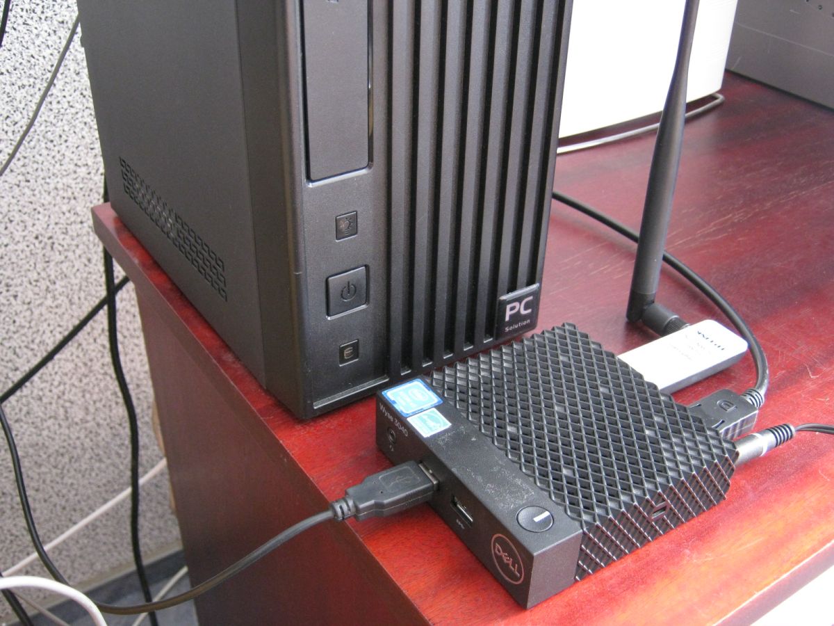

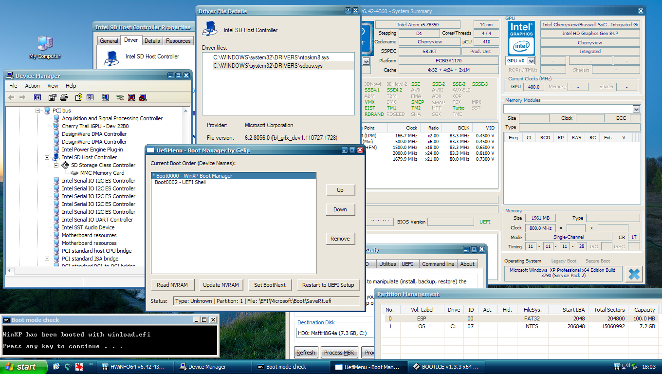

  • XP 64-bit boots on eMMC in UEFI mode
    #46 21920049
    Gelip
    Level 36  
    Posts: 5249
    Help: 324
    Rate: 612
    I’ve had the eMMC drivers ported from Windows 8 to XP for a long time, but it’s only now that I’ve finally found a device with an eMMC drive on which I’ve managed to boot Windows XP 64-bit in UEFI mode without CSM – it’s a Dell Wyse 3040 Cherry Trail – a little box measuring 10x10 cm :-)
    Windows XP screenshot with Device Manager, UefiMenu, and Intel Atom x5-Z8350 system info windows Two computers: a Dell Wyse 3040 mini PC with cables and a larger black tower on a red tabletop
    Here’s a post roughly describing how I managed it: https://www.elektroda.pl/rtvforum/topic4176134.html#21919910
    I’d previously tried this on other computers with eMMC but without success:
    • Asus Transformer T100 with UEFI32 – I was unable to boot the 32-bit version of Windows XP
    • Dell Wyse 5070 Gemini Lake – the system doesn’t recognise the drive – it probably needs to be enabled using a different GPIO driver, which I don’t have for XP
    But I finally proved that it works on eMMC :-)
