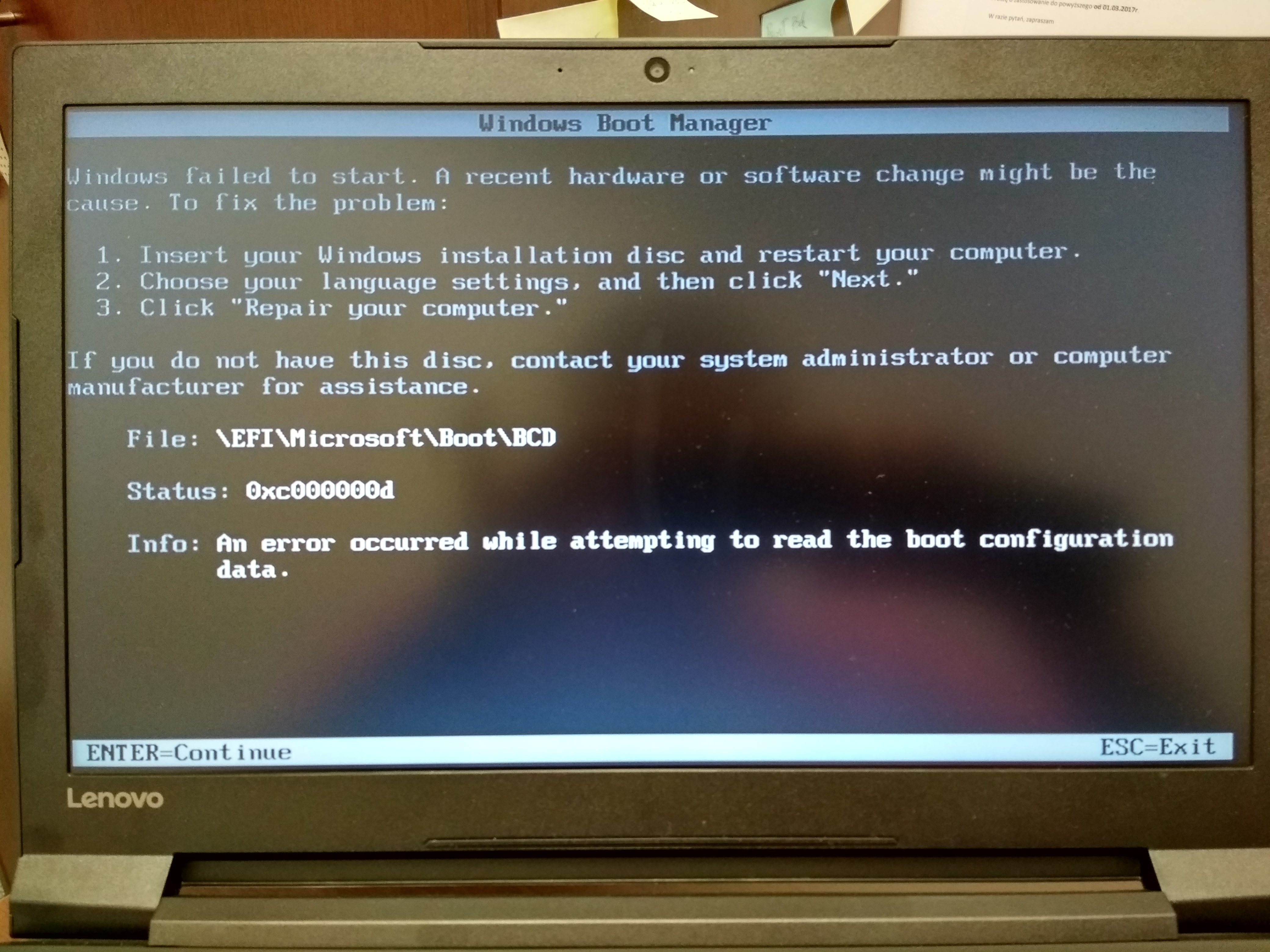

    22.09.2017:
    Today I wanted to install Win7 on the Lenovo Ideapad 700. I threw the Windows 7 tile on the Windows 10 installer, the system installed, asked for a reboot and that's all, then it does not start. Here's the message.

    Problem with Windows Boot Manager not being able to find BCD (when installing the "seven" from the disc from W10), however, results from a slightly different thing - this situation installs because on the system disk, in the ESP partition (i.e. the bootable, normally invisible small FAT32 partition holding only the bootloader and any code decoding the BitLocker encrypted disk) creates is completely mixed up with the confusion - install the bootloader from the installer from "seven" + BCD made by the program called bcdedit.exe from ... Windows 10 (more precisely: from ramdisk unpacked by decimal WinPE). Of course, the BCD backward compatibility with WBM is one-sided (the newer WBM will read the older BCD, not the other way around, and here we have the opposite) - hence the expected message about the inability to read BCD.
