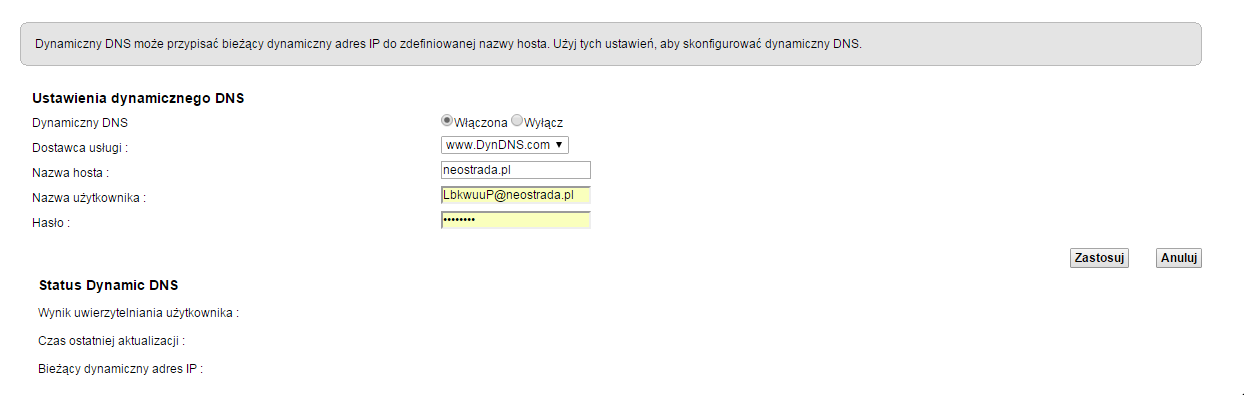

    I bought a DSL router in the store. After connecting to the network and setting DNS, I still do not have internet connection. I have set dynamic DNS.
    In the ss attachments from the configuration.
    This field configures the DDNS service and not the internet connection. You should enter the neostrada login in the configuration of the PPPoA connection
    ps
    VPI 0
    VCI 35
    VC-MUX

    Exactly. you do not enter parameters here.
    Do you have access to the admin account?
    What login and password do you log in?
    You will not do this from the "user" level.
