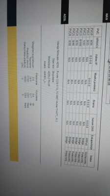

    Hello. I have an Internet connection with Orange. After resetting the router I can not connect to the internet, when I turn on the network diagnostics I get an error the DNS server is not responding. In the DNS settings I tried to set 8.8.8.8 and 8.8.4.4 and leave it for automatic but it did not have any effect. I also used flushdns, I repeatedly reset the computer without any effect. I called the hotline, but today only the machine works and nothing helped. What to do? I have internet access after the cable [Orange] DNS Server Not Responding: Connection Issues after Router Reset (8.8.8.8, 8.8.4.4)
    No internet connection configured.
    Log in to http://192.168.1.1/ and enter your login and password to connect to the internet.

    Log in to the router and insert the screen from the status tab. It's about the WAN table and the line status at the bottom.

    Added after 45 [seconds]:

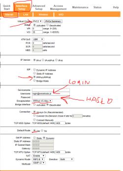

    No connection configured:
    Set like on the screen:
    You should have a login and password in the contract for Neostrada

    Login and password entered, I clicked save ... And now what? Reset and diagnostics did not give me anything unless I entered the wrong password

    show the status tab again
  • #11 17380442
    Heinzek
    Posts: 3732
    Help: 554
    Rate: 494
    Rewrite data for PVC0. Polish firmware has a different layout.
  • #12 17380462
    Willyff
    Posts: 14
    Rate: 8
    Thank you very much, it works. I really admire the willingness to help because of the time and day of the week.
