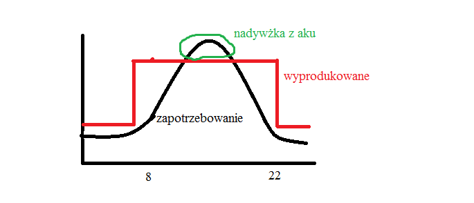

    I need help with solar calculations. Namely, I write a paper on the creation of a photovoltaic power plant with a battery system to compensate for energy. Unfortunately, I only mentioned something about solar farm at the university and I admit that I don't feel well about this topic. The idea is for a 100kW power plant to constantly give the same amount of energy produced per day and here comes the first question how much will such a kWh power plant produce per day? I installed 400 250W panels, does it mean that counting for winter will be 400kWh and for summer 600kWh assuming 4h and 6h work? How to create hourly characteristics assuming that the energy demand is between 8-22: 00 and e.g. the peak at 12-14 will be additionally compensated by batteries? And how to choose the capacity of batteries for this purpose? Most installations found by me have simply given some parameters but unfortunately there are no formulas given for their calculation, which I need or I don't know how to find them, I also count on the help of more experienced people in this field.

    Assumption wrong - you can't do it this way. Solar power plant with buffer in the form of batteries cannot supply nominal power, irrespective of insolation conditions etc. Physically impossible. If the power plant is to have a continuous power of 100 kW, the power of the panels must be much higher, so as to enable power compensation by accumulator batteries. In other words, the power plant must be able to produce surplus electricity under good conditions to be able to give away the surplus when the sun goes down.

    Under the worst-case scenario - you assume that the sunshine is so weak on a given day that almost 100% of the energy must be covered with panels. So if the daily consumption is max. 500 kWh - that's the capacity you need to choose a battery.

    This is exactly what you wrote so much that the power of the panels should be 100kW. And from this I have to choose the real value to receive at a more or less constant level (I do not know how to calculate this value)
    Hourly characteristics of the variable demand for energy during the day, which, say, reaches a peak at 13:00 to the energy produced by the power plant using a buffer if it is needed for compensation, as in the picture.

    For me, this is a completely wrong assumption. Energy production in a PV farm in Poland is so extremely uneven that it makes no sense to make a constant capacity assumption throughout the year. Because if you make such an assumption, you will have to reduce the power to the efficiency that the farm will have in winter. So in the summer the power plant will waste its potential.
    This must be broken down separately into summer and separately into winter and only for these two completely different periods choose the installation parameters. Otherwise I don't see any sense in it.
