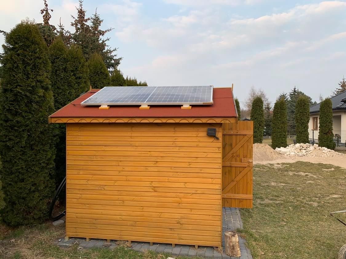

    after many months of analysis, reading various topics on the forum and drawing conclusions, I managed to fulfill my little dream, which was to build a (partially) independent, automatically controlled OFF-GRID photovoltaic installation :)
    My assumptions were as follows:
    - supplying energy from PV panels during the day to receivers operating during the day (power supply for pumps and heating controls, cameras, alarm, modems, recuperation, fridge ...) - total power consumption is 200-250W
    - storing surplus energy in batteries to be able to use it on cloudy days
    - automatic switching of specific circuits between PV and the power industry, if no electricity flows from the PV installation
    My installation consists of:
    - 2 Longi panels with a power of 440W one
    - Epever Tracer 4210AN charging controller
    - AGM batteries operating in a 24v system with a total capacity of 1.4kWh
    - 3000W pure sine inverter (1500W continuous power)
    - fuses, measuring devices, etc...
    - double-circuit relay switching circuits between photovoltaics and the power grid
    The installation consists of 2 Longi panels with a power of 440W each, mounted on a woodshed in the east-west directions:

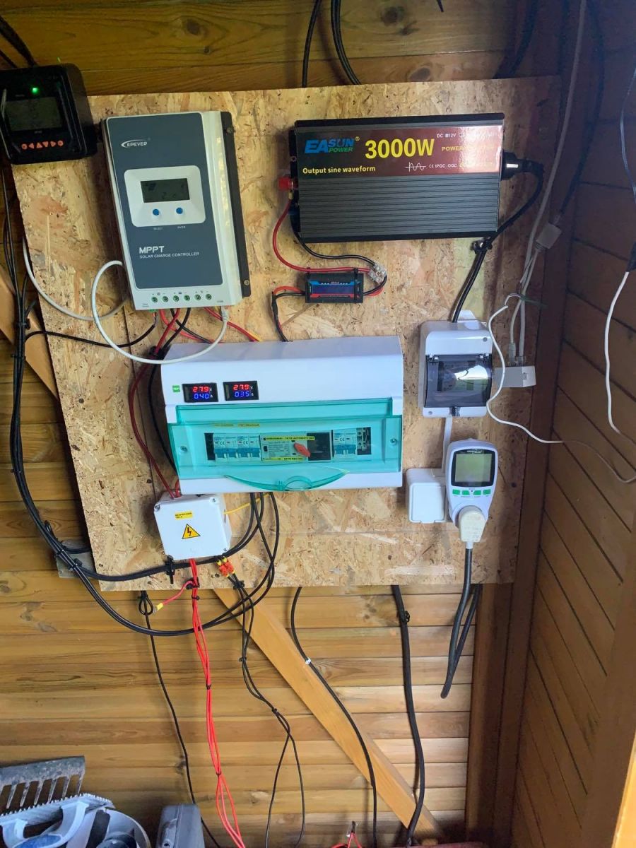

    My OFF-GRID 880W installation in a single-family house - independent of the ener
    Everything is handled in my little command center :) Of course, I used the appropriate safeguards:
    From here, the current goes to the switchgear in a single-family house, where it controls a relay that switches specific circuits of receivers to power from photovoltaics (if the voltage from my "power plant" flows), instead of the power grid. Similarly, if my home "power plant" is not working, it is automatically switched to power from the power grid.
    I plan to replace the batteries with LifePo4 from China with a total capacity of 2.4 kWh :)
    So far, the system works great, unfortunately I am not able to store the entire surplus of electricity, because so far I consume about 1.2 kWh / day, taking into account that for the protection of the batteries, an automatic device is set to provide voltage to the house only in the hours of 7: 00 - 18:00. After replacing the batteries, I plan to power the house 24/7 with PV.

  • #2 19439632
    ADB-6
    with this kit?
  • #3 19439636
    Kubik26
    ADB-6 wrote:
    with this kit?
    Exactly :) Power consumption by the above-mentioned circuits is about 200-250W.

    Why on the shed and not on the apartment building? What about batteries in winter?
  • #5 19439717
    Kubik26
    For me, installing panels on the roof of a new house is aesthetic barbarism :)
    In winter, I plan to insulate the battery, or put it in the ground, similarly to road power.

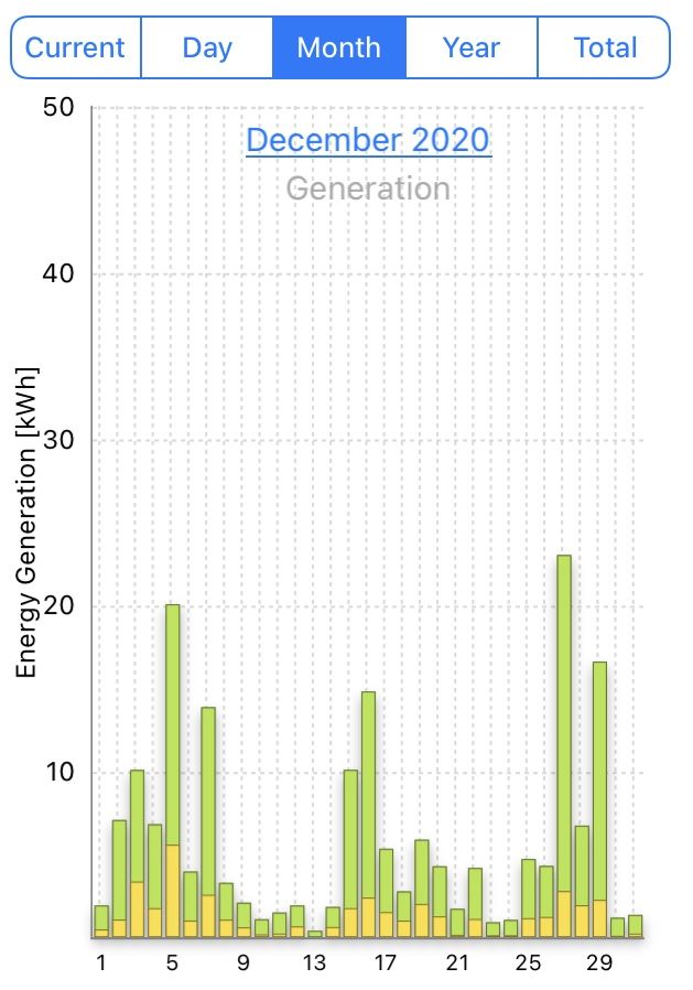

    Leon444
    Level 26  
    My fixed ZE costs per year are PLN 100.
    Make the whole house on OFFGrid, then we'll talk. For now, you've made installations for a small crib, survive the winter on this offgrid and we'll talk next year ?
    God forbid I don't criticize you for your performance and willingness but life is not Netflix and we live in Poland, not in sunny California ?
    December / January there is practically no sun and it's like Akku dies, I know because I experienced it myself and also at the beginning I thought about offgrid everything but luckily I cured myself ?

    Leon444
    Level 26  
    @anaba255 are you sure you have 3kW installations? Is it 30kW? Because I have over 10kW and in December it was bad and often below 3kWh and sometimes below 1kWh.
    And this is December alone, but where is November, January and February? Which this year was also very, very bad.

    Leon444
    Level 26  
    I have panels at a different angle, but the vast majority are at about 30 degrees, the rest are different, e.g. 40 degrees 2.4 kW, with 9 kW to the south and the rest to the west.
    As you can see on the chart (I have these charts from several years), the entire production for December is less than two good days in May.
    That's why offgrid makes no sense in our climate...
    In December, every now and then I had to charge the Akku from the network and in May / June at 12 noon the panels did not work because the Akku was charged.
    I miss a nice saving in the winter and in the summer 70% of energy goes to the "whistle"

In summer, yes: 880 W of panels can supply 4–5 kWh/day, enough to cover 1.2 kWh demand and recharge storage [Elektroda, Kubik26, post #19439597] Winter output in Poland can drop below 0.4 kWh/day for this array, so grid backup or an auxiliary source is required [Elektroda, cysiekw, post #20326590]
Why mount the modules on a woodshed, not the new roof?
The author calls rooftop mounting “aesthetic barbarism” and prefers the shed’s unobtrusive look [Elektroda, Kubik26, post #19439717] A low roof also eases cleaning, snow removal and future expansion.

Is mounting on wood safe from fire?
Components are screwed to plexiglass, conduct only 44 V DC, and are fused, minimizing arc risk [Elektroda, Kubik26, post #19541333] Still, metal enclosures and conduit lower insurance premiums and meet IEC 60364-7-712 guidelines PV-Safe.
How do I wire an automatic AC change-over?
  1. Feed inverter AC output to the common poles of a 2-pole, 230 V relay.
  2. Wire grid power to the normally-closed contacts; connect the protected circuits to the normally-open side.
  3. Use the battery-positive via a fuse to energize the relay only when voltage > 28 V (24 V system). This three-step swap mirrors the author’s setup [Elektroda, Kubik26, post #19439597]
