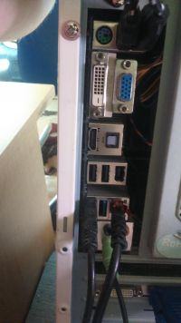

    Please post a picture of the outputs of this card.

    Connecting Philips 40PFH4101/88 TV to PC with Nvidia GeForce 9800 GT, HDMI & VGA Options
    Added after 3 [minutes]:

    There should be a setting in the BIOS settings to disable the integrated card.
    Please make sure it is set to "Disabled" or "Off".

    It is quite possible that you connect the TV to the HDMI socket of a dedicated graphics card, and you have integrated graphics card enabled in the BIOS.
    What's your computer motherboard anyway?
