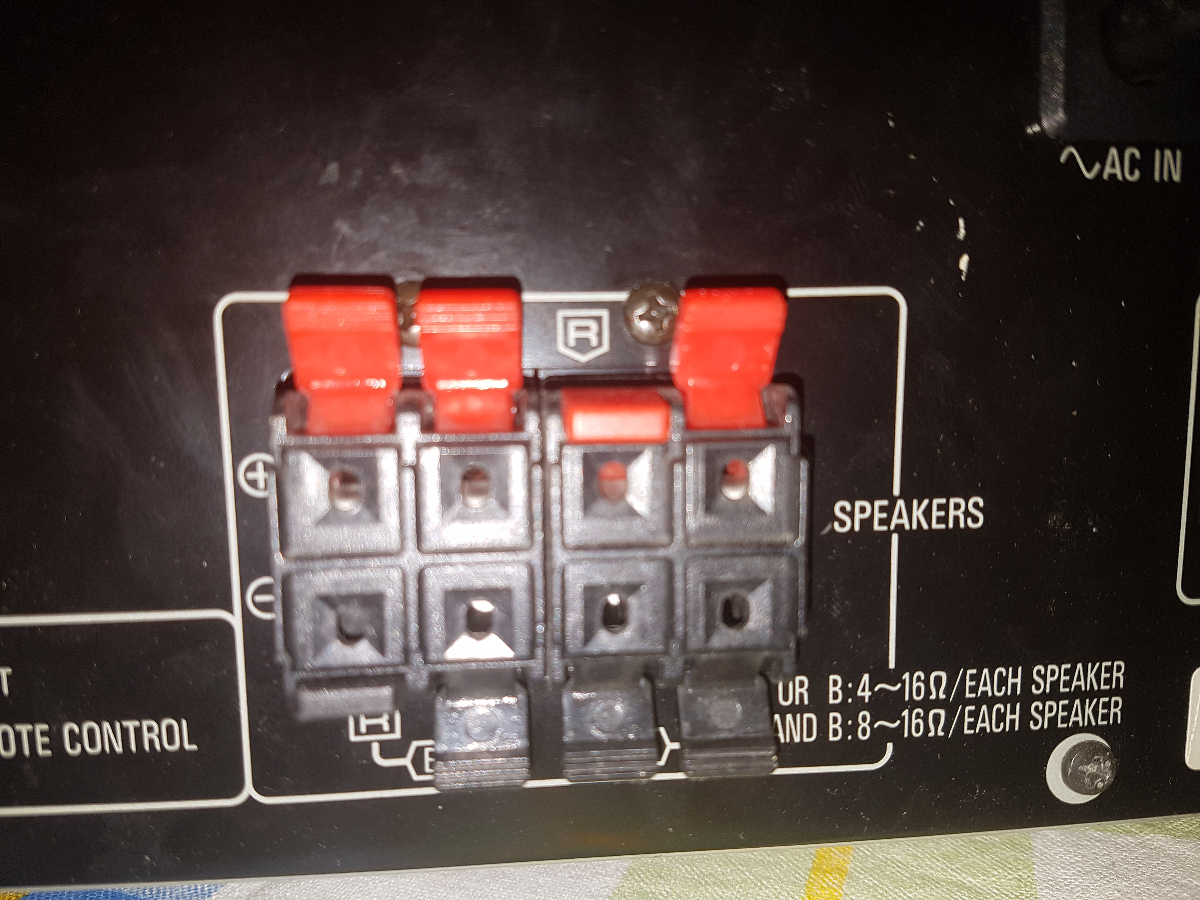

    Hello. I have 2 Pioneer loudspeakers with a power of 40 W each and 2 Tonsil Altus 110. I also have a Pioneer SA GX-100 receiver, in which there is a 40 W amplifier per channel. Can I connect all 4 columns to this receiver? I mean A + B channels. The receiver writes A + B / 8-16 Ohm, A or B / 4-16 Ohm.

    2 columns 8 ohm give 4 ohm? 2 pairs? The outputs are in the attachment

    Buddy, the receiver has two amplifiers (left / right channel)
    Each of these amplifiers can be loaded with a loudspeaker with the resultant resistance of 4?.
    If you connect two 8? columns to one channel, it will output 4? per channel.
