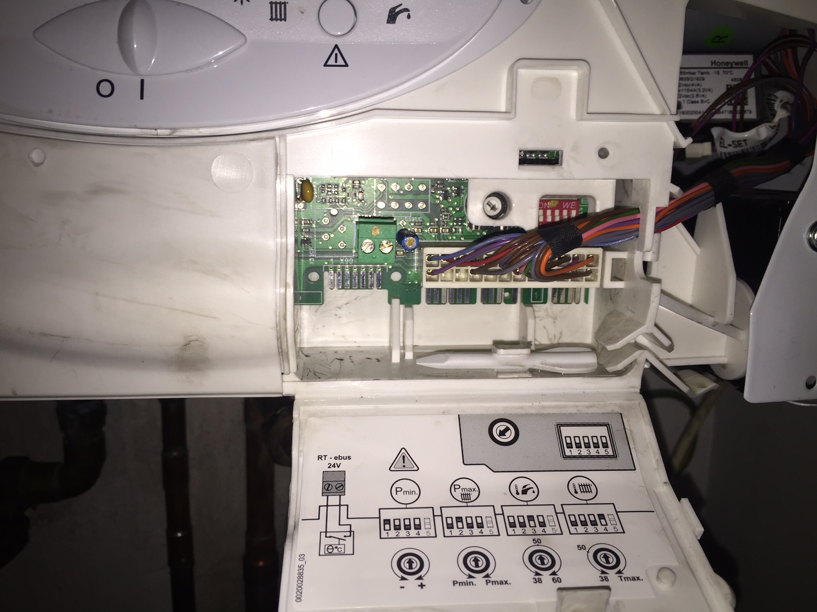

    I have a problem with the Saunier Duval Semia F21 stove.
    Namely, it is about hot water

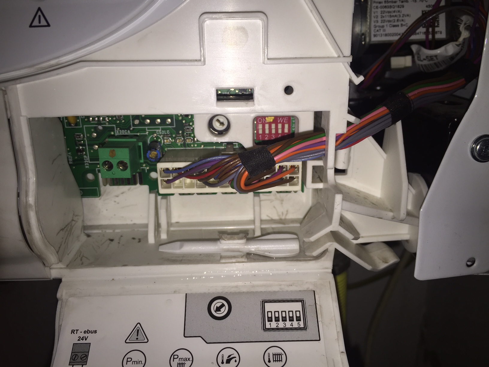

    If I set the hot water knob vertically, i.e. on ECO, in front of the red field, I have very hot water, not hot, if I set the knob for 2-3 hours, the water is slightly less hot than before.
    Please tell me because I don't know what the settings of these switches should look like in the upper right corner (red rectangle). I would like to add that from the left, four are down and the fifth is up.
    I don't understand this instruction below. How it should be?
    Saunier Duval Semia F21: Adjusting DHW Temperature (ECO mode) & Upper Right Corner Switches Saunier Duval Semia F21: Adjusting DHW Temperature (ECO mode) & Upper Right Corner Switches
    Added after 11 [minutes]:
    I just found the manual on the network and point 7.3 says it, I understand that I have to set the switch No. 3 down, then set the temperature with the potentiometer to a higher temperature, and then turn the switch No. 3 down?

    As you write: switch 3 up; 1,2,4 down; 5 doesn't matter - and then you set the temperature with the knob
