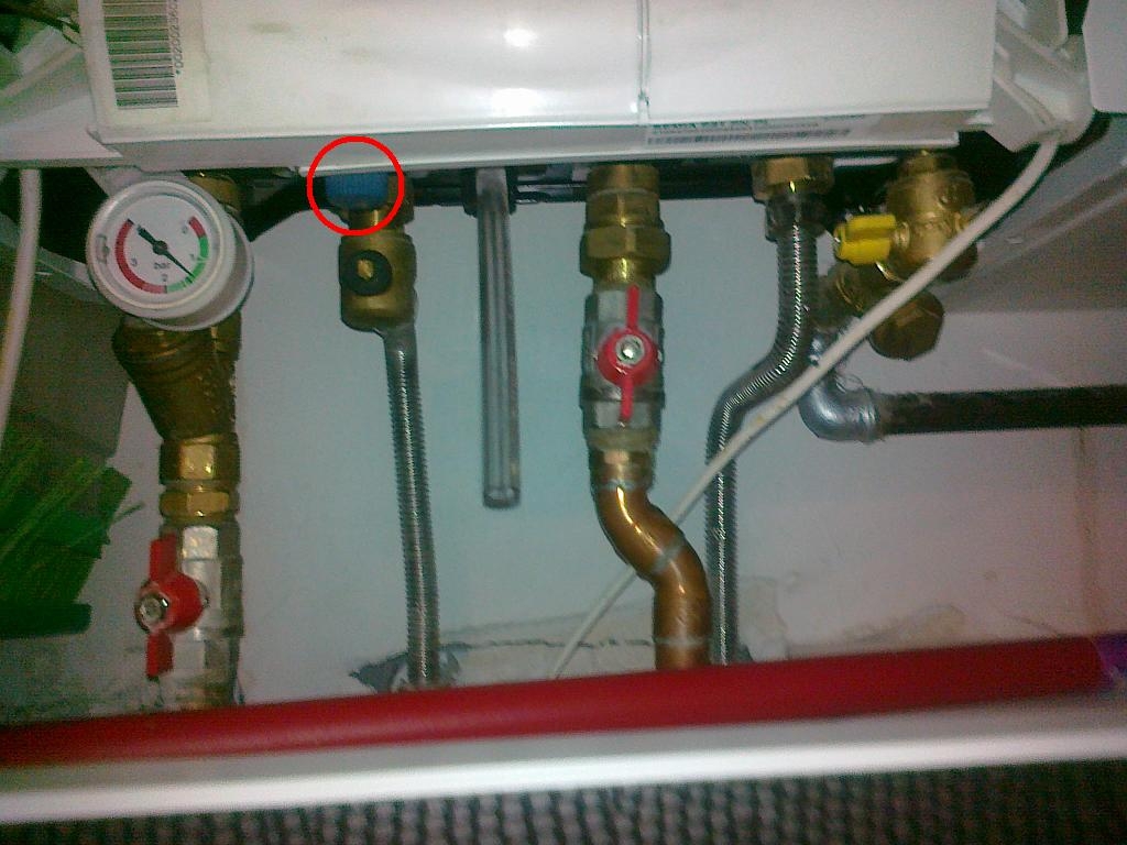

    I moved into a flat that is heated by the saunier duval semia boiler. The pressure in the circuit is low so when venting radiators, it will drop more.
    Can somebody tell me how water is coming to the cycle because unfortunately I didn't get much out of the instruction manual. I only located the valve with the cotter pin.
    I am asking for some tips because I am a complete layman in this topic.
    Best regards.

    Have you read the instructions? Page 12. Description of item 21

    The first thing is a manual - just as a colleague wrote earlier.
    Here you can see where the water filling valve for central heating is - the one with the blue knob:
    Saunier Duval Semia Boiler: Low Pressure & Filling Circuit, Tips for Venting Radiators Saunier Duval Semia Boiler: Low Pressure & Filling Circuit, Tips for Venting Radiators

    Hello, what about when after using the water supply valve nothing happens and the bars do not increase.
    Replacement valve?
    If so, can you do it yourself?

    And then cold water (domestic water) is fed into the boiler? Maybe it's somewhere crazy before?
    With this filling valve, anything can happen - it may not unscrew, but it may also not turn off and tap water all the time ;-)
