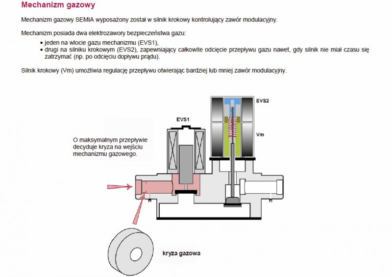

    I have a problem with the boiler as in the topic. It started when the boiler stopped turning on, i.e. it made an attempt in accordance with the diagram on page 23 of the appendix, but after the third unsuccessful attempt, it gave up, signaling it by the flashing red diode signaling the failure. This was the case during the attempt to start the central heating and hot water. Both the reset and the shutdown did not bring any changes, but until then, because when the next attempt was made, he started working and worked properly for almost a day. Unfortunately, it now works in such a way that when it is turned on, it starts up, heats both in the central heating circuit and domestic hot water, but only until the set central heating temperature or until the domestic hot water is turned off, and then it goes into failure mode. Another inclusion and the whole cycle repeats itself. What seems important to me during the transition from the operating mode (yellow LED) to the failure mode, you can hear a characteristic knock, but I suspect that it is caused by the protection on the gas valve. The only question is, what could it be caused by? Voltage loss on the valve? Rather not, since after turning on the hot water, it heats up until the water is turned off, regardless of whether I turn the water off after 30 seconds. Is after a minute.

    The problem was solved not cheaply, because for PLN 800 with the exchange, the only question was for how long and the cause was the gas mechanism.
    Saunier Duval Semia F21 Boiler Failure: Troubleshooting Start-Up, Heating & Hot Water Issues
    The one in the photo was removed from the boiler and in a moment I will check where the problem is. Seizure, stepper motor or maybe some more prosaic reason like an electromagnet, what the service technician suggested? By the way, I do not understand this policy, that when one element of the whole fails, everything must be replaced, because when the relay in the car is lost, the entire board of relays is replaced immediately? Or, when the stepper motor fails, the entire throttle is replaced immediately? For security reasons, this cannot be explained, but I don't want to dwell on it anymore.

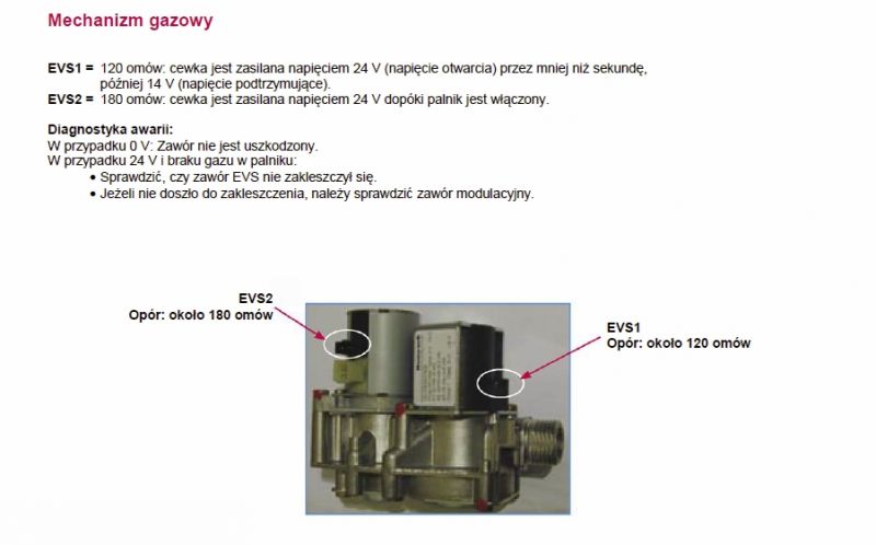

    The reason turned out to be trivial, the mechanism simply crashed. It's hard to say how and where it is, because after dismantling and inspection, I put it back together and it works (checked in a different boiler). It is a pity and I regret that, instead of looking for the cause or causes, they are limited to replacing the entire modules, which is associated with high costs for the user.
    Someone will say safety, etc., but for the user's safety, is the entire engine in the car replaced immediately, or is it just what it takes for the engine to be operational again? It is such a digression, but returning to the topic, it once again turned out that what was "broken and replaced" turned out to be functional differently and could be brought back to life at a low cost.

    As a service technician, I have repaired the motherboard more than once, but I have installed a gas valve that freezes ... once it did not open, the second time it may not close ....

    And what does the Semia, Semia C24 and Semia F21 training manual say about this?

    This is why the mechanism has two gas safety solenoid valves so that, in the event of a failure, the second one takes over its functions, which is clearly described by the manufacturer when diagnosing the failure. A new valve can also get jammed at any time and in any position, because it is only a mechanical part.
    Aside from the mechanical part, in such a bathroom stove as PG 6, once installed quite commonly in blocks for heating water in both bathrooms and kitchens, there was no security. It was enough that the spire in the water unit was seized and instead of retracting after the water pressure dropped under the membrane, it did not do it, and then ... And then the stove, instead of going out, was burning until it boiled water and boom. However, I do not remember any meches replacing the entire water unit with a new one then? Not only that, there were also those who treated the needles with grease that would "slip".
    Well, the old times were different and the approach to everything was different, which does not mean that it was better, because there are no jokes with gas and electricity, and you should be aware of what and how you do it.
    Moderated By piracik:
    I treat the advice as harmful.
    The fact that there are two valves does not mean that it is possible to use a gas unit with one faulty valve.

    You have mistaken repairing with diagnostics. The training materials teach how to make sure that the problem is in the gas unit. In order not to replace the working one with a new one.
    If the valve has crashed, it means that it is out of order. These are the first signs of trouble. You have a wish, mount it to a friend and stay awake at night because maybe sirens will wail somewhere.
