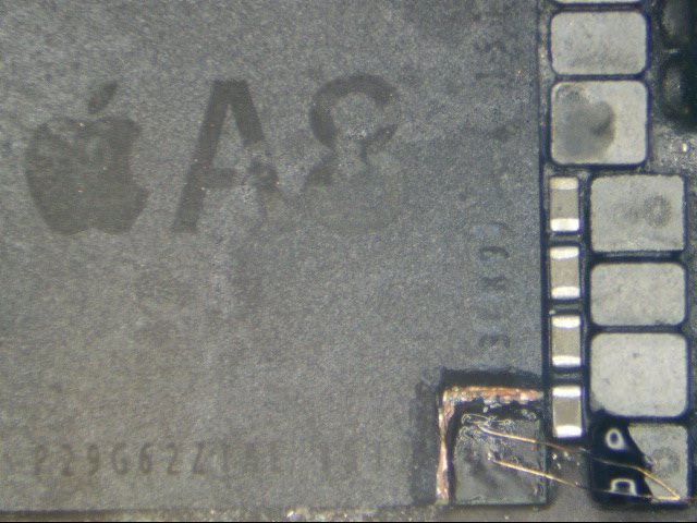

    iPhone 6, original USB cable, latest iTunes. When you try to recover (hangs on the iTunes logo with the cable) a progress bar appears, the phone reboots and an error pops up 9. I've sold the disk and it's still the same. I missed ideas ...

    After reballing the nand, the progress bar on the screen still appears and the error is black screen and the phone is immediately detectable in DFU?
    For the tristar substitution
    to reprogram / substitute nand
    it can also be a CPU problem.

  • #4 16502989
    conrad9210
    Level 26  
    Posts: 909
    Help: 83
    Rate: 210
    Hi, replace / shed U0301 ONSEMI EEPROM, after replacing the necessary soft with DFU.

    I am waiting for the part, ordered. Very small is ... How far does a colleague bet that it is?

    gsmowiec
    User under supervision
    Posts: 552
    Help: 27
    Rate: 128
    I bet on cpu for 90%.
    Most of this type of error, which supposedly suggests damage to nandu, comes from the cpu.
    Anyway, you could simply eeprom solder or check resistances and not immediately issue 10E.
    Sam, I have a play somewhere in which I have crossed out and then exchanged eprom, tristar and a new programmed nand, and the album still falls into error 9.
    So a little bit different from the subject - can someone to prock a Prock?

    Without the microscope unrealistic

    Hello! 80% of cases are damaged nand ... 10% epprom and the rest is not connecting to eprom. But all these defects can be repaired. The last option requires a lot of time and skills but can be repaired without any problem. I am in possession of a similar cnc machine but in this case it is not needed for anything :D

    cnc does not give anything in this case :D cpu must be removed without damaging it :D

    I would like to clean up and incriminate myself, and the latter is impossible at least for me.
    CNC is useful for iphone as well as this crappy programmer - once in a thousand times.
    Fortunately, I managed to sell it :D

    Nand falls 1 in 10, and in the case of errors after reprogramming and reball CPU or RAM CPU or playback of the CPU-eeprom connection remains.
