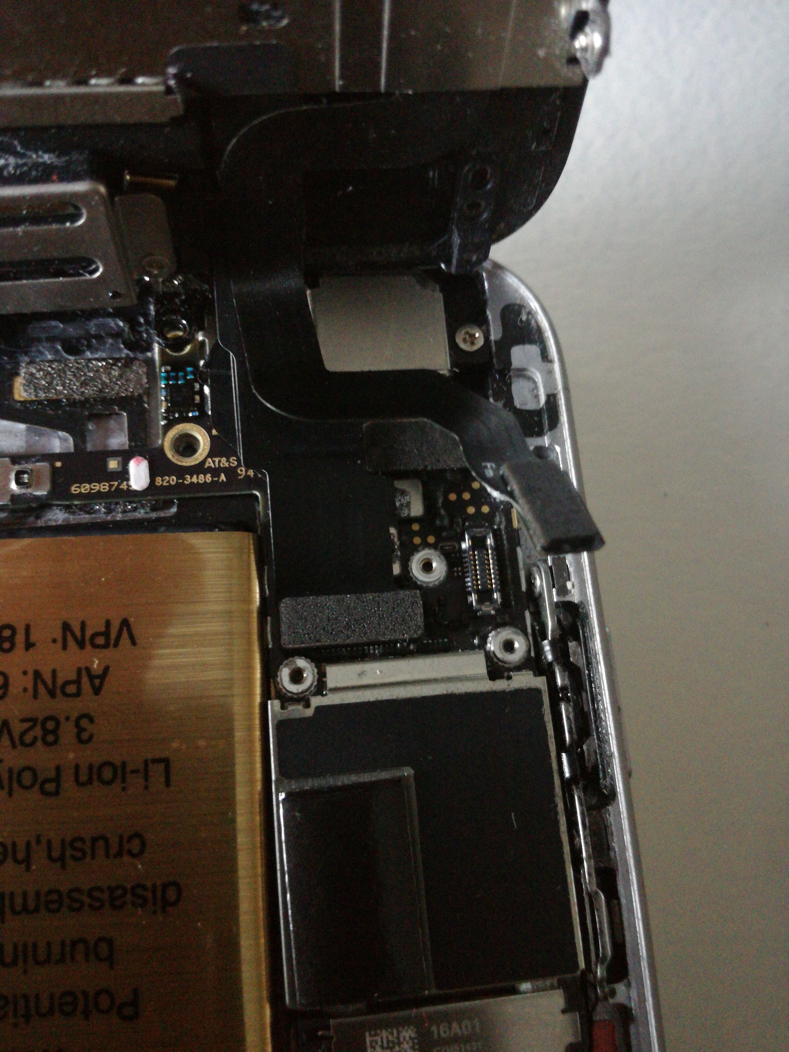

    Hello, I got an iphone 6 which allegedly turned off and did not want to turn on, and so it is. The first inspection the phone was not dismantled, the computer sometimes detects it but the phone died, no reaction. But this morning I tried to run it and after 30 sec showed up 3 times the apple went out and that's it, again dead. What's the problem and where to start? Is this a software problem? Regards

    Generally, I'm still learning so I have to understand it. How do you open the phone in dfu mode? And what kind of device to check the power consumption. I have 3 iphone 6 in the house so I checked on 3 batteries, one of them stronger, and on 3 displays.

    People have another information, warmed the plate lightly with a hot air gun and the phone resurrected, started normal to the start screen and then went out and again it could not be run so I warmed it up again and again worked for a few seconds. Now without heating once every 10 times will turn to apple and goes out.
    What is going on?

    I tried to start the phone without the screen tape connected, the side thin, then the phone normally works and does not turn off, I plugged it on the phone switched on and the phone is still working for 10 minutes. Can I fix it?
    Added after 5 [minutes]:
    However, not entirely with the cable, which I described, does not turn on and without switching on iPhone 6 Troubleshooting: Apple Logo Appears 3 Times, Phone Dies - Software or Hardware Issue?
    Added after 12 [minutes]:
    What is the tape unpinned from?

    From the home button. When you bend the display with the tape attached, you will break it.
    I also see that you have some tacky Chinese batteries installed.

    I know, but it's just for testing, I've got it on the market, but let's get back to the problem.
    Why does not I want to turn on when I string this tape?
    Because it's broken ;)
    Short circuit, flooding, mechanical damage.
