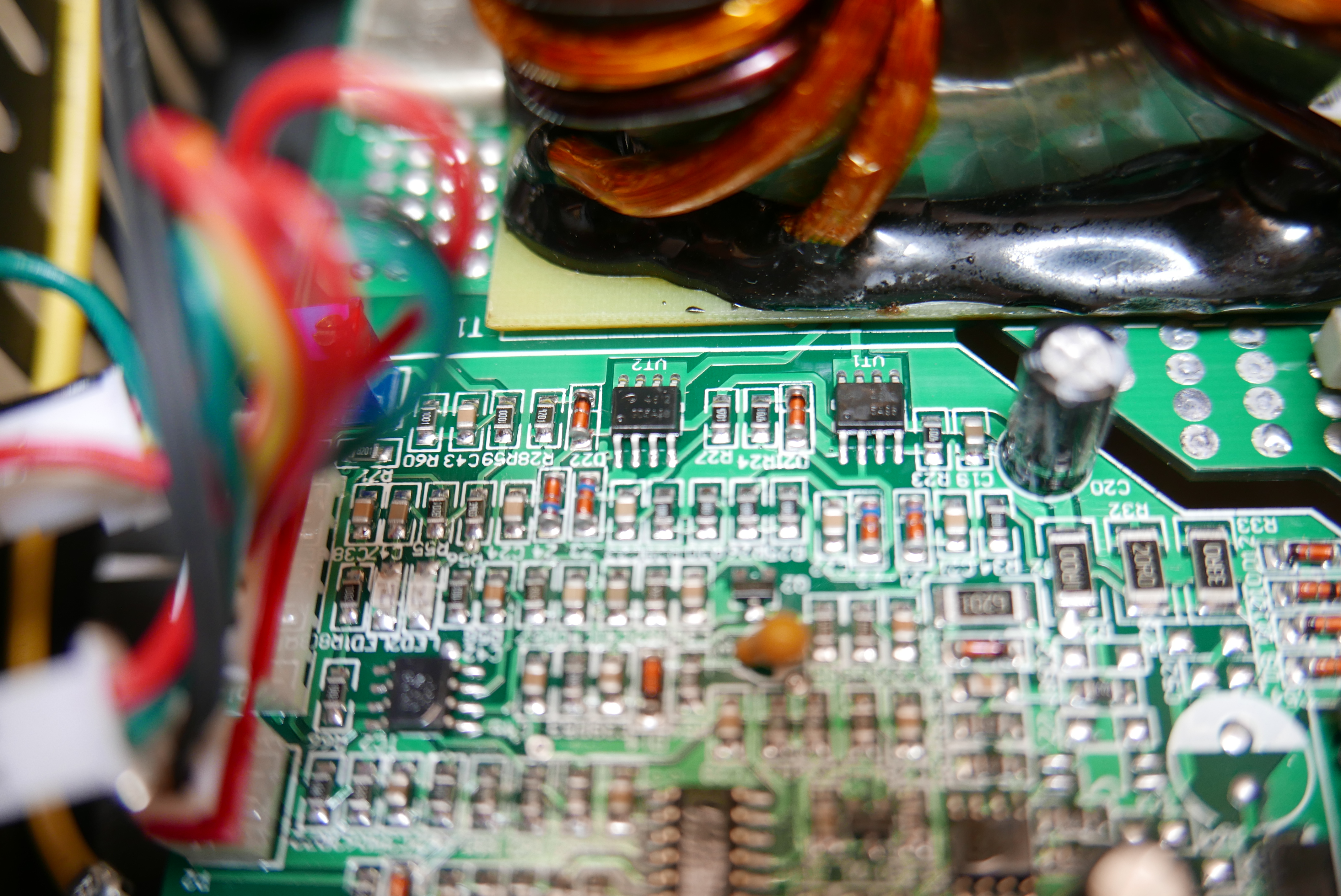

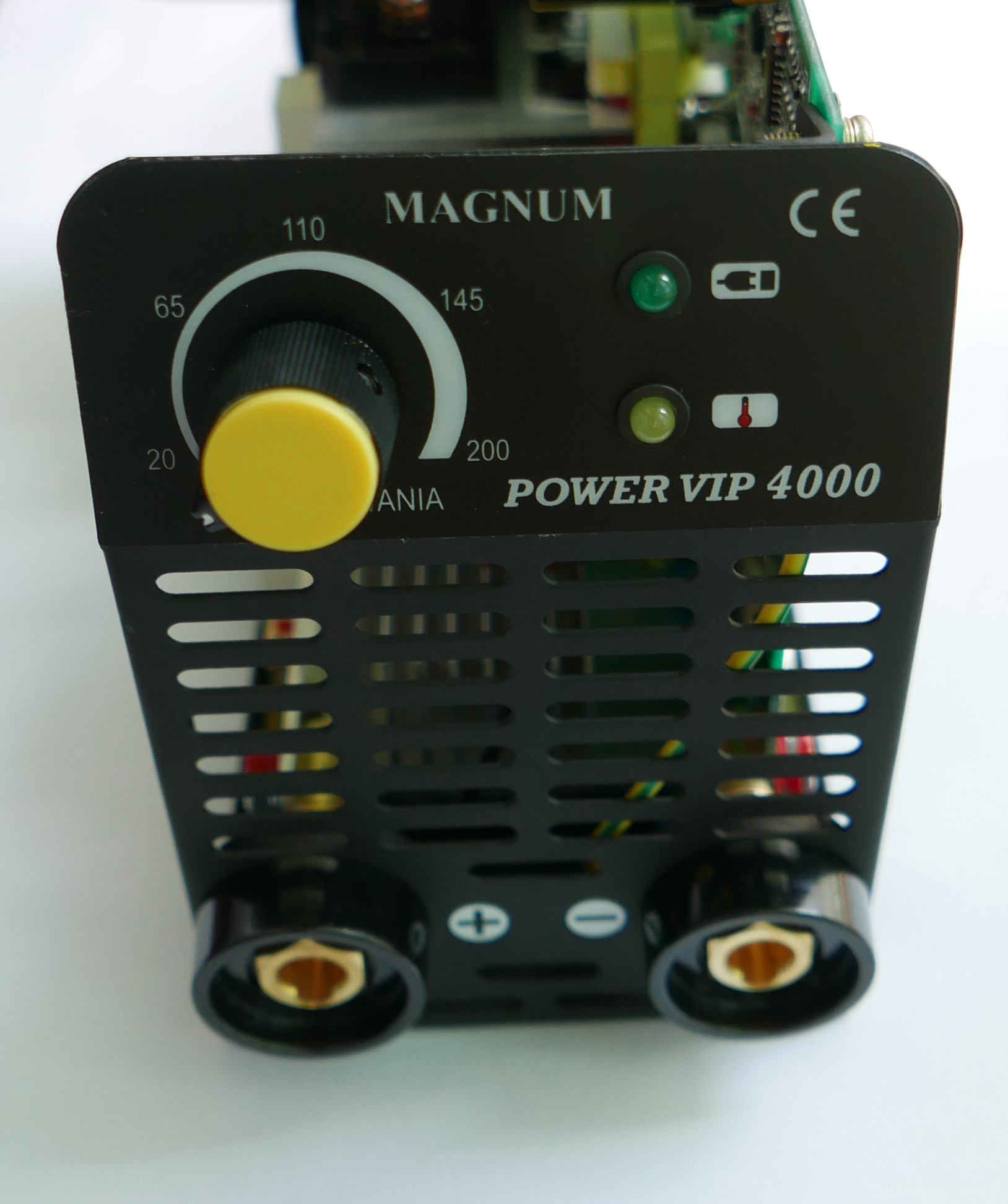

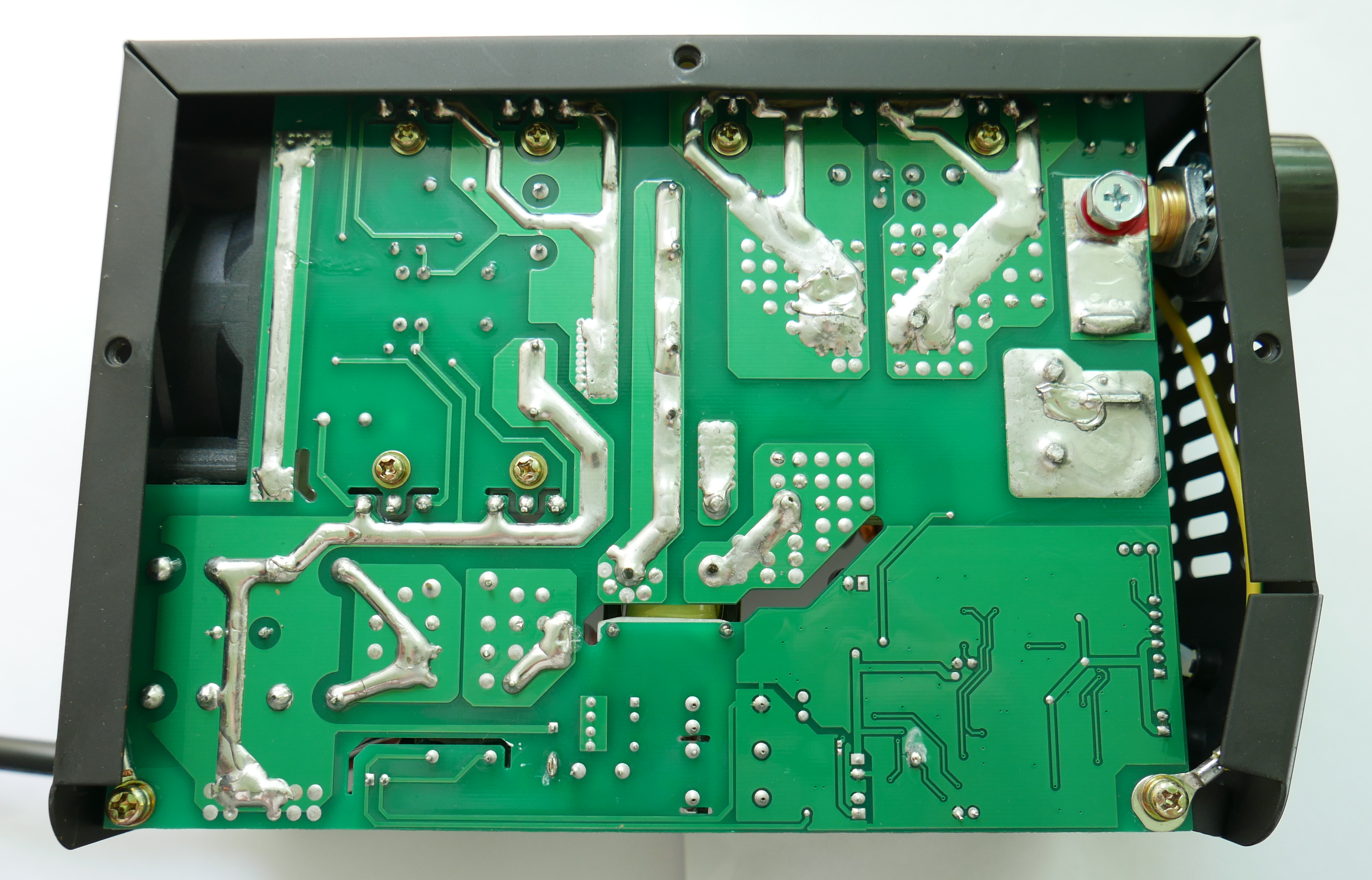

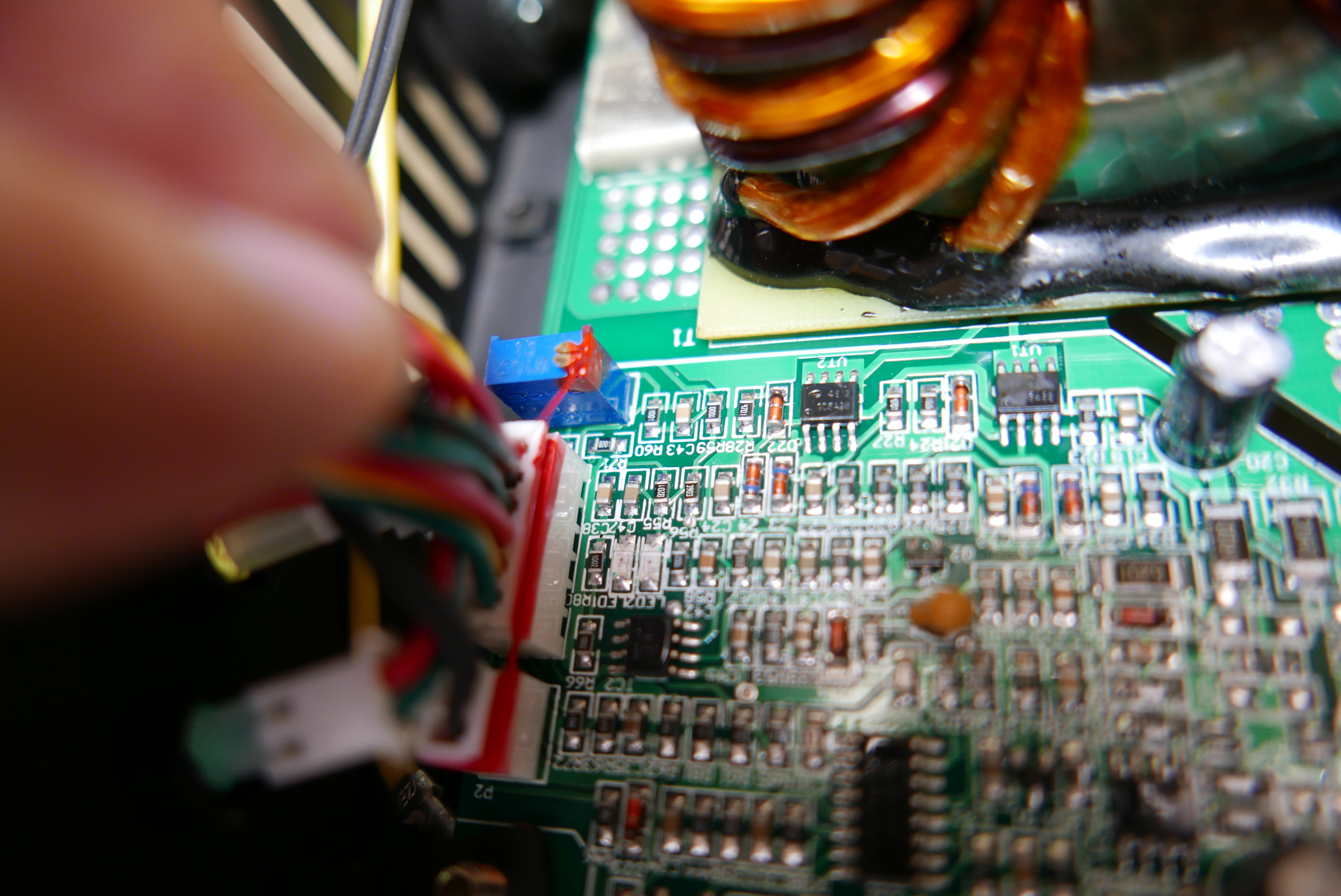

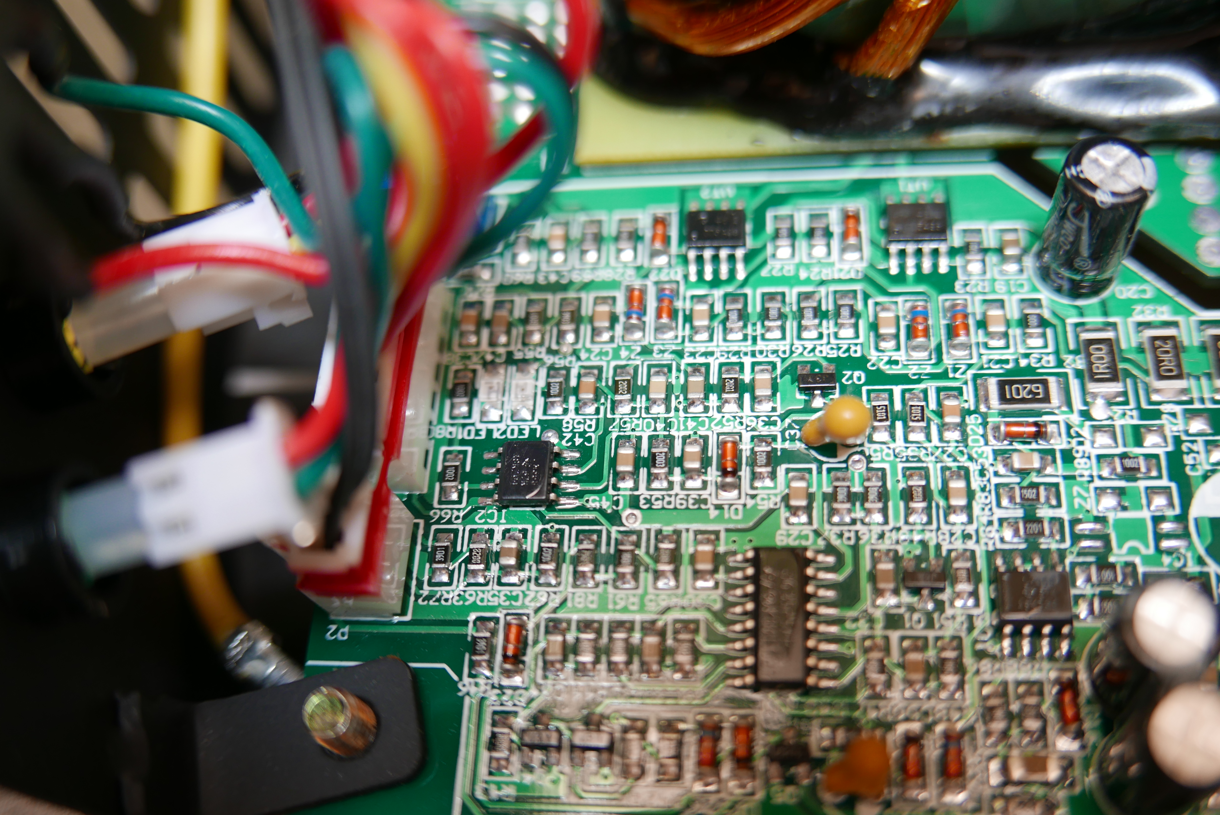

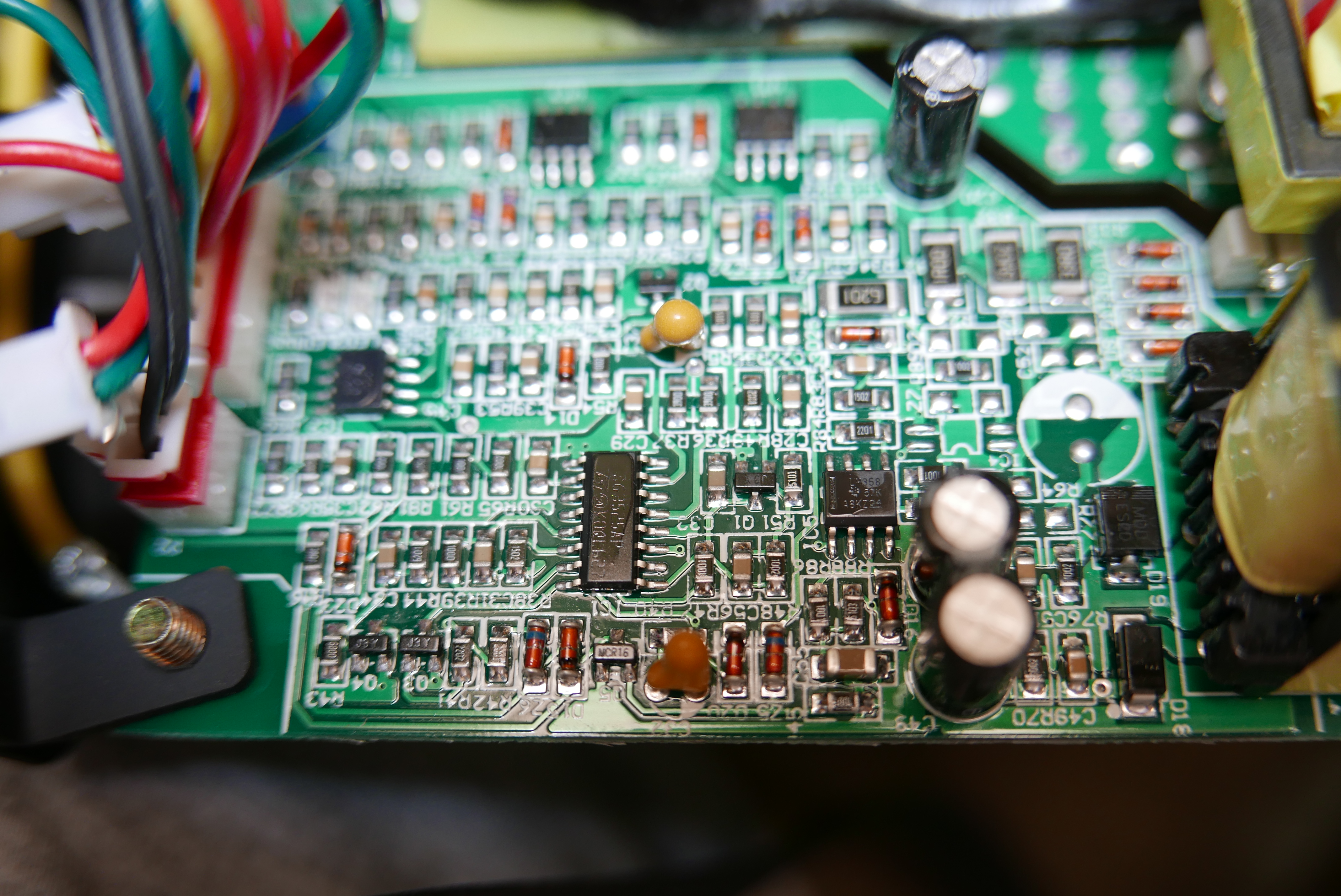

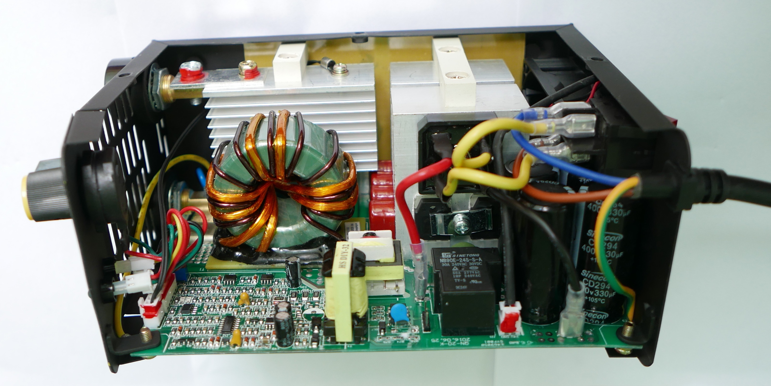

    I took photos of the entrails of the welder, maybe someone will be useful.

    Absolutely not suitable for workshop use, only amateur. Toto overheats in flight. After all, the efficiency of the welding inverter is circa 0.75
    In this case, the heat sinks must be drained slightly counting kilowatt heat when welding with a 3.25 electrode.

    I think that for 3 years the technique has gone ahead and you can buy something better at this price. I would not give her PLN 500 now. PLN 250 MAX.
    Secondly, I doubt that what they currently sell as VIP 4000 has the same inside as in 2017. After all, it's Chinese equipment.

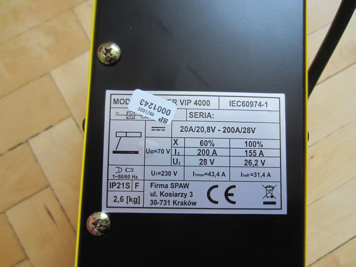

    I will add from myself that I also bought this welder. Below I attach photos of the rating plate as well as the mass holders and electrode.
    Magnum Power VIP 4000 - Internal Components Photos Magnum Power VIP 4000 - Internal Components Photos
    My copy gives an open circuit voltage of 61.5V (measured with an electronic multimeter). The wires are actually 25mm? in copper braided (I think so), i.e. the braid looks like it was made of copper, but after a slight scraping of the surface with a knife you can see inside an aluminum color. The fan is not that loud at all. It is arranged so that it blows air from outside to inside; heated air escapes from the front and sides.
    The welding machine has not yet been tested so concretely, I used three electrodes to practice welding: 2.5 mm rutile electrode. Welding was easy (or at least I thought so) with a current somewhere between 70 and 80A. Protection (so-called "eski") with counters I have C25 and B16 welding circuit. During these tests, no fuse disconnected. I am very beginner in the field of welding, so I can not give any more details at the moment, but I hope that this welder is enough for my small needs - I suspect that I will weld with max 3.2mm electrodes.
    My copy bought in April 2020 looks exactly the same as in your photos.
