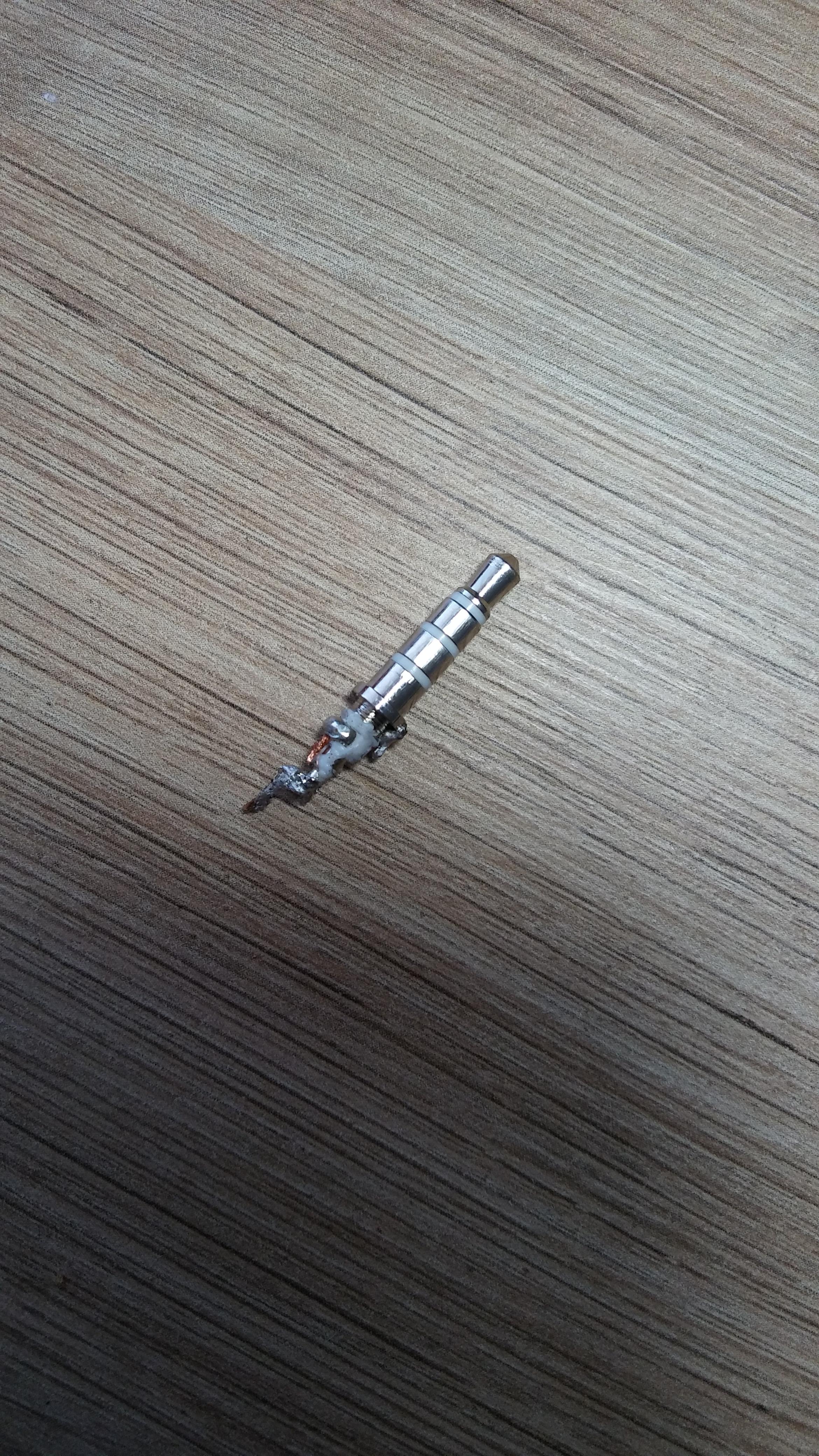

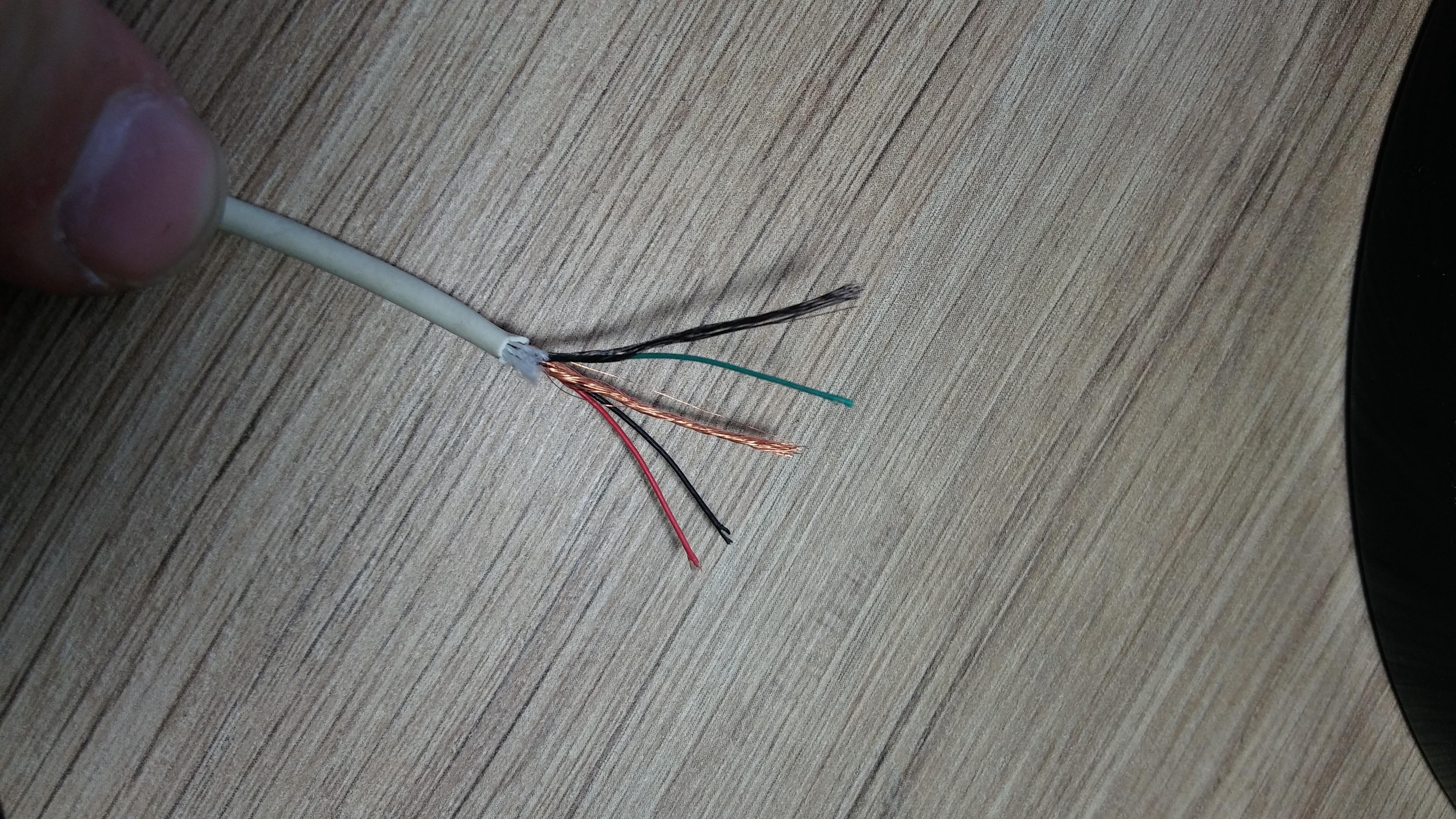

    I would like to fix my headphones which broke at the mini jack connector.
    Unfortunately, nowhere can I find a scheme that would suit me to these wires. Could you help me with this? Thank you in advance and best regards.

    The green braided is a microphone, red and black in the common braid are headphones (L and R channels you need to check. Connection depending on the type of device:
    Soldering Broken Headphones: Fix 3.5mm Mini Jack Connector with Suitable Wiring Scheme
    Soldering Broken Headphones: Fix 3.5mm Mini Jack Connector with Suitable Wiring Scheme Soldering Broken Headphones: Fix 3.5mm Mini Jack Connector with Suitable Wiring Scheme Soldering Broken Headphones: Fix 3.5mm Mini Jack Connector with Suitable Wiring Scheme Soldering Broken Headphones: Fix 3.5mm Mini Jack Connector with Suitable Wiring Scheme Soldering Broken Headphones: Fix 3.5mm Mini Jack Connector with Suitable Wiring Scheme
    Easy everything is available online, just 3 minutes to find.
    If in doubt, ask.
  • #3 16504932
    JakCzap
    Thank you very much. I do not know why but I could not find it anywhere.
