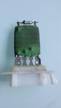

    Can anyone answer the question what values have a thermal fuse on the resistor / resistor at the blower motor in the Mercedes W245 year 2007. I wanted to replace the same fuse, but the inscriptions on it have completely illegible - someone wise bridged this connection to me by effectively flooding the inscriptions with tin.
    Please help.
    Mercedes B-class W245 blower resistor thermal fuse - parameters

    These fuses respond to overtemperature. 80-90 degrees should be around It costs 2 zlotys. Since it burned, it is possible that the blower itself is abrasive and causes heating of the resistors much more than is foreseen.

    Or a collapsed cabin filter ...

    Well, I bought a fuse worth 10A 184 degrees C, 250V.
    It could be soldered, it works until today (over a year).
    Still for clarification, regarding the entry of the mouthpiece, the blower caused overheating and burning of the fuse - due to moisture the area around the engine was rusty (thorough rust removal, cleaning, lubrication was necessary).
