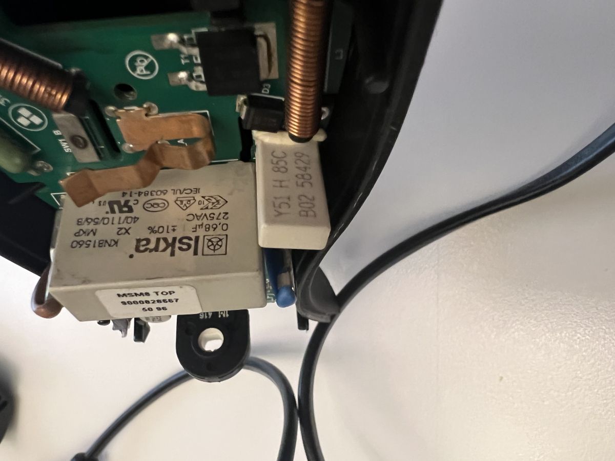

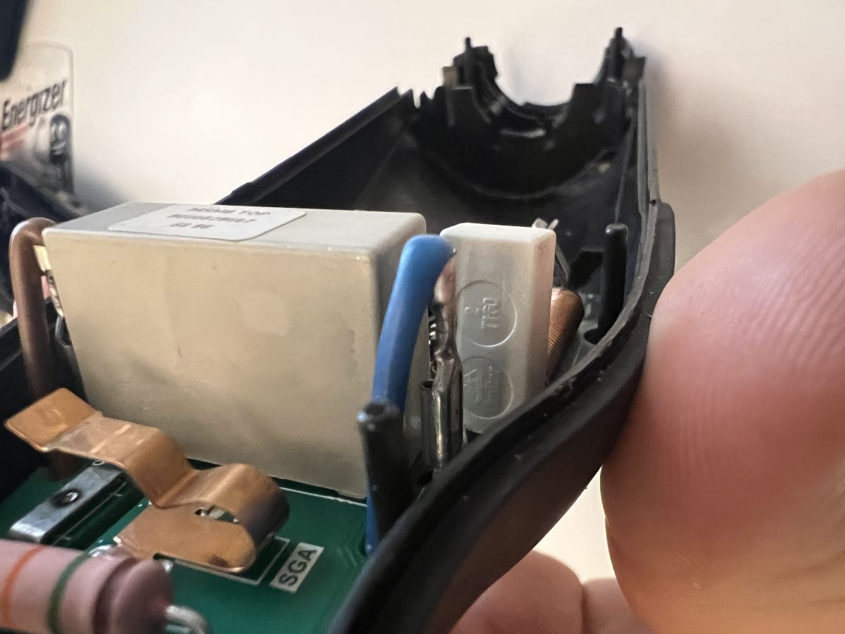

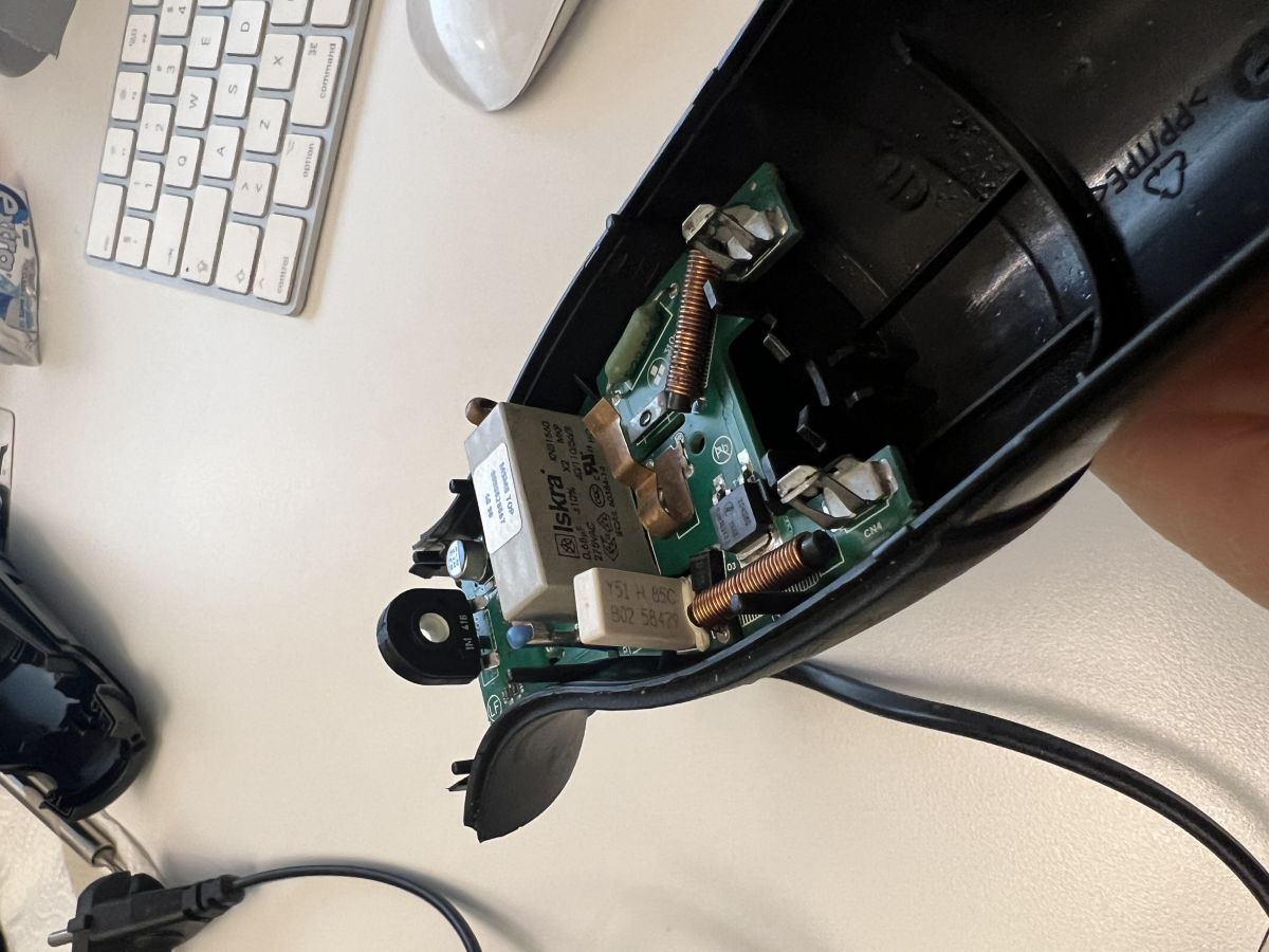

    Trying to fix a Bosch MaxoMixx 800w that stopped working during mixing of some way too hard butter :D
    E-nr:
    I've replaced the motor, but it is still dead..
    Found this thread: https://www.elektroda.com/rtvforum/topic3478119.html , and I suspect it might be the thermal fuse in my case as well...
    My fuse is labeled "2 TI60" (or TIG0?) on the back, and "Y51 H 85C B02 58429" on the back.. (different from the one in the link above) - but can I still use a 5A/120°C thermal fuse to replace it??
    I have absolutely no clue on what to look for/buy - so if someone could point me in the right direction I would be very thankful!
    (Live in Norway, so if anyone knows what to buy and where to buy it - please help!)

  • #3 21328089
    JoChM
    Thanks @ 78db78 ! But I don't get the part about measuring a gap? I assume you mean measuring where the fault is - but I have no skills in doing this.. How do I do it?
  • #4 21328629
    gulson
    System Administrator
    Posts: 29512
    Help: 150
    Rate: 6114
    The point is, have you also measured the thermal fuse that you know is faulty? Translations from English to Polish sometimes come out differently.
  • #5 21581688
    JoChM
    MacGyver'd that shit!
