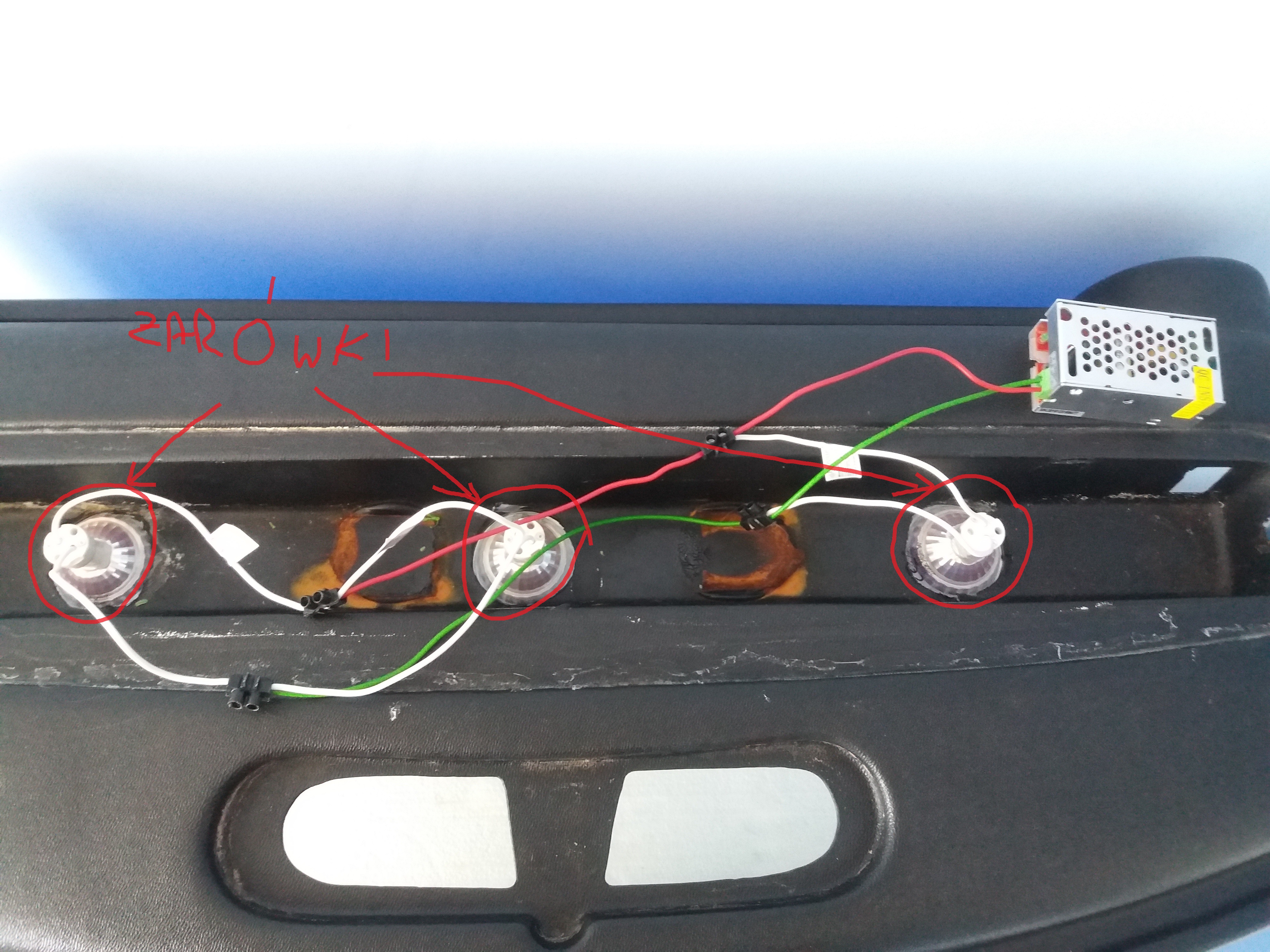

    After connecting the whole system and turning on the bulbs instead of lighting they blink. I don't know why this is happening and maybe someone knows how to deal with this problem?

  • #8 16508517
    blackwolf7
    Posts: 32
    Rate: 11
    I wanted to upload photos, but the site does not want to load me ... so I will describe
    The power supply's power is at the output of 15W, while the bulbs have 5W each. If I turn on one bulb and then each one in turn, they glow normally. However, if three are turned on, they blink.

    The power supply works on its power edge - buy / replace with a stronger one.
    And four "light bulbs" ... so not on the edge of the power supply, but an overloaded power supply. In this case, the power supply "samples" - gives voltage to the LED, states that the current is too high, so it turns off and after a while checks again if something in the load has not changed - over and over again.
    And as for the "Lord of Castorama" - he was apparently convinced that the customer can count, and that customers usually buy a spare lamp - ... :)
    Something wrong with counting :) there are three, but the power supply is overloaded - it should be 20W.

    Yes lamps ... and 25W for 3 LED lamps it's still not enough, that is enough for only two, but in this case I leave two glowing.
    Thanks for helping me solve my problem, it's all over.
