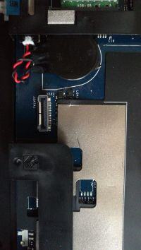

    Will the new latituda 5580 fit a m.2 drive + a normal 2.5 "sata drive? It's best if this space for WWAN does not take up ...
    the instruction on the della website in this regard is unclear to me.
    if someone had such a paw, I will be grateful for looking under the housing :)

  • #6 16519783
    luzak34
    Posts: 54
    Rate: 17
    Board Language: polish
    before I asked it, of course, I looked through the manual ... but as you probably noticed, there are no HDD pictures .. (only m.2)
    anyway the catch is here today, quite nice and it looks like room for a 2.5 "disk would be found ..
    even the JSATA1 connector is not used, I just need to find the part number to change it to the usual SATA :)

  • #7 16532386
    luzak34
    Posts: 54
    Rate: 17
    Okay, an additional disk can be connected, just buy part CN-04G9GN
    Dell Latitude 5580: Can it Accommodate Both M.2 and 2.5 SATA Drives Concurrently?
    Unfortunately, I haven't found my pockets yet, but when inserted "loose" it does not fly around the housing. I connected a 2.5 "320GB disc and it works great
    edit:
    pocket is part: 06F7DD
