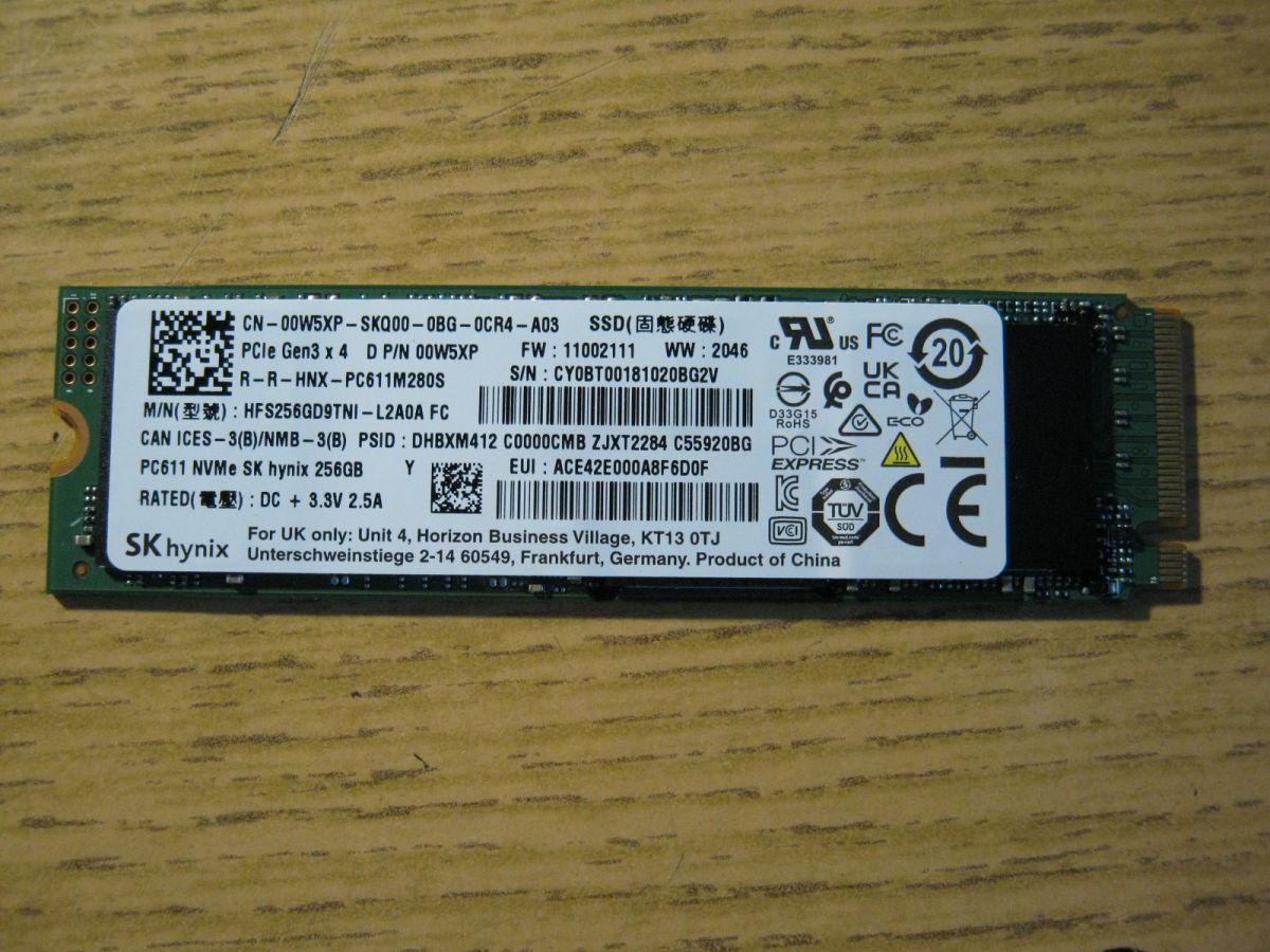

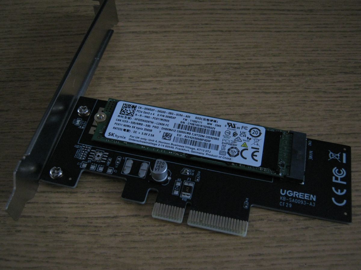

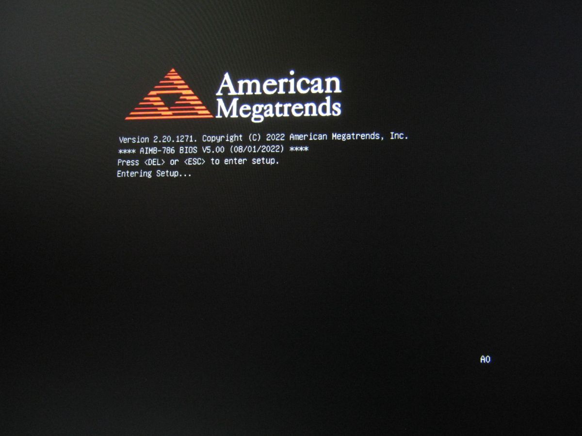

    The drive may be cool, but you recommended the seller to me for h... - Not only did he send the wrong type of drive - NVMe instead of M2 SATA - but it was 99% defective because I checked two different computers in which I currently have NVMe drives - I took out my drives to check the one I bought. In one the computer hangs on Enterning is BIOS screen and nothing can be done. In another, the bios doesn't see the drive at all:
    Recommended M.2 SATA SSD Brands for Dell Wyse 5070 J5005: 500GB vs 1TB Recommended M.2 SATA SSD Brands for Dell Wyse 5070 J5005: 500GB vs 1TB Recommended M.2 SATA SSD Brands for Dell Wyse 5070 J5005: 500GB vs 1TB Recommended M.2 SATA SSD Brands for Dell Wyse 5070 J5005: 500GB vs 1TB Recommended M.2 SATA SSD Brands for Dell Wyse 5070 J5005: 500GB vs 1TB .
    I made the return, got the cash back but without it and without the disk I was about a week.
    When I notified about the bad shipment of course the info that we apologise - quote: "there must have been a packing mistake".
    After exchanging several messages I received this - and I quote:
    "I checked today, if I had such disks , I would have sent you , but we ran out ...".
    Well, what do you mean we are out of stock, if there was a mistake in packing, does that mean that the right disc from the auction title is there and is lying unsent?
    What a crock - the guy is selling goods that he does not have in stock. This disk was simply not in stock at the time of purchase and he sent me the first one he had on hand.
