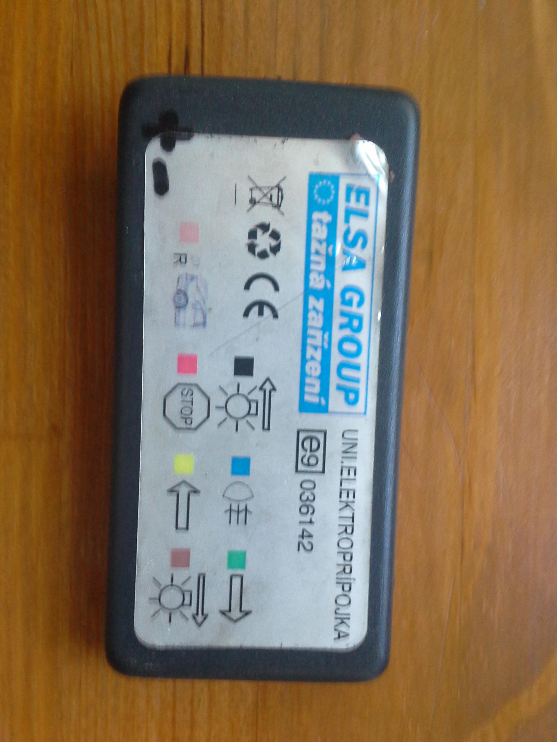

    I have a module for a trailer, I do not know if it is broken, I can not connect it. The pictures show the name.
    I picked up the following
    3 pin-left cube +. Middle and right -.
    Inputs from the installation to the smaller cube from the right, the output to the hook of the middle slot.
    In this way, the connection does not work.
    I do not know what to do with the two bolted top of the tile on the left, or should something join them?
    It is true.
    Exactly the opposite.

    I slowed provisionally according to your advice and I have on the first four 0.6V pins on the output pins, and on the next three 4.8 V. Pwinno be 12V.

    Master, where is the load of the bulb / bulbs? After all, take the catalog data of these two scalpers and read ...
    I connected the 21w bulb and only the 2 and 4 pins are on, the remaining 5 pins are not working.
    You think it will only work if the appropriate load is connected to the appropriate inputs. Eg 10W 42W position light for alloy, 21 W for hearts etc?

    AZUKS wrote:
    when the corresponding load will be connected to the corresponding inputs
    Exactly.

    Tomorrow I connect to the car and it may work as it is not damaged.

    I bolted to the car and I think the module is damaged. As I turn parking, it does not work directions, there is no stop at all. I need to buy a new module. Is this module needed at all for hyundai I30 2010? What will happen if I connect without a module?

    Unfortunately, this module was damaged, I made myself simple relays and everything is OK. Thanks to all for help and advice.
