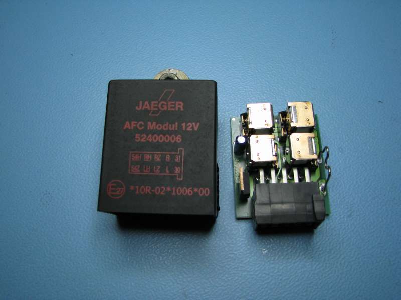

    Hi !
    Someone knows how to connect this module to power the trailer socket.
    I do not mean a direct connection, but through this relay, so as not to load the car installations, that's what it is for.
    I searched on the net but can't find the schematic.

    30 - + 12v (power)
    31 - mass
    L - left turn signal power supply (cable must be cut)
    LZ - departure to the nest at the hook (left hand)
    LH - exit to the lamp (this cable is cut)
    R - right turn signal power supply (cable must be cut)
    RZ - departure to the nest at the hook (right hand)
    RH - go to the lamp (this cable is cut)
    54H, 54Z - I don't know

    Hello, I bought a hook rack with LED lamps, and here there is a problem, the turn signals flash quickly, both at once, after pressing the right or left direction on the handle. Emergency blinks normally, the rest of the lights are also normal. In the trunk I have the Un-05 module / circuit breaker, I guess it is the cause of this confusion with these directions. Is it possible to remake this module to support these LED lamps? If so, what would I have to replace in order for it to work as it should. If not, is there any replacement for this module / circuit breaker that supports LED lamps with the same plug as my old Un-05 or something that I could adapt to my harness? Below I have attached photos of this module / circuit breaker

    i think you can skip the module - i did and all the hook harness problems are fixed. To omit it, you connect [RH-RZ-R] together and the same [LH-LZ-L]

    yarozz wrote:
    What about the cables marked (30) and (31)?
    These two wires are power, you don't do anything with them.
    You connect the rest as colleague Br0k3R wrote.
    The circuit breaker in your car will not even feel the load (LED), the directions will work as before.

    andrzej20001 wrote:
    Ok, but if there is a stick on the trailer / beam, it will not be so beautiful and cheap.
    Then you connect RZ and R together and through the 5A RH fuse, similarly the other side, LZ, L together and through the fuse you fasten the LH.

    marcin_wr wrote:
    So I disconnect the module from the ankle, connect the wires as Br0k3R wrote, and I can leave 30 and 31 in the ankle? Yes?

    So yes, I did as you suggested and my LED indicators in the bicycle rack on the towbar work without this module. The only thing left for me to do is no fog light on the car, but here I suspect the socket of the hook, when it gets warmer, I will look at it.
    And to think that it was possible to do it with such a simple method :) .
    In the workshop that assembled the hooks, they wanted to replace the module with a new one for over PLN 300, and in the electronics store, install the lamp resistors, which is completely pointless, because I did not buy a trunk with LED lamps to load them with several dozen watt resistors.
    The costs I incurred for this modification were the cost of buying 6 male clips for cables, i.e. PLN 1.80 :)
    Thanks again and I post pictures as if someone else had a similar problem to mine.
