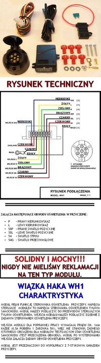

    Does anyone have a diagram of a universal hook module that can, for example, be bought on Allegro?
    Alternatively, please explain the principle of operation.
    Does such a module only power a given channel so as not to overload the car's system, or does it have other additional functions?
    Could it run on transistors that just open and feed the channel directly from the battery?
    I have a hook connected in the car according to the current standard and the trailer is a bit crazy. There are no such problems in a car with a module. I suppose that the connection scheme in the trailer is different, and the module in the other car may be able to adapt to a different scheme. Is it possible?

    Rate: 4433
    qqrqnapatyq wrote:
    In the car, I have a hook connected according to the current standard and the trailer is a bit crazy. There are no such problems in a car with a module
    Either the car requires a module or your connection is just wrong. No module "adapts" to the scheme of the trailer, it's total rubbish. What kind of car that you are in such trouble?

    Will this module layout be correct?
    Relays
    songle-srd-12vdc-12v-10a-250vac-transmitter
    Diagram
    Diagram of the hook module - You need the wiring diagram of the hook module. [/ img]
  • #26 16307125
    grala1
    VAG group specialist
    Posts: 9823
    Help: 1495
    Rate: 5052
    It will work.

    On each relay coil you need to give a rectifier diode. Otherwise something in the car will go with the smoke. Diagram of the hook module - You need the wiring diagram of the hook module.
  • #28 16307941
    qqrqnapatyq
    Posts: 107
    Rate: 18
    kryst thank you very much, I already know why the relay failed in the simulation ;)

    Rate: 5052
    The failure of the relay has nothing to do with the lack of a diode.
    This protection is only to protect the electronics in the car and not to protect the relay.
  • #30 16308703
    qqrqnapatyq
    Posts: 107
    Rate: 18
    So why does the relay blow up? As I added the diodes, it does not blow up now.
