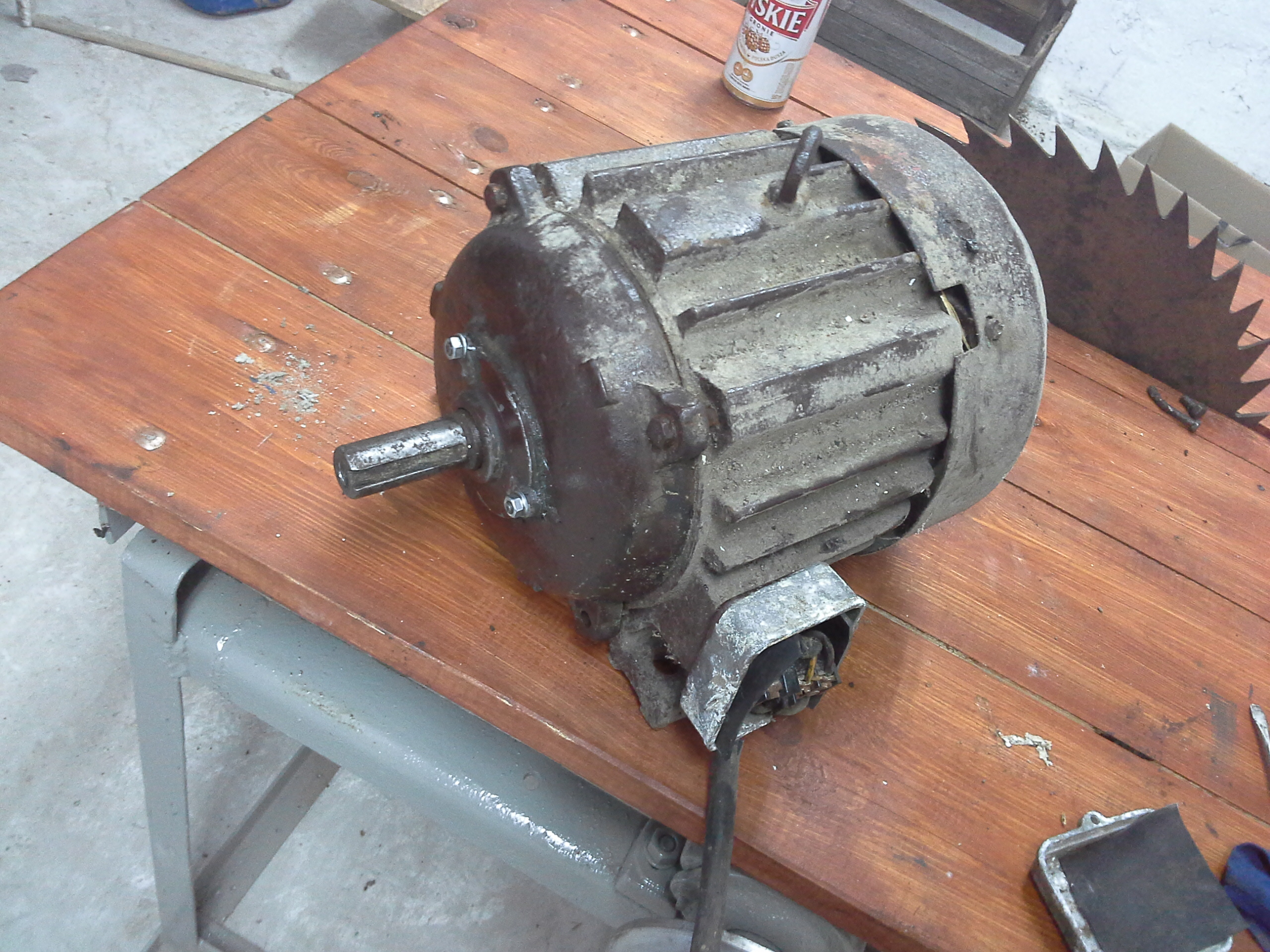

    As in the subject, I do not know how to check the engine power because I do not have a nameplate, is there any way to check it? I need this knowledge in order to buy a capacitor so that this motor can be connected to one phase. I am asking for a quick answer.

    The simplest measurement is I.
    You can take a ruler, measure a bit and compare the dimensions with the data of other engines from those years. Everything can be found on the net.

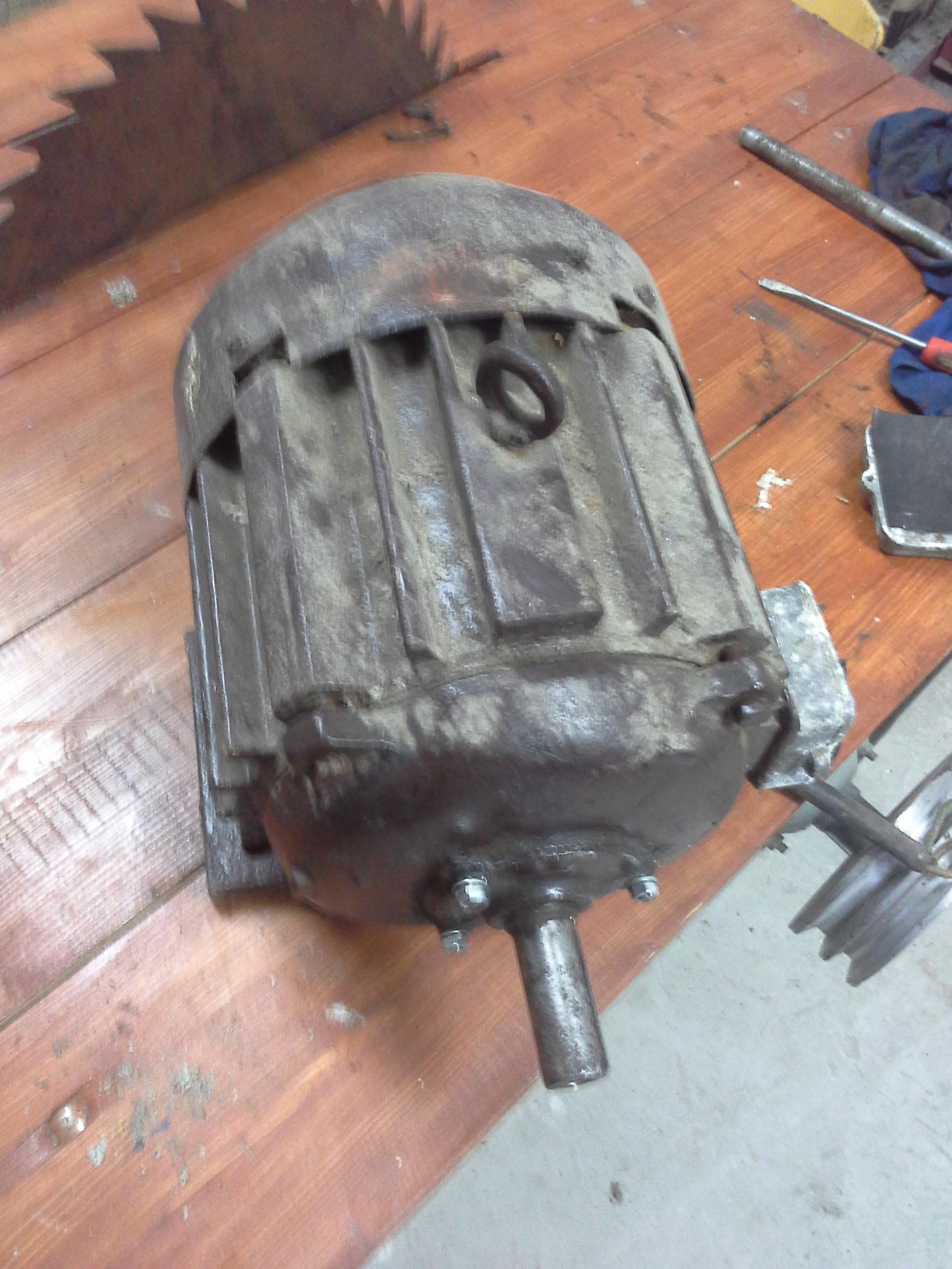

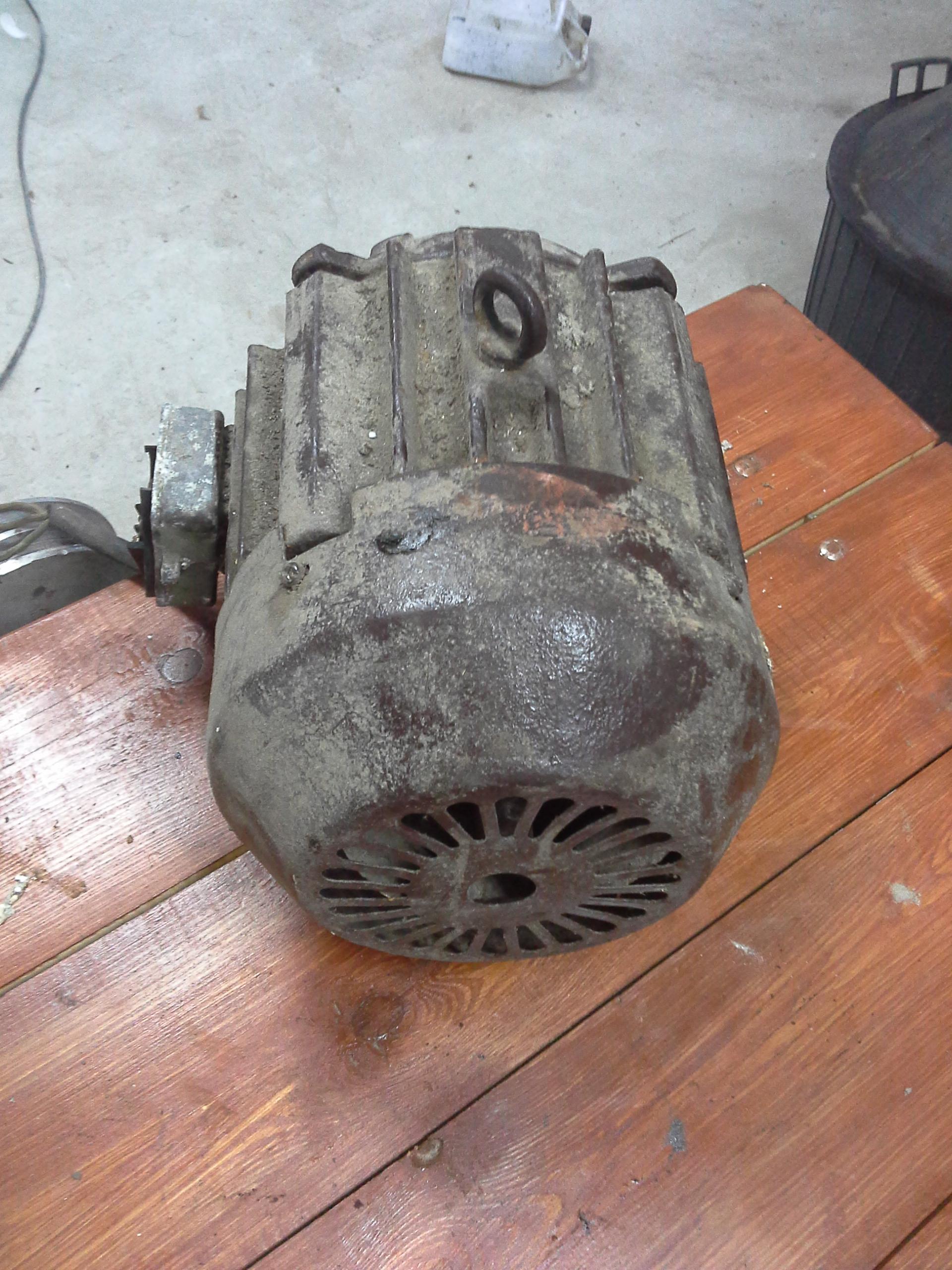

    The diameter of the struggle is 25 mm
    The engine brews over 40kg

    I will wait for the opinions of other people, now I was thinking about a capacitor of this capacity, if there is no way out, I will buy it in the dark and try it.

    It won't work for you, it's a 4kW 960 rpm engine.
    Nothing fits here. The diameter would have to be 24 or 28 mm and the weight probably too large.
    Measure the height to the center of the shaft, the spacing of the holes on the paws and exactly the weight and diameter of the shaft.

    This is not the case with 1.7kW or 2.8kW, I used to have such a block, it can be 25mm for a shaft because old engines had different dimensions, e.g. 4.5kW has a 35mm shaft

    I think it's 1.7 kW. I have such an engine.
    Yes, but you will measure it idle and it won't help you much. You would have to load it, measure current and temperature rise, but the easiest way will be by dimensions.
