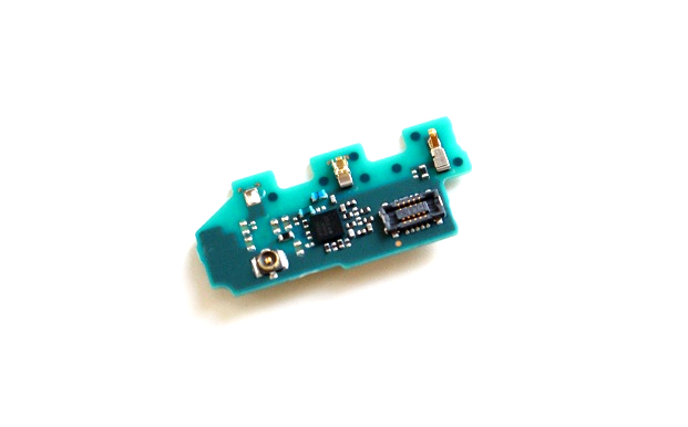

    The problem is the subject.
    Wifi and bt in Xperia Z3 do not work. Everything else works. The restoration to its factory condition did nothing.
    Wifi - switches the slider, but turns it off immediately, and does not search for any network.
    BT - the slider returns to off after a second.
    What can you do about it? What to replace
    Please help.

    I suggest using the Xperia program "Xperia Companion" after connecting Z3 on the program screen icon SOFTWARE REPAIR or UPDATE repair gives-restores driver data Such pads are often after updating the software via Wi-Fi should help.

    Unfortunately, this action had no effect.
    Anyone can still help?

    Go to the gsm service or take advantage of the warranty if it is possible.

    Software repair in xperia companion consists in uploading new firmware to the phone.
    If after these steps there are still problems, as I wrote earlier, go to the website.

    Buddy, but I am asking for advice on what can be exchanged, not whether I have to go to the website. I can open the phone myself and exchange what I need. I just need a tip where to look. I know there are plates and antennas responsible for bt and wifi. I exchanged what in the picture. It also did nothing. Any other specific suggestions?

    The motherboard of the phone remains and you need to look for the reason on it. Look for a schematic for this model.

    About half a year ago, the disc was supposedly replaced with a new one, because the phone had flooded (supposedly waterproof) ;) ). I will try to replace this antenna, which is next to the jack
    And back to resetting .... Is the repair by Xperia Companion the same as hard reset? Because different voices walk around the ether

    Repair with xperia companion gives as if the software overlay does not change neither the recovery mode nor the rom of these software is a fixed part as if the Windows installation. Bare software with device drivers and phone apps, the rest of the android is updated later alone. Returning to the antenna, it won't do much because it's just a strip of foil stuck with copper in the form of a metal plate. So rather if these previous activities did not give results then nothing remains but a service.
