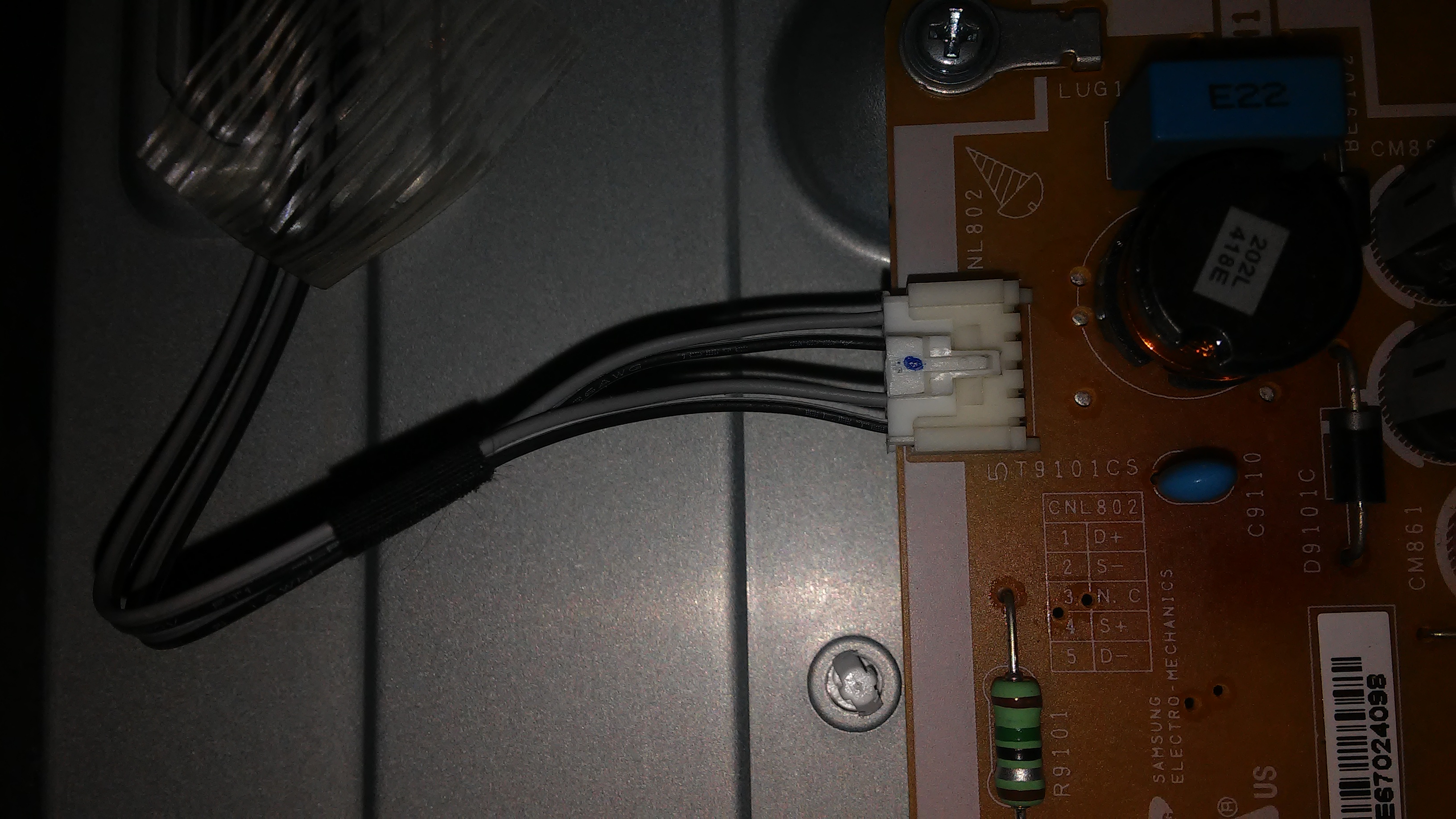

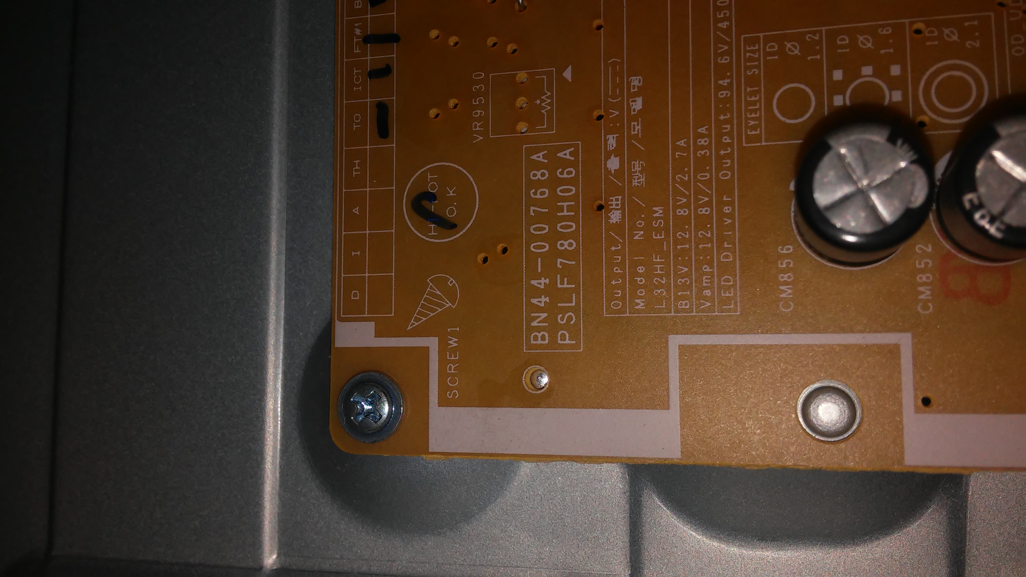

    The power supply has the voltage for the backlight. And as in one of his posts a colleague mirex (very good workmanship) wrote: how many 3V diodes do you need to connect in series to have such voltage? You see how many LEDs you have, multiply them by 3 and what came out?
  • #7 16534000
    lukaszkot89
    Posts: 55
    Rate: 9
    24 LEDs x 3 V = 72 V
    The drive has an output Led driver 94.6 V 450mA

    They are also used in backlight for other voltages, although sporadically. ;) For example, in the TPT390J1-HJ1L02 matrix with CLO_T39 backlight PHP LD REV.02 it is about 10V. ;)
    What about the 94/72V voltage allowance? ;)

    In that case, what LEDs can they be?
    94 dividing into 24 we get about 3.946 V. Are such diodes produced somewhere?

    You need to get used to your friend's posts mirex , which forces them to logically analyze (and very well) and not just to mindlessly follow directions.
    Look for 3V LEDs ... And if you are tired, why do you find pdf of these LEDs and check.

    On the plate it looks like a plug with two led strips, the second photo is a print with a description of the power supply.
